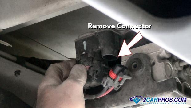

1. Release the electrical connectors from the unit by pushing the safety clips using a small screwdriver. The weather packing seal can make it a little difficult to remove the connectors, wiggle them gently as they are removed from the module.

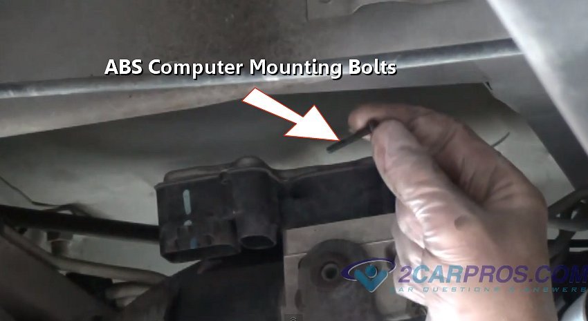

2. There will probably be four or more Torx head (size 20), 8mm or 10mm bolts to remove the controller from the pump motor. These bolts can be little tough to get to if the module is under the vehicle like this one. In this case use a 1/4 inch drive ratchet because its smaller and easier to maneuver. This operation is much easier when the controller is under the hood.

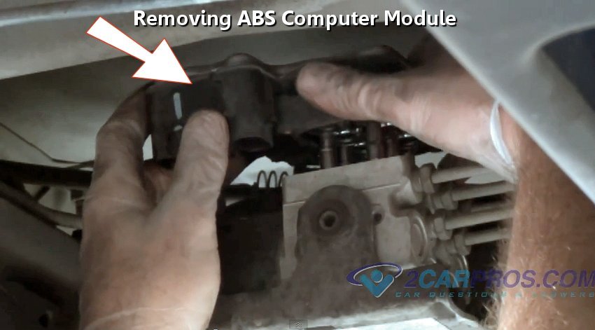

3. Make sure the ABS controller is clean and dry. Gently remove the unit by lifting it straight up from the valve assembly, it might be a little stuck because of the weather seal used to keep moisture out. Use a small screwdriver to gently pry up and loosen the seal to separate the two.
abs computer module removal

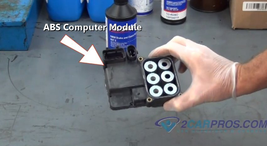

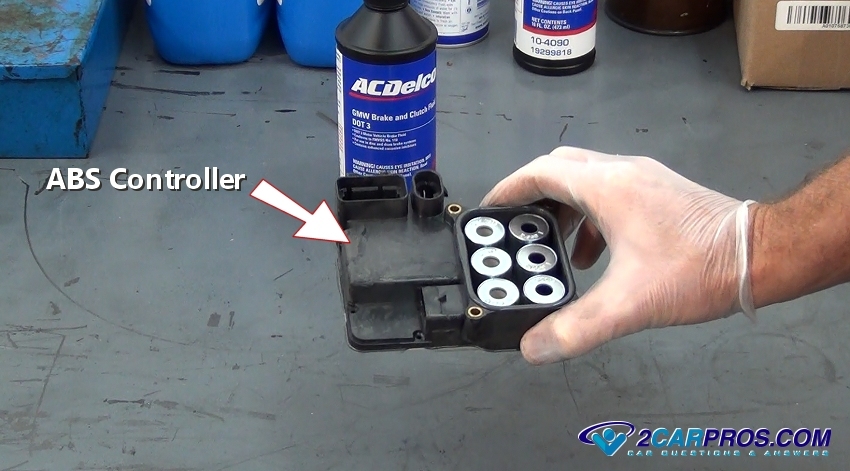

4. Match the old part to the new replacement unit, they should match identically. Be sure to count the number of electrical pins in each connector because there are minor variations according to what options your car has such as traction control.

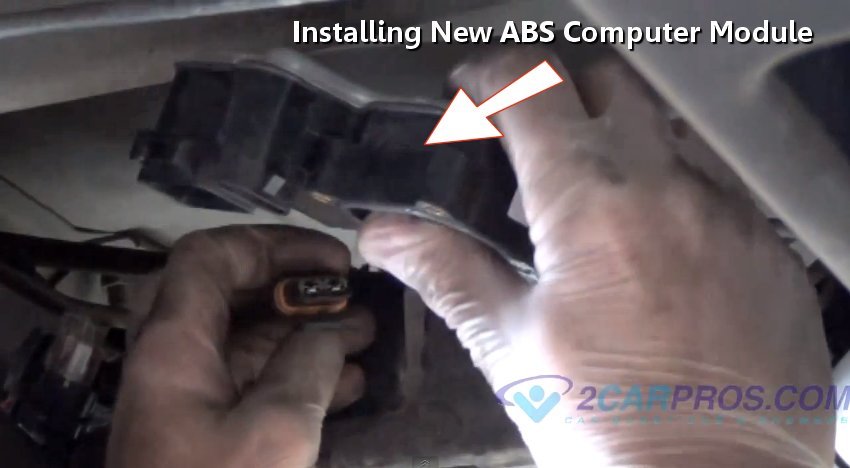

5. Be sure the pump motor is clean and free from dirt before installing the new module. Install the new unit and ensure it sits flush and seals completely onto the valve assembly. This can take some extra effort because the valve cores need to fit into the new module.

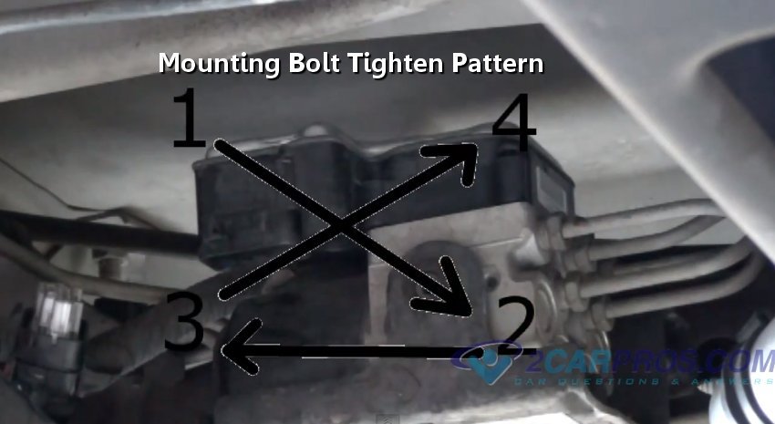

6. After the unit is securely in place, reinstall the mounting bolts and tighten in an "X" pattern to mount the unit squarely onto the pump and valve, this will ensure the proper operation.

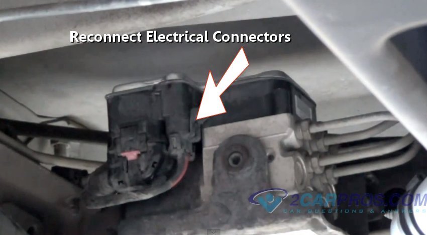

7. Once all the mounting bolts are tight, make sure the connectors are clean from dirt and grime, reconnect the electrical connectors onto the valve assembly. Reconnect the negative battery cable and start the car. The ABS and Traction Control warning lights should go off shortly after the engine is running or after you have driven the car for a short time and you are all set.
reconnect abs computer
