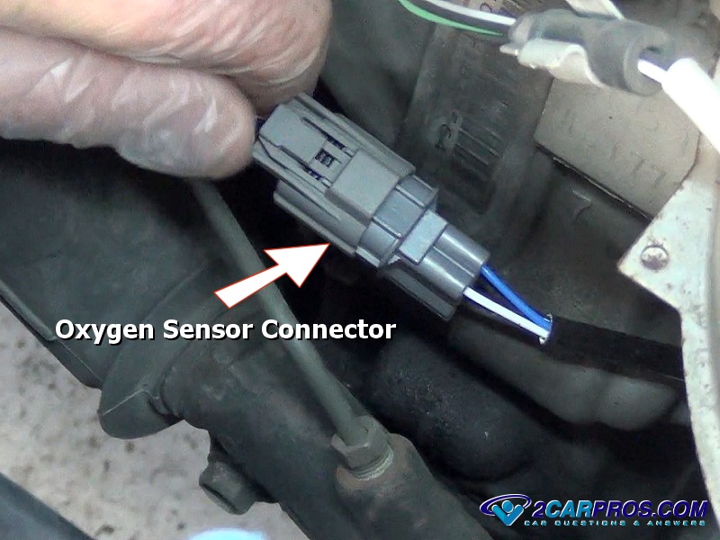

1. To start, buy a box of fuses that match the engine fuse in amp rating such as 15 or 20 amps in a blade style fuse which will cost about $9.00 (US) at Amazon or the auto parts store. Then unplug all oxygen sensors, now replace the fuse and turn the key on. Have a helper watch the fuse as you plug in the oxygen sensor connectors in one at a time until the fuse blows, this will be the sensor that is shorted and needs to be replaced.

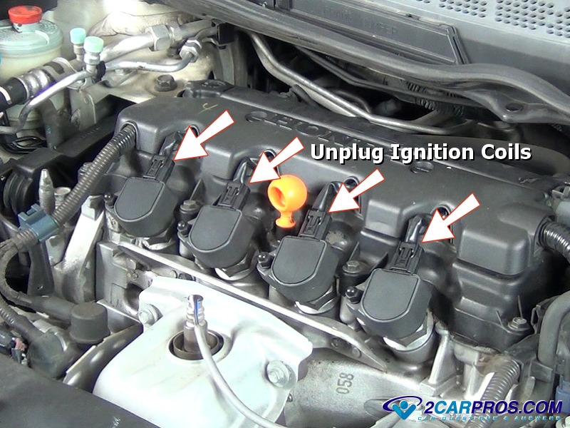

2. If none of these blows the fuse, unplug the ignition coils and try the experiment again by plugging the coils one at a time while the fuse is observed.
unplug ignition coils
