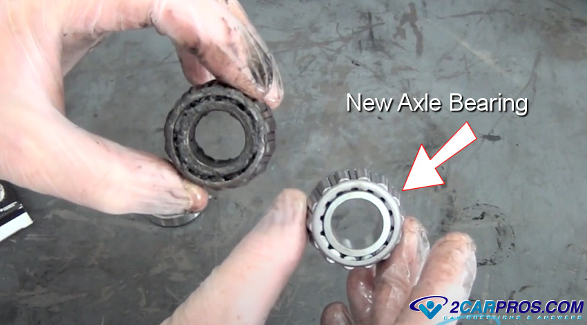

Primarily this job will need to be performance on the front end while doing a brake job that includes changing out the brake rotor. New brake rotors will included new bearing races but not the bearings themselves.
Pro Tip: Buy replacement bearing when replacing the brake rotors.

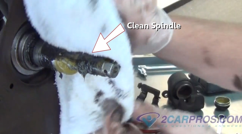

1. Use a shop towel and clean the spindle, once clean inspect the spindle for wear and damage. This doesn't happen very often but when it does the spindle will need to be replaced.
clean spindle

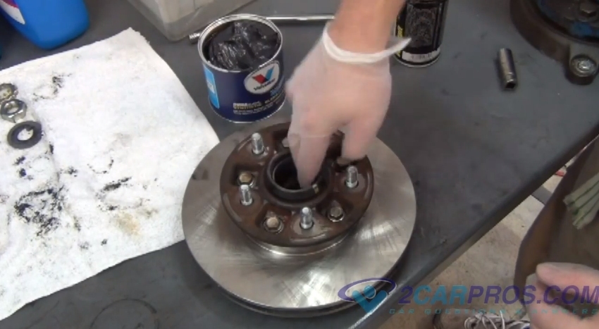

2. Use a shop towel and remove the grease from inside the bearing hub, (rotor removed).
clean bearing grease from hub

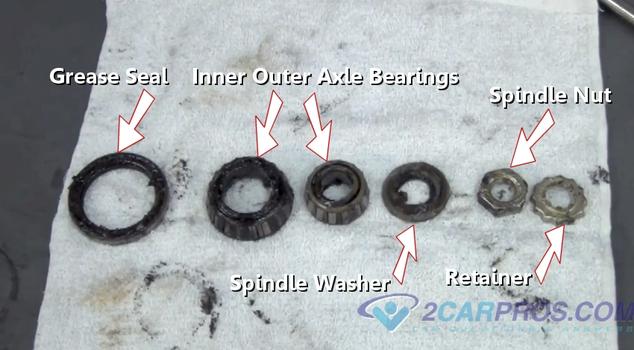

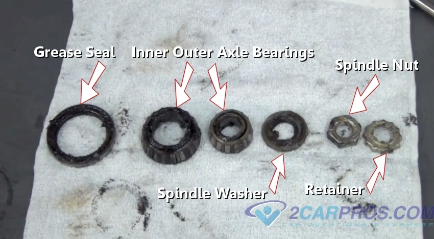

3. Next, layout the inner and outer wheel bearings, grease seals, spindle retainer and washer for cleaning.
axle bearings seal washer

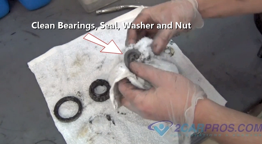

4. Clean each part using a shop towel expect for new bearings. The old grease inside the inner and outer bearings will be forced out in the next step.
clean axle bearings

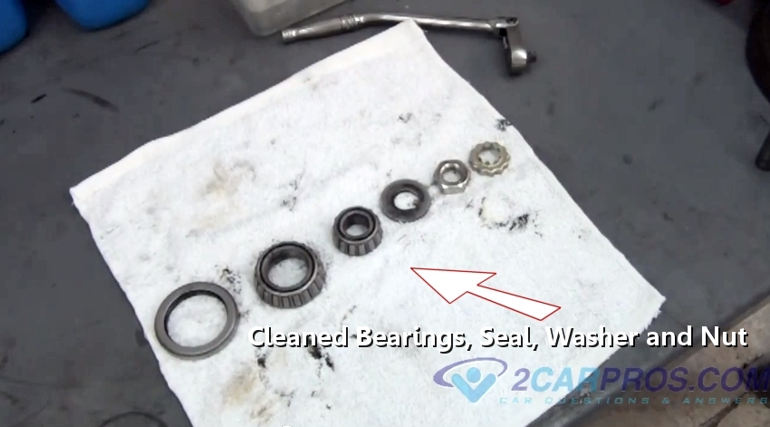

5. Re-align the cleaned components to be installed in the order ready for reassembly.

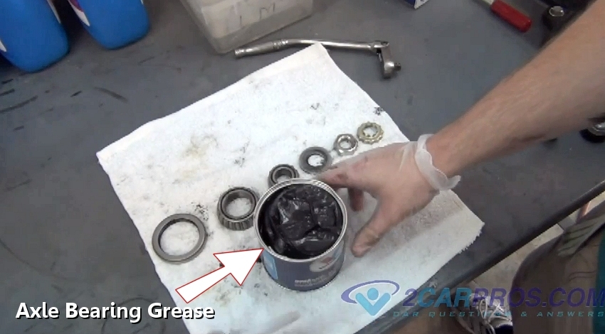

6. There are several kinds of grease, you want to use a high quality grease that will protect you're bearings for miles to come.
axle bearing grease

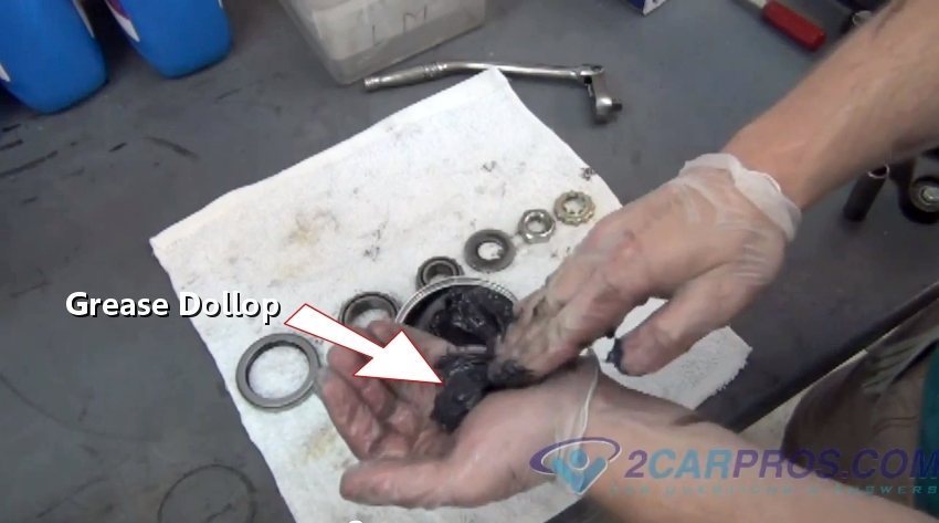

7. Scoop a hardy amount of grease out of the container and transfer it to the palm of the opposite hand, this is where gloves come in handy.
dollop of grease

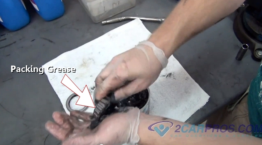

8. While grasping each bearing with the cone side up, thrust the grease into the bearing while forcing the old grease out, turn the bearing until all sides are done. Continue this action until both bearings are complete, this is called packing the bearings. Repair shops have a pump machine that performs this service.

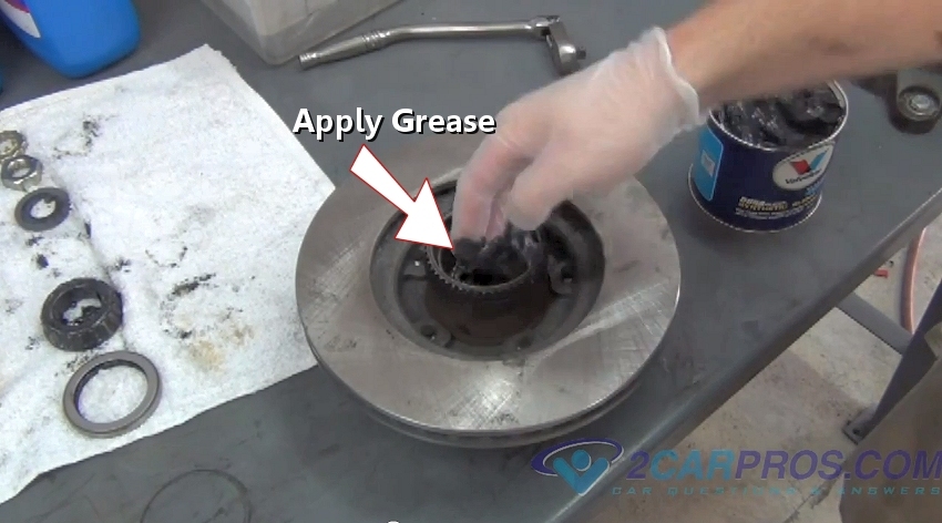

9. With an additional grease dollop, coat inner and outer bearing races (rotor installed).
apply grease

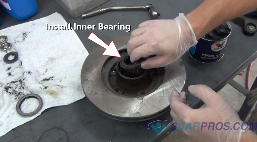

10. Once the new grease has been applied, reinstall the inner bearing (cone down).
reinstall inner bearing

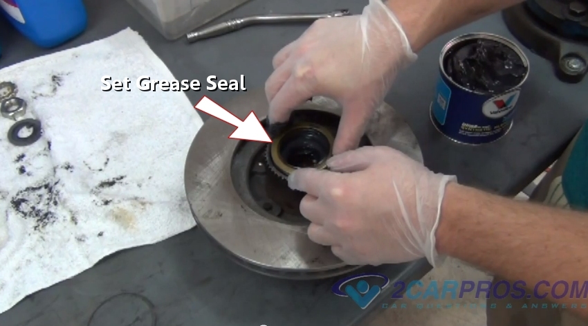

11. After the bearing has been installed set the grease seal into place, install the seal with the lip facing inward.
install grease seal

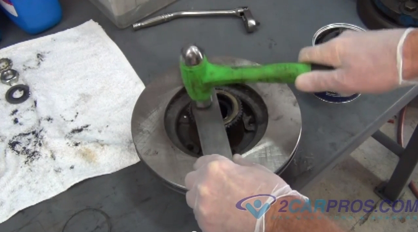

12. Using flat bar stock or a seal installation tool, hammer the seal into the bearing hub, continue until flush.
grease seal installation

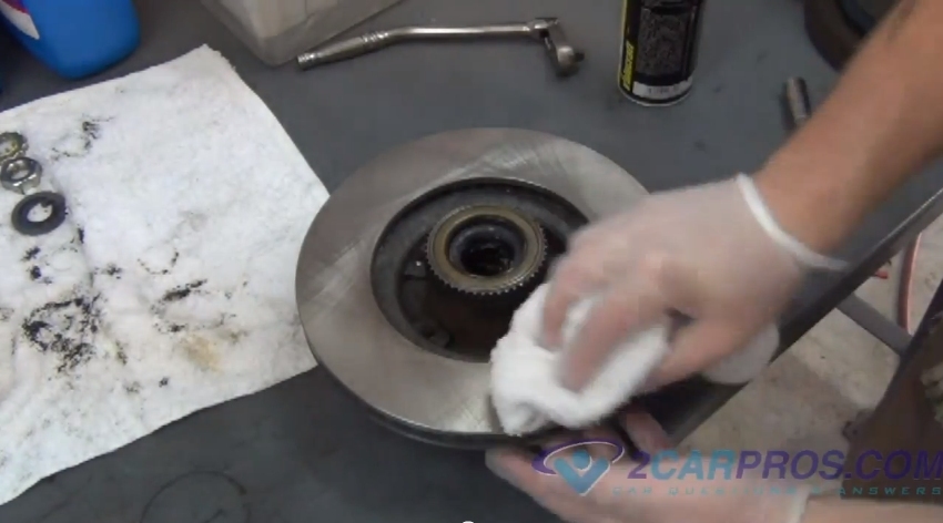

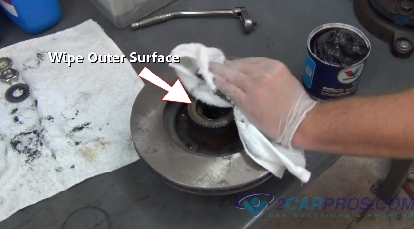

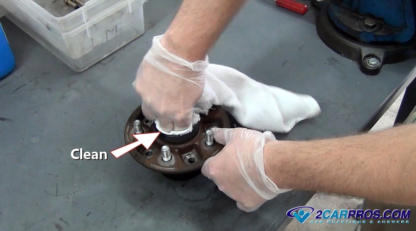

13. With a clean shop towel, wipe the outside surface of the bearing hub.
wipe outer surface
14. Using carburetor or brake cleaner and a shop towel clean the rotor braking surface. Do not allow any brake or carburetor cleaner to contact the new grease inside the hub.
cleaning rotor

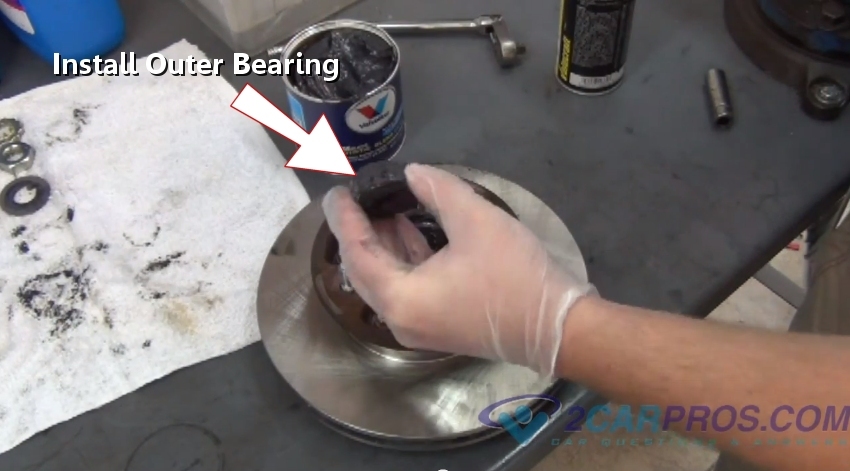

16. Install the outer wheel bearing (cone down) and seal with a layer of grease.

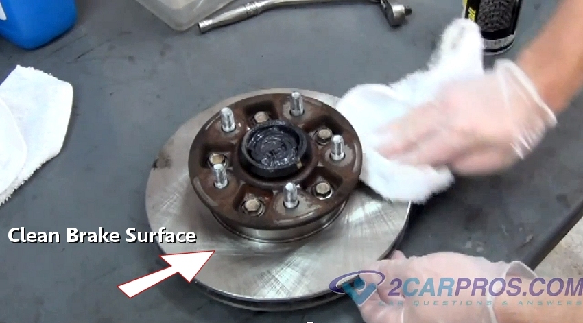

17. Once the outer bearing has been installed, use a clean shop towel and cleaner to remove any grease or dirt from the rotor surface. Please visit how to replace wheel bearings to see how the preload is set.
clean brake surface
