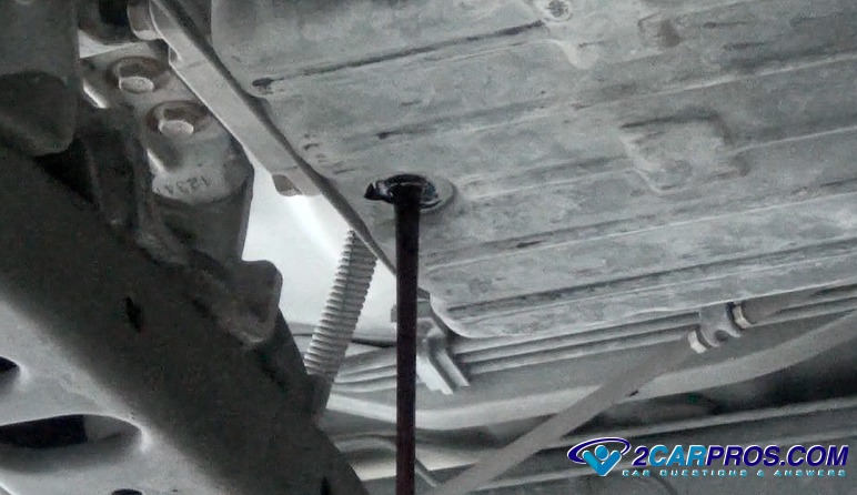

Start by removing the transmission drain plug to help drain the fluid from the unit, have the fluid catch basin ready. If a drain plug is not featured, loosen the transmission pan and allow the fluid to drain, once complete retighten the pan.
transmission fluid drain

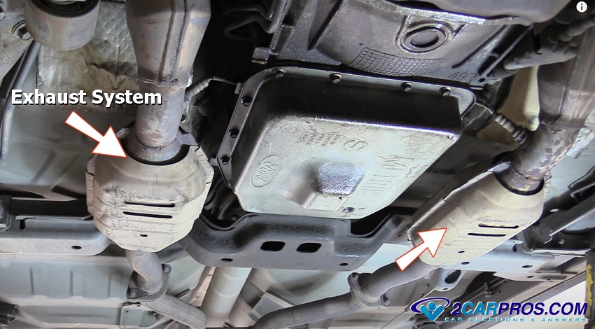

Spray the exhaust mounting bolts with WD40 or equivalent to aid in the removal of the exhaust system. This will add clearance helping to make the job easier and more accessible. Start by removing the oxygen sensors or wiring connectors, once the system is removed set the system off to the side.
remove exhaust system

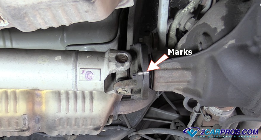

Use a marker or piece of chalk to scribe a line to help keep the orientation of the driveshaft in relation to the differential. This helps keep the driveline balanced which avoids vibrations while the vehicle is operating. Remove the bolts from the driveshaft and gently side it out of the transmission tail shaft.

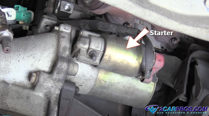

Remove the starter motor, this is why the battery needs to be disconnected to avoid electrical sparks. There will be an upper and lower mounting bolt or nut, also use care when removing the battery cable and trigger wires to not crack the solenoid. Carefully remove the starter and set it to the side.
remove starter motor

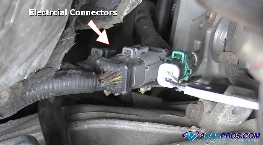

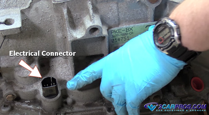

There will be an electrical connector which controls the transmission and various sensors which will need to be disconnected. These connectors can be mounted on the transmission or slightly away somewhere in the wiring harness.
remove electrcial connector

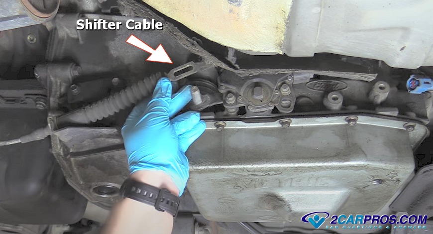

On the drivers side there will be a shifter cable which comes from the inside of the car that controls which gear you are in. Remove the mounting clips or bolts to disconnect the cable (electrically shifted vehicles do not have this feature).

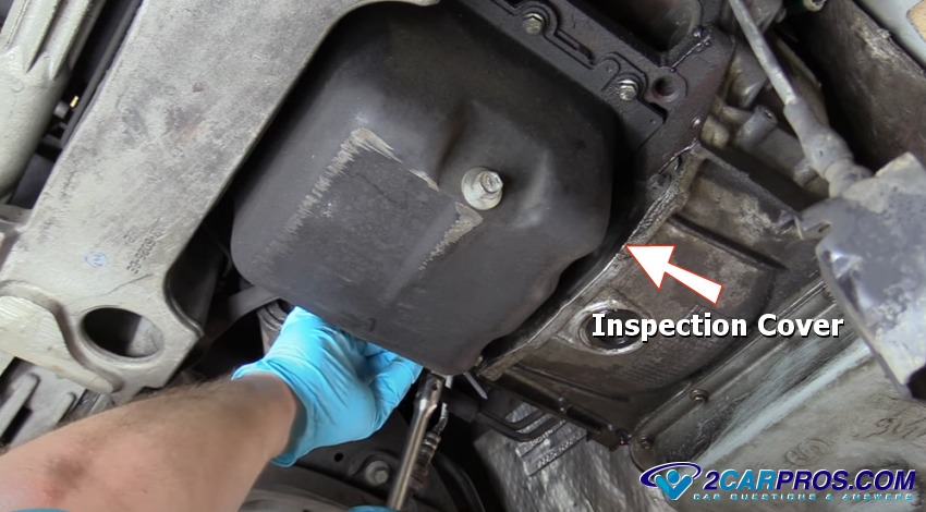

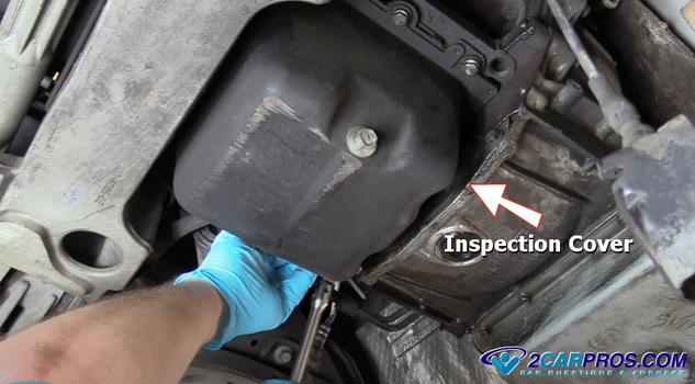

There is an inspection cover which is used to access the torque converter mounting bolts or nuts that needs to be removed. Some transmission will have a torque converter cover which serves the same purpose.
inspection cover

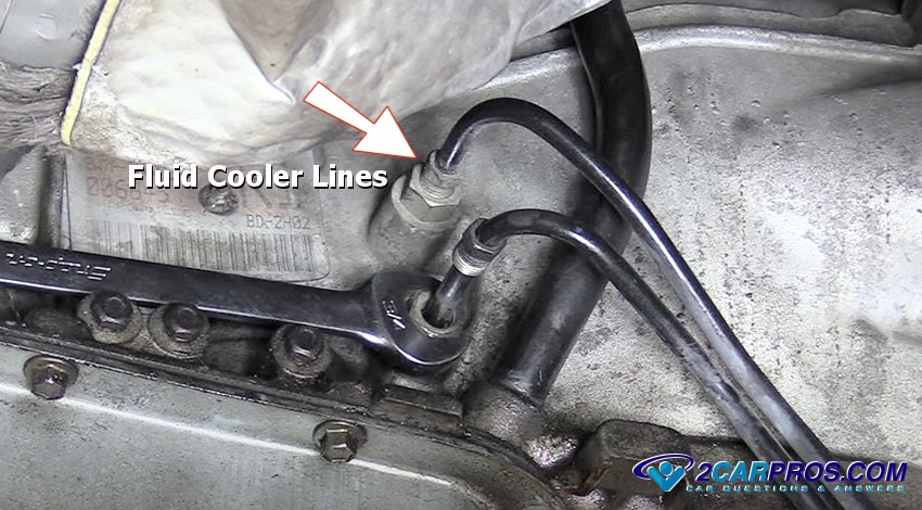

Fluid cooler lines run from the transmission to the radiator. Use a line wrench (not shown) and back up the line fittings with a normal wrench (shown), remove both lines, a small amount of fluid may drip out.
remove transmission cooler lines

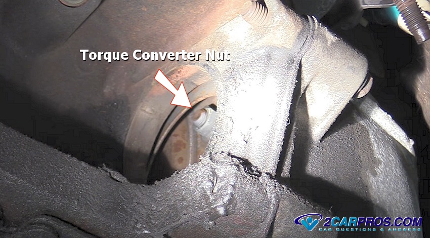

The transmission torque converter is attached to the flex plate of the engine. This is achieved by nuts or bolts, first remove the access port (if equipped). If you don't see the nuts or bolts, a breaker bar can be used at the front of the engine (balancer bolt) to rotate the engine (clockwise only) until you can see the fasters, there will be three or four, continue until all are removed.

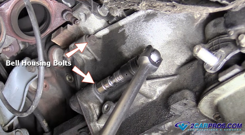

Bell housing bolts are used to hold the transmission to the engine, there will be two on the left side, two on the right side and two on the top (most cases). These must be removed or loosened in stages, loosen the bottom bolts one on each side, then remove the remaining bolts on each side. The top bolts we will address further down this guide.
remove bell housing bolts

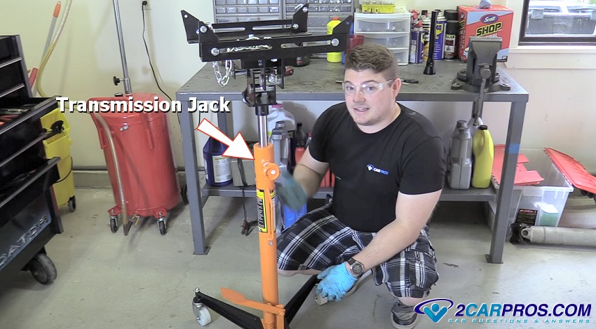

A transmission jack will need to be used at this point of which there are two types. The one featured in this guide is the type that is used with a car lift, most likely the one you will be using is a floor model which is much shorter.
transmission jack

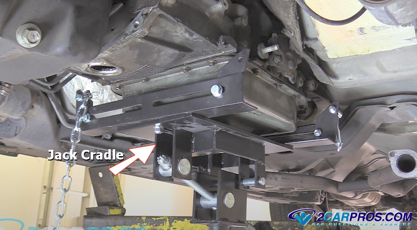

Position the jack cradle under the pan and secure it using a chain or strap which will keep the transmission from wandering around on the jack while maneuvering it during removal. Raise the transmission slightly to take the weight off on the crossmember.
transmission jack cradle

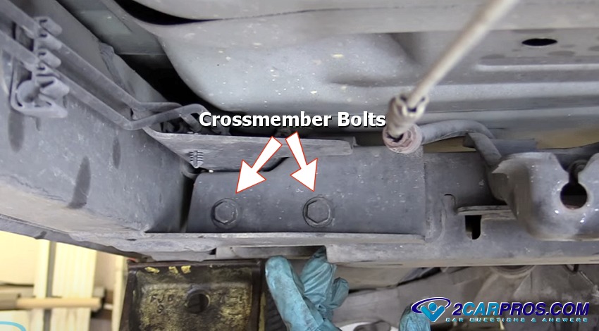

The rear of the transmission is mounted to the vehicle by the transmission cross member and transmission mount. Remove the mounting bolts both at the frame and at the transmission mount and remove the crossmember.
crossmember bolts

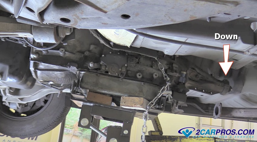

Now, we can lower the rear of the transmission which will help us gain access to the top two transmission bell housing bolts.
transmission down

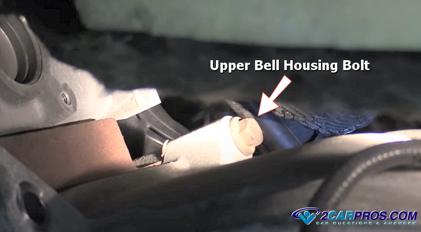

Here is one of the two bolts, use a long 1/2 inch extension and a universal impact socket, loosen and remove the bolt, repeat this procedure for the opposing top bolt as well.

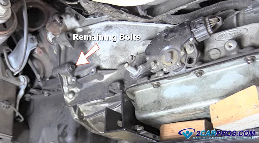

These are the last remaining bolts before the transmission will come out from the vehicle, one on each side, remove the bolts and wiggle the rear of the transmission, it should break loose from the engine and be freestanding on the transmissions jack. You may need to use a large pry bar between the engine and transmission and if that doesn't work recheck making sure all bell housing bolts have been removed. The transmission will need to be slid back slightly before it detaches from the engine.
remianing bellhouing bolts

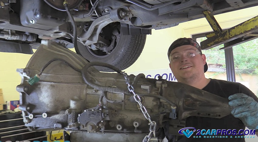

Now, gently lower the transmission while looking for any wiring or cables that you might have missed. Also, hold the torque converter in place so it doesn’t fall forward and out of the transmission.
transmission removed

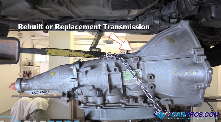

If you are rebuilding or having the transmission rebuilt there is no worries when reinstalling the unit, but if you have a replacement transmission make sure they are the same by checking the driveshaft spline, torque converter mounting studs or bolts and the electrical connectors.
transmission electrical connector
Reinstall the new or rebuilt transmission onto the transmission jack using the safety hold downs.

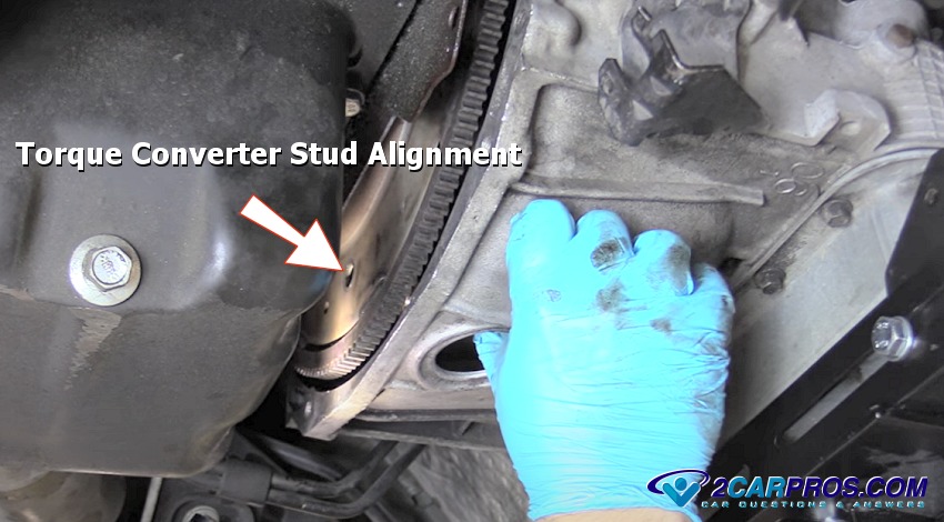

If your torque converter is designed with studs you must line them up with the holes in the flex plate before you start installing the bell housing bolts or you will damage the transmission.

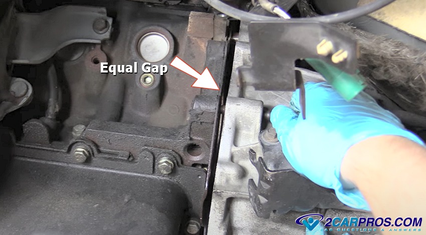

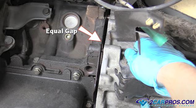

A main point when reinstalling the transmission is the alignment from the engine to the transmission, when correct it makes the installation much easier. This is done by eyeballing the gap between the engine and transmission, also make sure any loose wiring does not get caught between the two.
transmission equal gap
