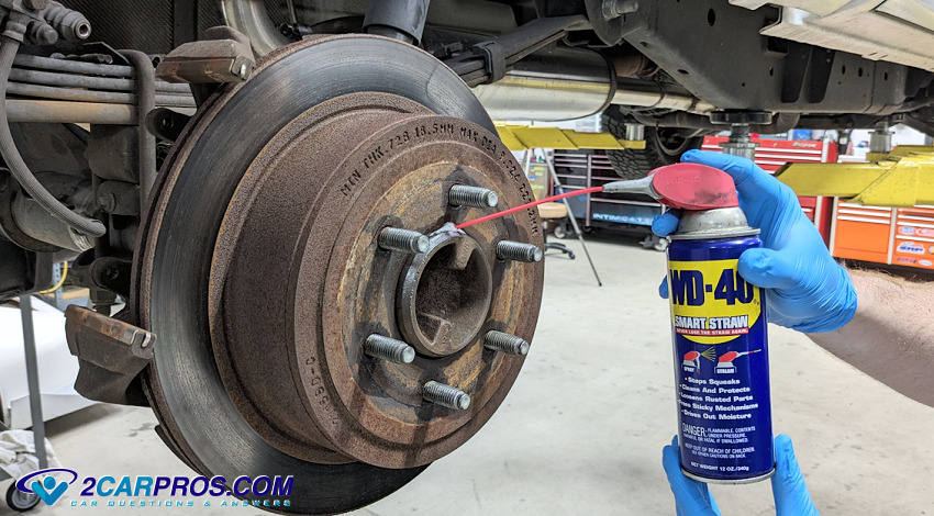

4. Apply penetrating oil such as WD40 in and around the wheel stud holes and the bearing hub center and allow to sit for a few hours or overnight which is best.

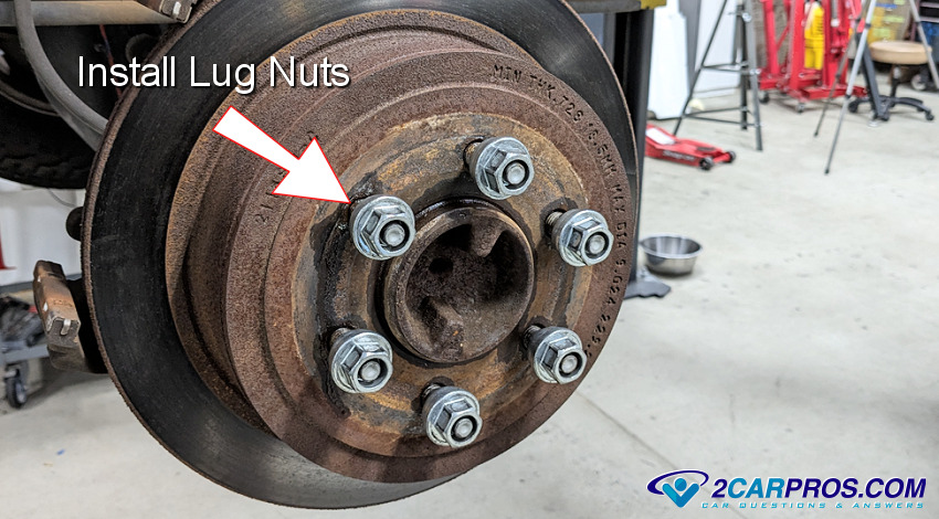

5. Reinstall the lug nuts to protect the wheel stud threads from getting damage while using a hammer to strike the rotor.

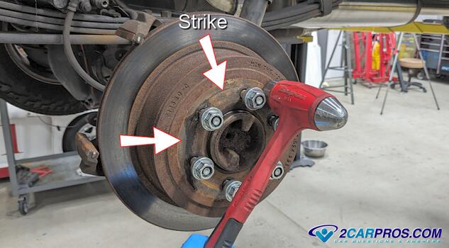

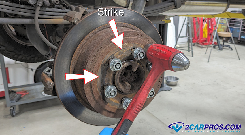

6. While wearing protective eyewear and gloves, use a large hammer to "shock" the rotor from the flange or bearing hub. Only strike the rotor between the wheel studs and around the axle center flange, do not strike the rotor in other areas because it is brittle and it can crack or chip.

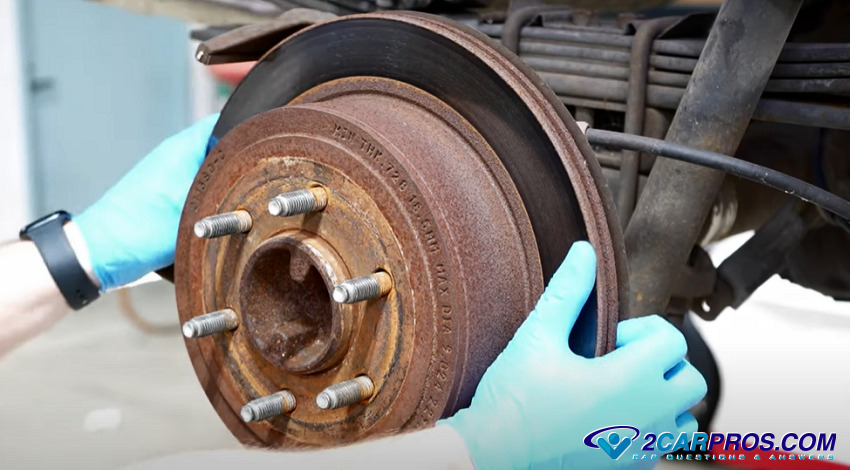

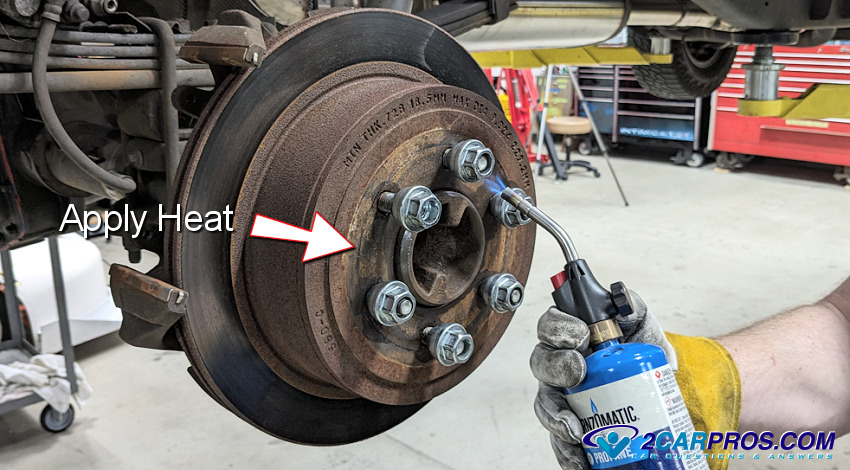

7.  If the rotor is still stuck even after many strikes with a hammer heat is your best friend. This works very well because it can expand the rotor mating surface while dissolving rust. While wearing gloves and welding goggles light the butane torch and begin to apply heat around the center and wheel stud holes of the brake rotor, avoid over heating. Avoid heating the outer part of the rotor and the center of the bearing hub or axle flange. Once hot, use a hammer much like you id in the step above, this will break the rotor free. Use gloves to handle the rotor to protect yourself from the hot metal and allow to cool.

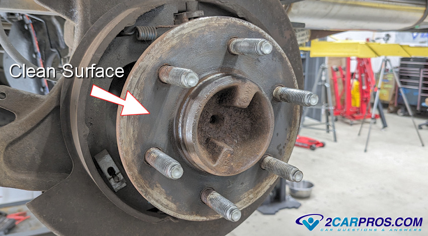

Once all surrounding parts have cooled, use sand paper or a wire brush to clean up any rust remaining on the rotor mounting flange. Avoid using oil or grease to help prevent the rust because when it heats up it can contaminate the brake pads as the wheel spins. Do not use paint or primer as well because it can disrupt the rotor run out and can cause the brakes to pulsate when applied.
