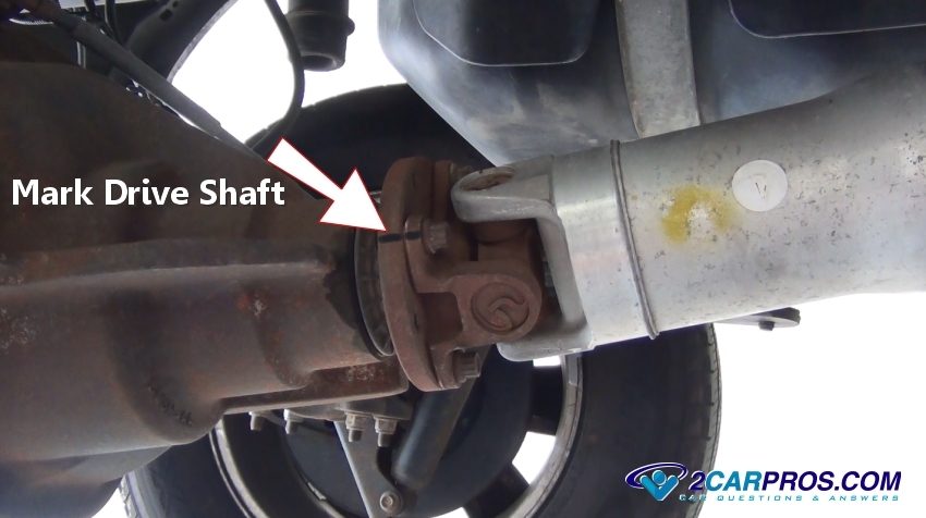

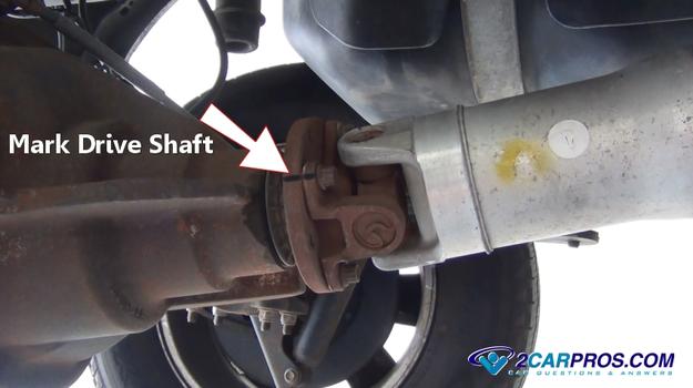

1. Mark the Driveshaft
Mark the driveshaft orientation before beginning. This will help return the driveshaft to its original position on the differential which can help avoid driveline vibrations once the driveshaft is reinstalled.
mark drive shaft

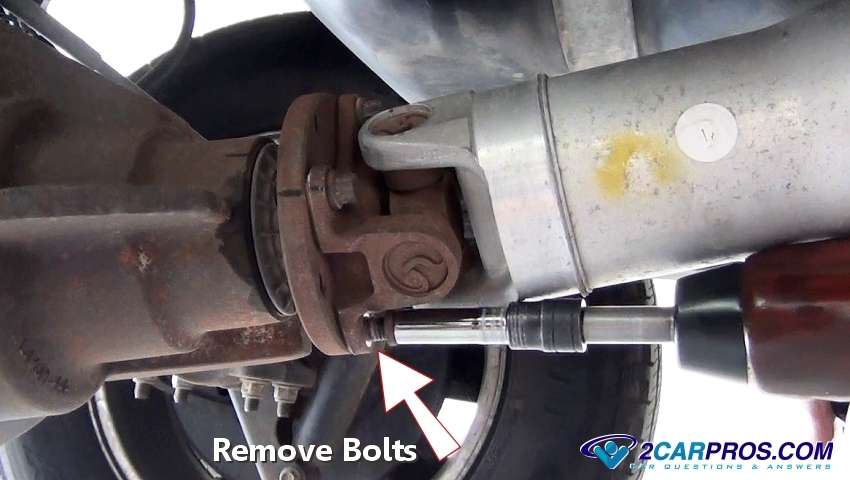

2. Remove Driveshaft Bolts
Remove the shaft differential flange mounting bolts. These bolts will be very tight so use good quality tools to avoid stripping. Some bolts can head 12 point heads as in this example which used a 13mm 12 point socket to remove. These bolts also use lock tight to avoid coming loose while in operation and can be reapplied when reinstalling.
remove drive shaft bolts

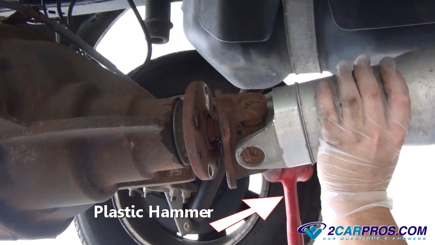

3. Remove Driveshaft Flange
Using a plastic hammer gently shock the driveshaft loose from the differential flange by striking the rear yoke (U joint mount). At this point the back half of the shaft will be free so hang onto it. On some cars there will be a center support which must be undone by removing the two center support mounting bolts. When removing an older vehicle drive shaft use electrical tape to wrap around the u joint cups so they don't fall off and release the cup needle bearings.

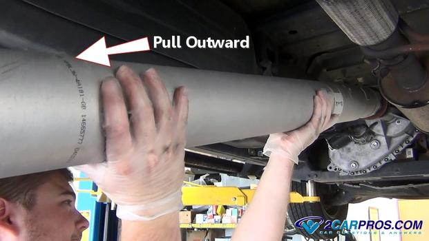

4. Remove Driveshaft
Using both hands gently slide the driveshaft from the transmission or transfer case. A small amount of fluid might leak out so have a fluid catch basin ready. This would be a good time to replace leaking transmission tail housing seal, universal joints or if removing the transmission or differential repairs are needed.
pull drive shaft outward

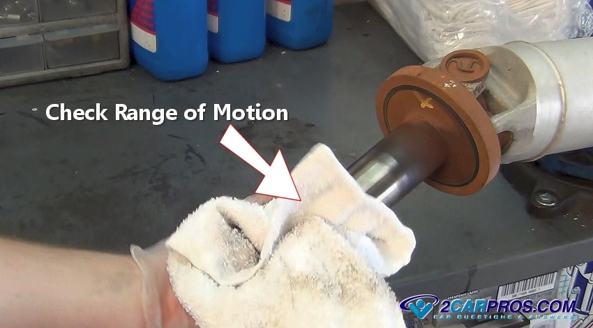

5. Check U joints
At this point the U joint at either end of the shaft should be checked. Grasp the yoke and move it in all directions. It should be a smooth motion with no rough spots or play in any direction. If play or rough spots occur then the U joint needs to be replaced.

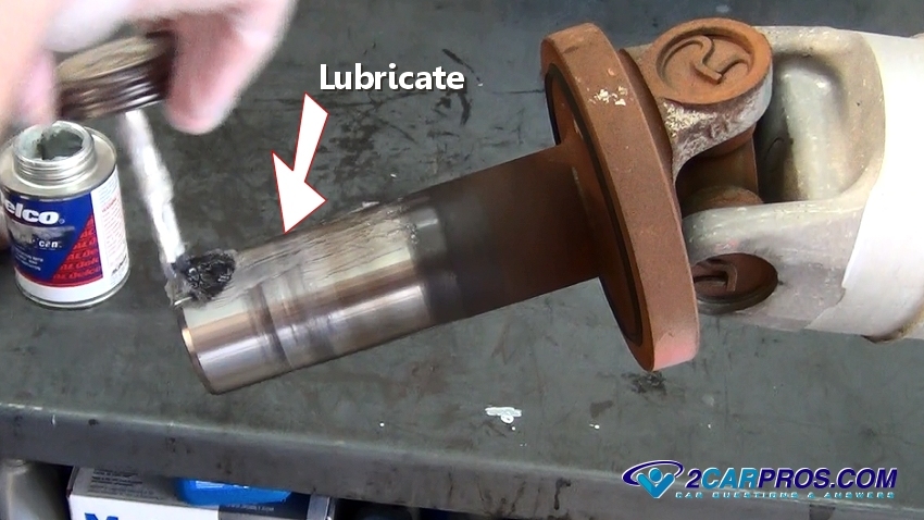

6. Reinstall Driveshaft
Before re-installing the driveshaft apply a small amount of grease to the yoke. This will help lubricate the output shaft seal in the transmission or transfer case.
lubricate drive shaft yoke

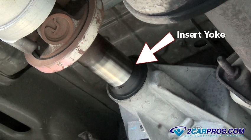

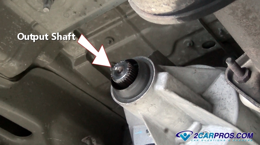

There is a dust boot along with the rear seal which is incorporated within the transmission or transfer case tail housing seal. This transmission or transfer case output shaft is where the driveshaft connects.
Care must be taken when reinserting the driveshaft yoke as not to damage the seal. Gently guide the yoke into place over and onto the output shaft.
insert drive shaft yoke

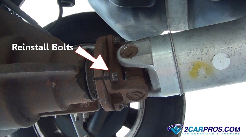

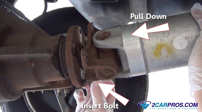

7. Reinstall Flange Bolts
Once the front yoke is installed pull the driveshaft back into place while inserting a mounting bolts by hand to avoid cross threading.
installing drive shaft differential
Finish installing the mounting bolts while making sure the alignment marks are together.
installing drive shaft bolts

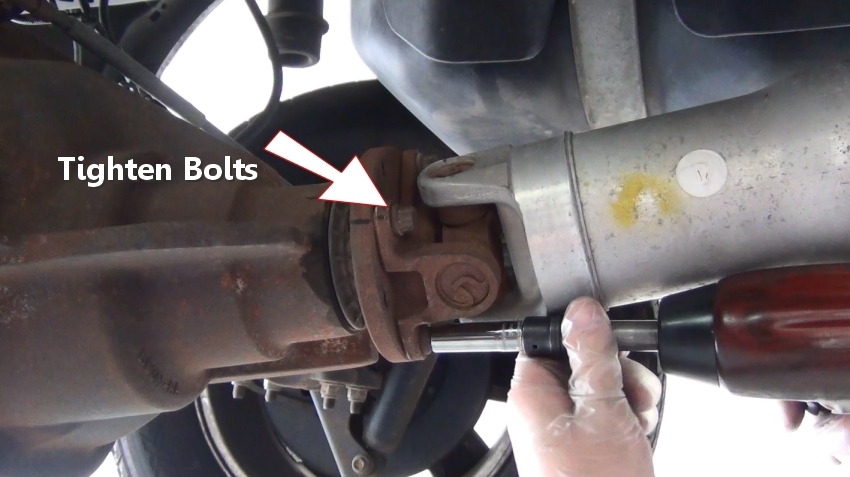

Tighten the bolts evenly and in a cross pattern to factory specs which is usually 55-65 foot pounds of torque. If any fluid was lost during the job check and refill the transmission or transfer case after the shaft has been reinstalled and you are all set.
tighten drive shaft bolts
