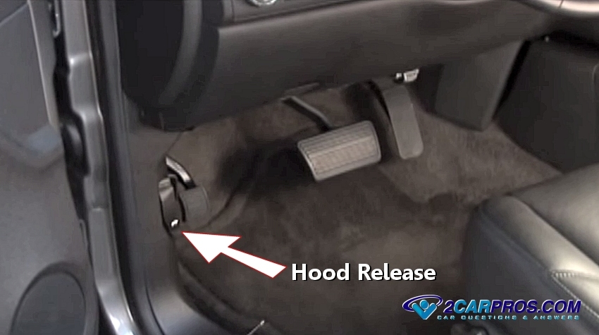

Step 1 - Locate the hood release which is usually near the drivers side kick panel, some additional locations include just under the dash on the left side as well.
hood release

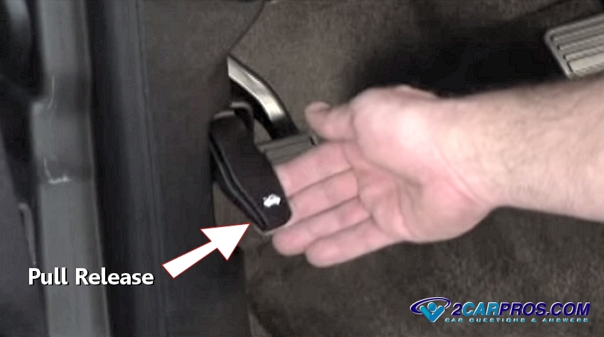

Step 2 - Grasp the release and firmly pull outward to activate the hood latch, a release cable is used to connect the lever to the actual latch release mechanism.
pull release

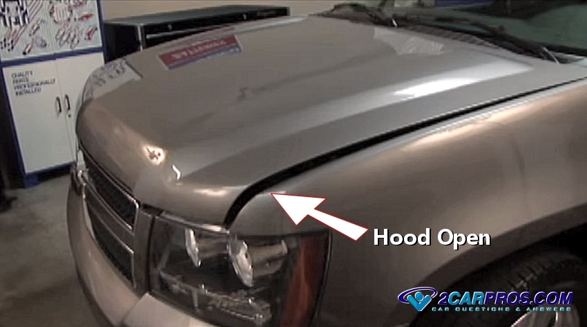

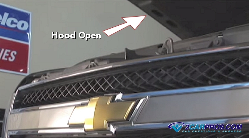

Step 3 - After pulling the release, the hood will pop open to the first stage having a noticeable gap between the fender and the hood line.
hood open

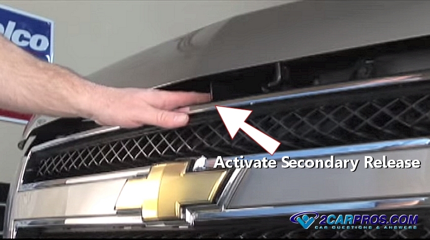

Step 4 - Once the hood has popped open, locate the secondary release and active it.
activate secondary release

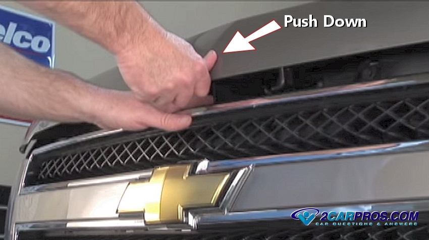

Step 5 - Gently press down on the hood slightly while activating the latch to facilitate this action.
push hood down

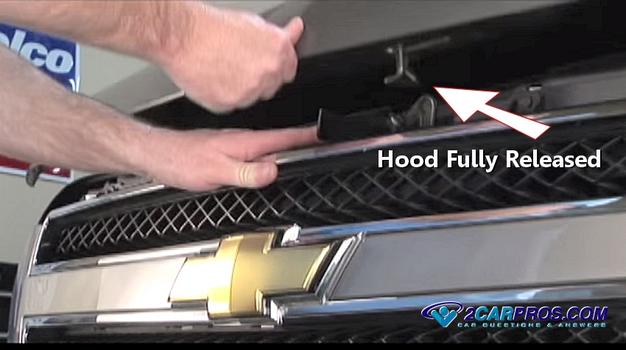

Step 6 - After the secondary release has been activated, release the pressure and gently raise the hood up.
hood fully released

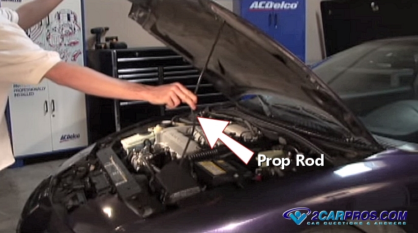

Step 8 - While other methods of hood support include a prop rod which needs to be put into place by hand.
hood prop rod

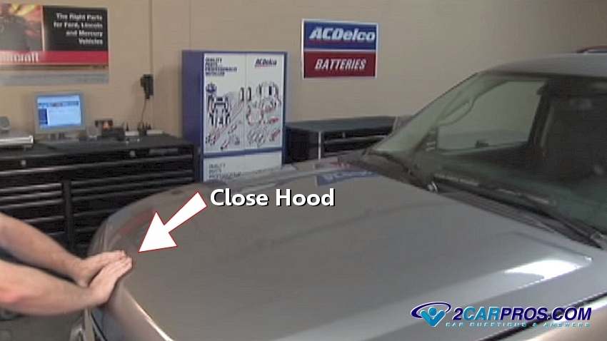

Step 9 - Once necessary repairs or inspections have been completed, gently pull the hood downward and firmly close the hood into place, after closing the hood try pulling up on it to ensure proper closure.
close hood
