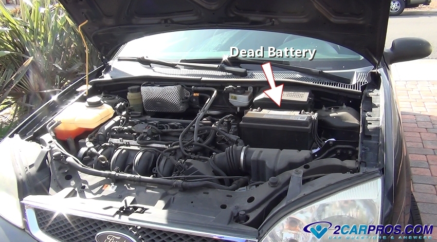

1. Lift Hood on Both Cars: Locate the battery in each car, nine time out of ten they are under the hood but sometimes they can be located in the trunk. Remove the battery terminal covers (if any) so the jumper cable clamps can get a good connection.

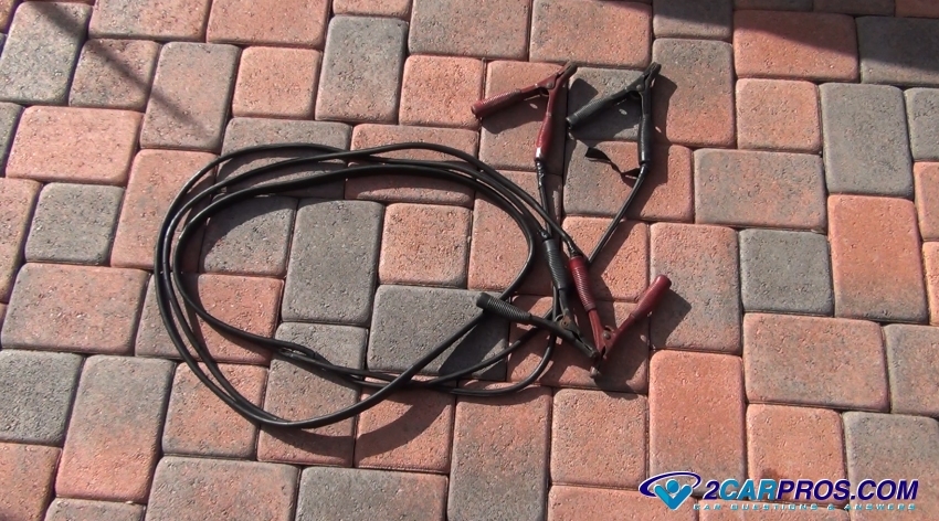

2. Inspect Jumper Cables: Gather your jumper cables and inspect them for any broken leads or open wires. Because these cables will carry high amperage they need to be of high quality and free from damage.
jumper cables

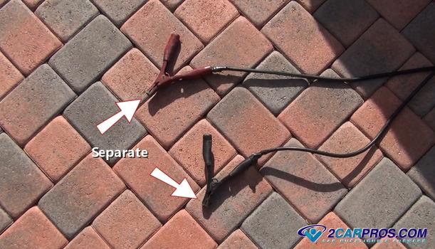

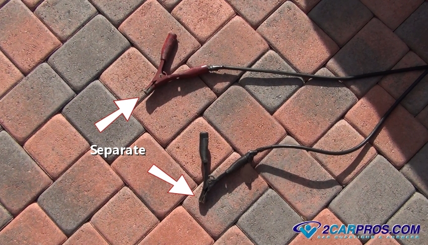

3. Separate Jumper Clamps: You will be connecting the jumpers to the car with the dead battery first, the opposite end of the cables must be separated. If these ends are touching when you connect the jumpers to the dead battery there will be a short circuit and sparks which can cause the battery to explode. We don't mean to scare you, but inside the battery there are hydrogen gasses which a spark can ignite. It doesn't happen very often but it does happen.
separate jumper cable ends

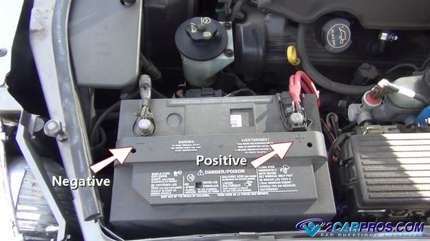

4. Identify Positive and Negative Battery Terminals: The most important rule when jumping a battery is identifying the positive (+) and negative (-) battery terminals on both the dead and charged battery. The jumpers must be connected in the same polarity, in other words positive to positive and negative to negative. The positive terminal will be slightly larger in size that the negative terminal.

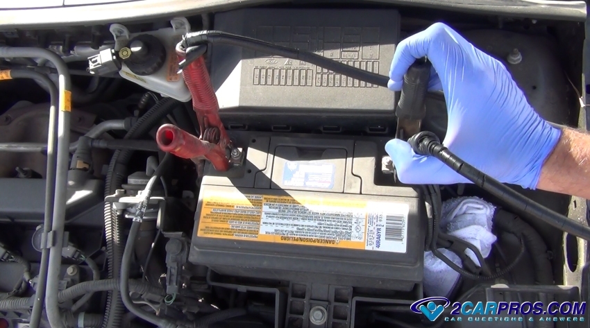

5. Connect Jumper Cables: Starting with the dead battery, connect the jumper cables by squeezing the clamps of both the positive and negative clamps and attaching them to their respective terminals. Black for negative (-) and red for positive (+) which should be indicated on the battery. Once connected, wiggle the clamps to get a good connection on both.
connecting the jumper cables to dead battery

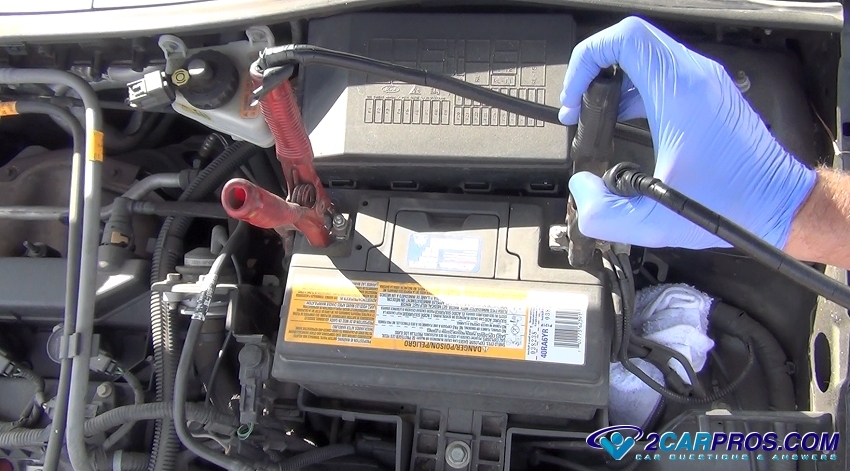

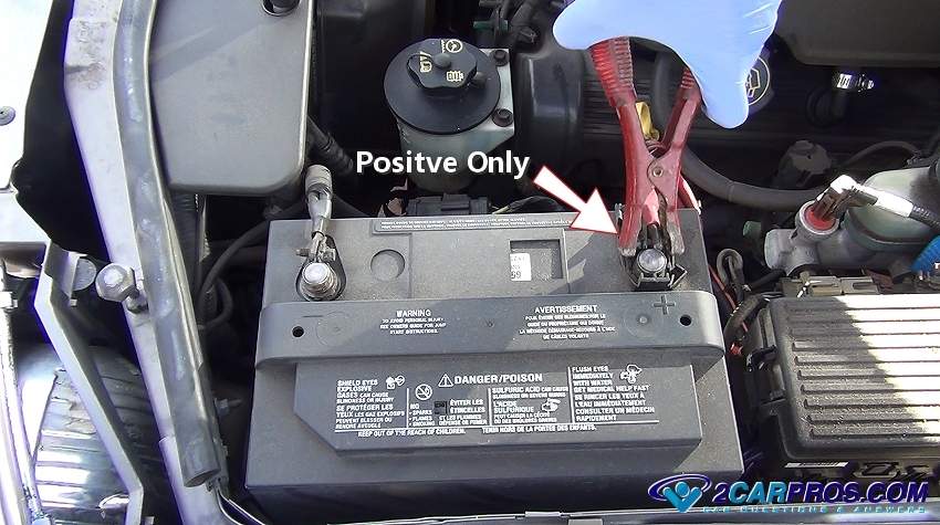

6. Connect Positive Jumper Only: Now you are ready to connect the charged battery to the dead battery, again making sure the positive and negative terminals are understood, connect the positive jumper clamp to the positive terminal which will be red or have a (+) sign near it. Take an extra second to make sure you are not hooking up the jumper cables backwards which can cause electrical system damage to both cars, wiggle the clamp to get a good connection.
connect positive jumper only

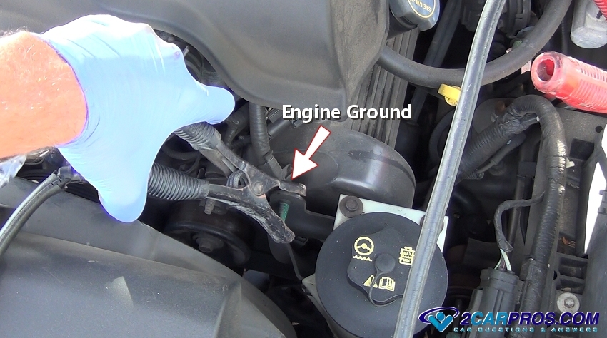

7. Connect Negative Jumper to Engine Ground Only: The final connection of the jumper cables will be to an engine ground only. The reason for this is because the final connection will make some minor sparks which can ignite hydrogen gasses inside the battery. For safety proposes find a metal bracket or bolt and make the final connection for the jumper cables. Wiggle the clamp to ensure a good connection, also you want to be sure the cables and clamps are clear from rotating engine parts such as the fan blade or serpentine belt.
jumper to engine ground

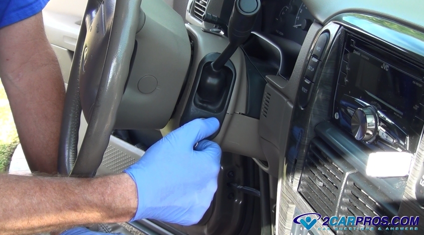

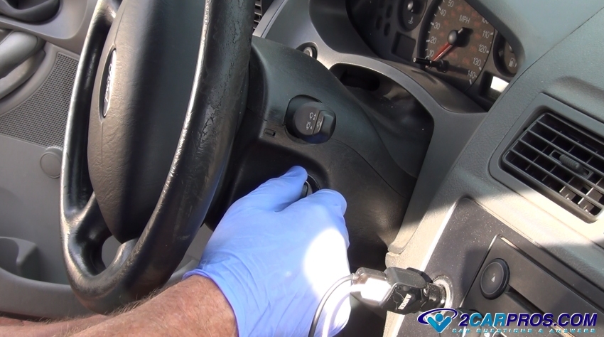

9. Jump Dead Battery: Turn the ignition system on of the car with the dead battery to start the engine. Have anyone in the area to step back when cranking over the car with the dead battery, once the car has started allow the car to run which will help charge the battery. Sometimes a jumpstart will not work because the dead battery has shorted inside and needs replacement.

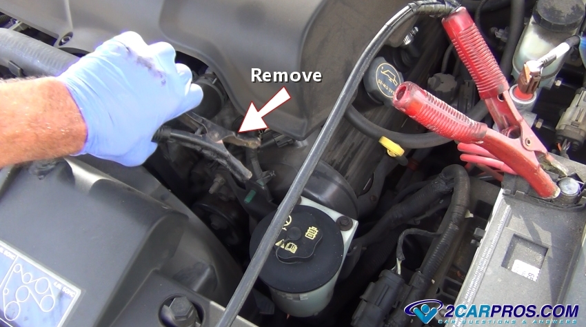

10. Disconnect Jumper Cables: Once the dead battery car has started remove the jumper cables and shut the car with the good battery off. Then remove the clamp from the engine ground to avoid sparks from near the dead battery. Remove the remainder of the jumper cable's clamps and then store them away for next time.
remove negative jumper cable first
