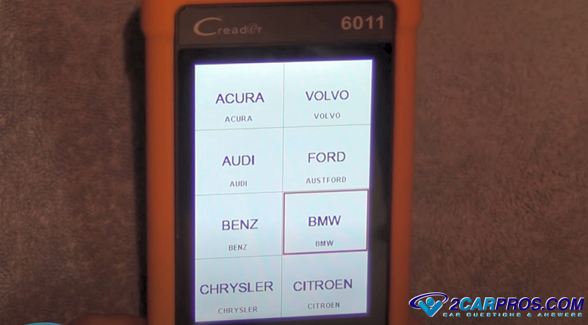

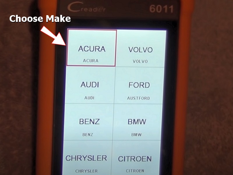

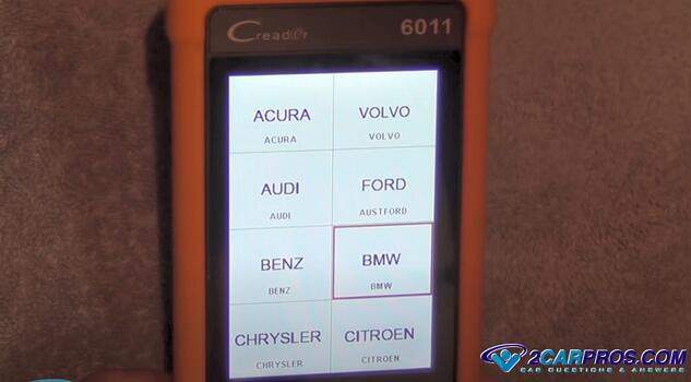

3. Select the manufacture type and prompt the scanner to begin the scan. The code reader (scanner) will then access the airbag control module to retrieve the fault codes.
air bag scan choose make

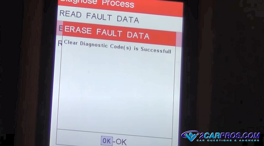

Once repairs have been made such as a spiral spring (clock spring) or impact sensor replacement (most common), the system could reset itself and clear it's own codes, this will turn the airbag warning light off. If the warning light remains on the codes will need to be cleared manually using the scanner. Just follow the prompts on the scanner and press "okay" you are all set.
clear airbag fault codes
Verifying the Reset
Once the codes are cleared, turn the vehicle's ignition system on and start the engine, then observe the airbag warning light on the dashboard. If the light turns off after a few seconds the reset was successful, if it remains on, rescan the system.
