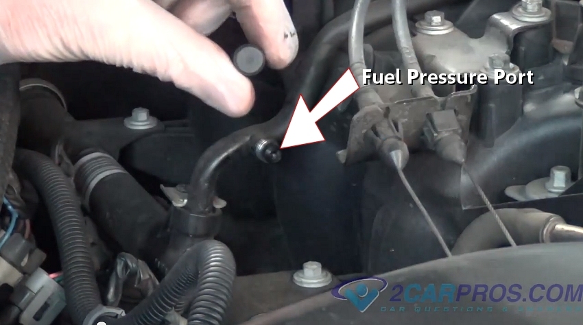

Pressure Port: Some cars are designed with a convenient pressure port on the engine fuel rail (remove cap) to attach the gauge to while other designs will need an adapter from the test kit which can be attached at the fuel filter or fuel pressure feed line headed to the engine's fuel rail.
fuel pressure port

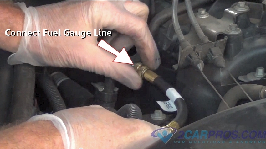

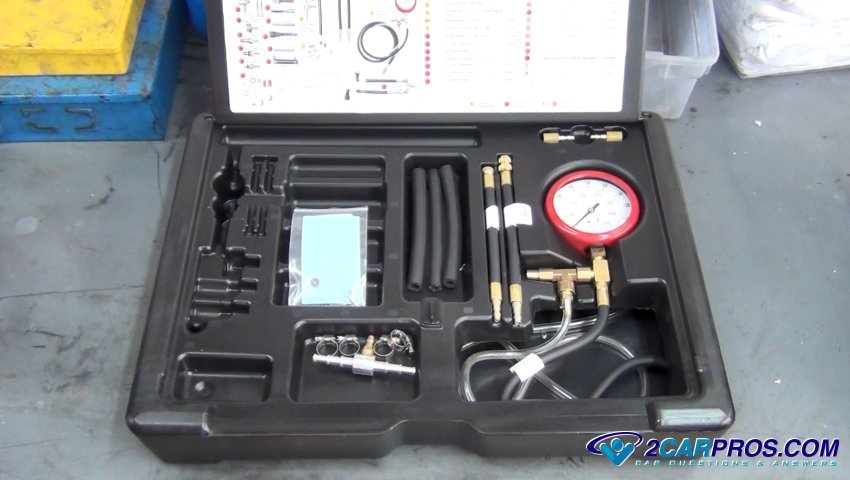

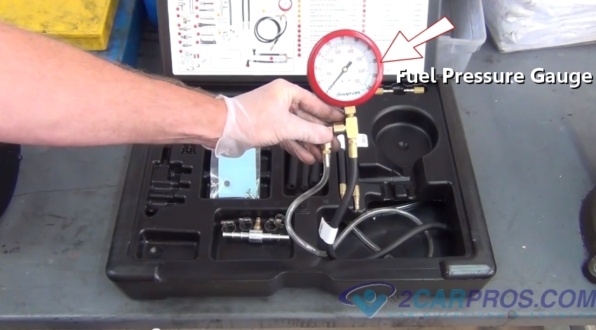

Remove the fuel pressure test gauge from the kit. Most gauges have a quick disconnect coupler that will allow several different adaptors for various manufacturers. The kit should have them labeled but if not look for the hose connector or fitting that will work for your car.
fuel pressure gauge
When attaching the pressure gauge (engine off) a small amount of fuel may be present so don't be alarmed have a shop towel ready.
connect fuel pressure gauge

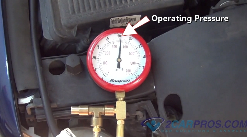

Without starting the engine turn the ignition key to the on position the gauge should jump up to between 45 psi and 58 psi (DPI) direct port injection systems, throttle body injection (TBI) should be between 13 and 17 psi in most cases as the system primes. If no pressure is present recheck the hose or adapter connection to avoid any false negatives, re-cycle the ignition switch to recheck. Still no pressure? suspect a bad fuel pump, fuel pump relay or fuse.
proper fuel pressure
Now start the engine so we can test the performance of the pump. While the engine is running, the fuel pressure should drop about 5 psi, from the static prime pressure (DPI) then snap the throttle, the fuel system pressure should jump up about 5 psi. this means the fuel pump and pressure regulator is working correctly. If the system fuel pressure does not respond inspect the regulator vacuum feed line and if okay the fuel pressure regulator has failed (if equipped).
operating pressure
