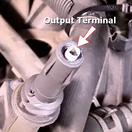

If the engine is not running choose the easiest spark plug wire or ignition coil to remove, or if you have a cylinder that is not producing power this guide will work. Here we have removed the ignition coil of the #2 cylinder and exposed the output terminal which connects to the spark plug.
ignition coil output terminal

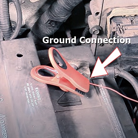

Use a piece of wire that has a small piece of the insulation removed on both ends, attach one side of the wire to a good ground source, either on the engine or to the negative side of the battery.
ground connection

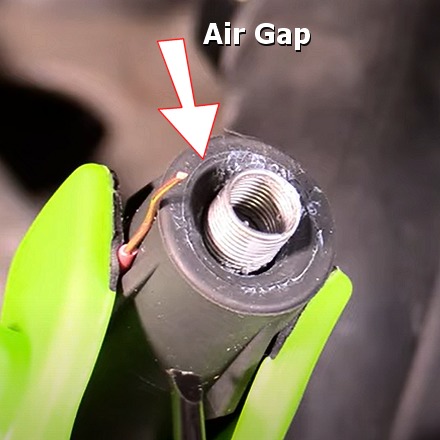

Using a clamp, position the exposed wire end away from the coil output terminal creating an air gap about the width of a pencil. This shows the coil output connector easily exposed, if that is not the case for your application simply bend the wire down into the coil or spark plug wire boot while retaining the air gap.
air gap

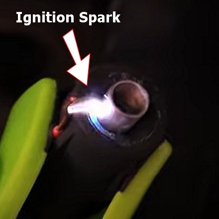

In this next image we have turned the lights off so you can see the ignition spark more clearly. Before you test for spark keep your fingers away from the wire and output terminal to avoid accidently getting zapped, (this is not enough to cause bodily harm, but it can sting a little). Crank the engine over and observe the air gap, there should be a visible spark if the ignition system is working. If the engine is running and you are checking a cylinder misfire or to see if the coil is working it's okay to allow the engine to run, again stand clear of the engine for this test.
ignition spark
