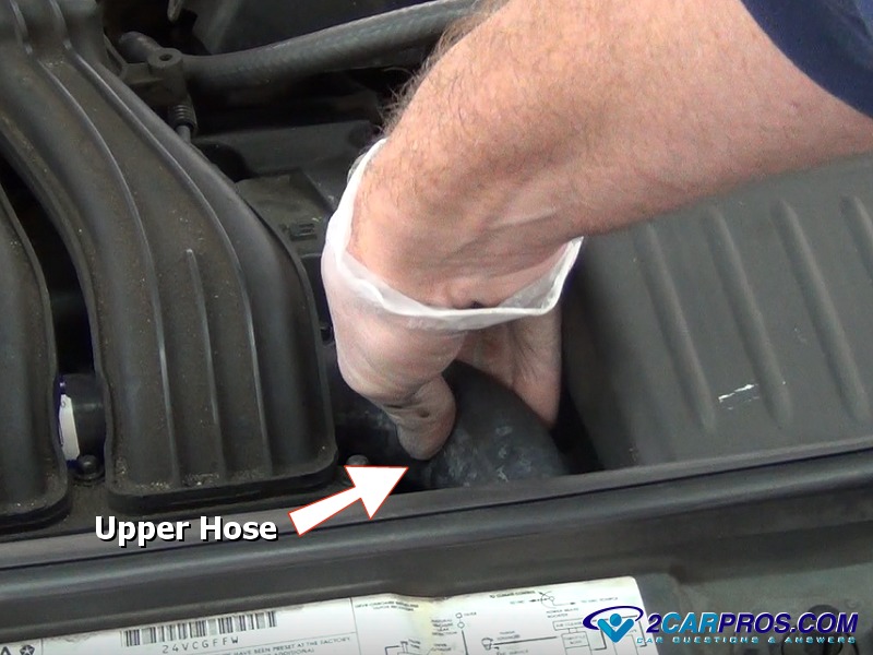

4. Before removing the system cap wear gloves to help protect yourself, also squeeze the upper radiator hose to determine how much pressure remains in the system.

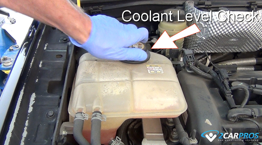

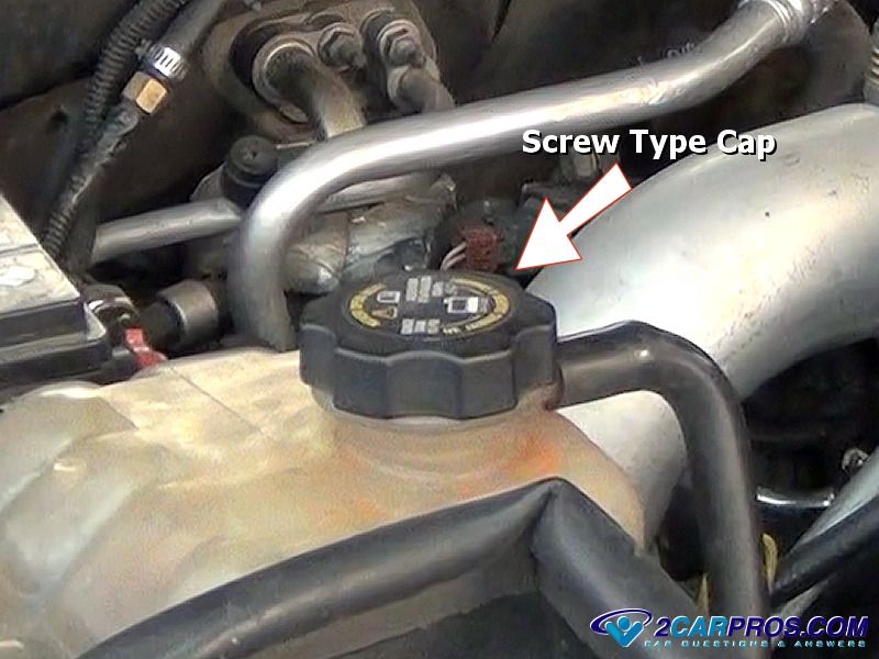

5. Most vehicles have a pressure cap on the coolant reservoir, open the cap slowly (counterclockwise), this will allow any residual pressure to escape. Most radiator cooling systems, (except EV's) are designed with an overflow expansion tank (pressurized) which should be about half full when the engine is cold.

6. Once the cap has been removed use a flashlight to inspect the coolant level, the translucent plastic tank with “MIN” and “MAX” level lets you see where the level should be, if low add only manufactures recommended coolant types. If the level is way down or the system is empty, the cooling system has a coolant leak which should be immediately addressed. After adding coolant, securely tighten the reservoir cap until it clicks or is fully sealed.

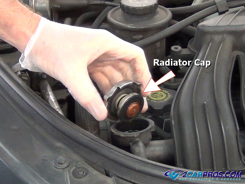

7. Older cars have a radiator cap which has a two step safety "built in" which requires you to press down firmly while turning the cap counterclockwise to remove, we suggest using both hands to remove the cap.
