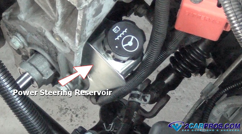

To check and add fluid to a power steering system you must first find the fluid reservoir which is under the hood attached to the steering pump, bolted to the engine front, or on a fender well. If exact locations or procedures are needed you can ask our experts to supply you with the information (free), or consult an online resource such as AllData DIY (pay) but this guide and video will be sufficient in most cases, we will show you several instants so you get the idea. Here is the location on a Acura which is on the passengers side fender well, more examples below.
power steering reservoir

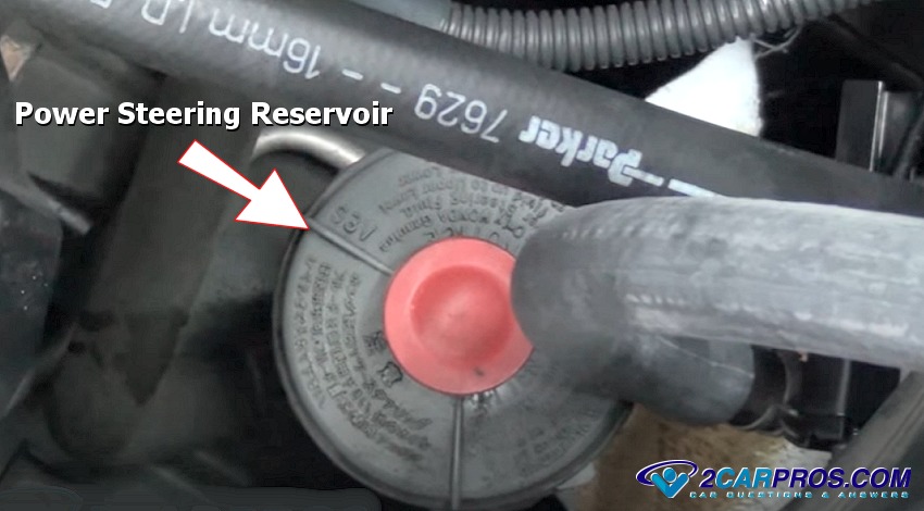

Here is a steering reservoir on an Chevy Suburban which is located on the lower drivers side of the engine.

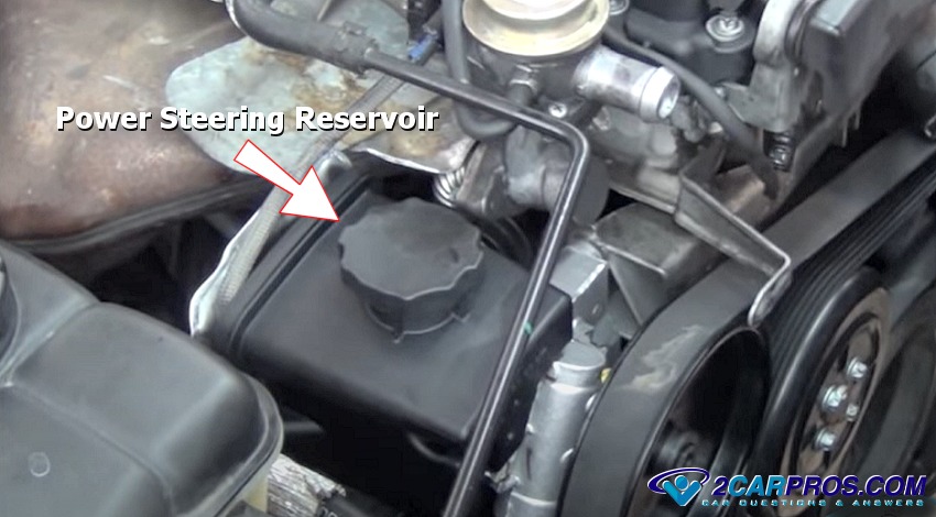

This example shows the location for a Mercedes Benz, which is on the passenger side of the engine, near the top, if you look for the steering pump you will find the fluid reservoir.

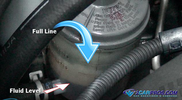

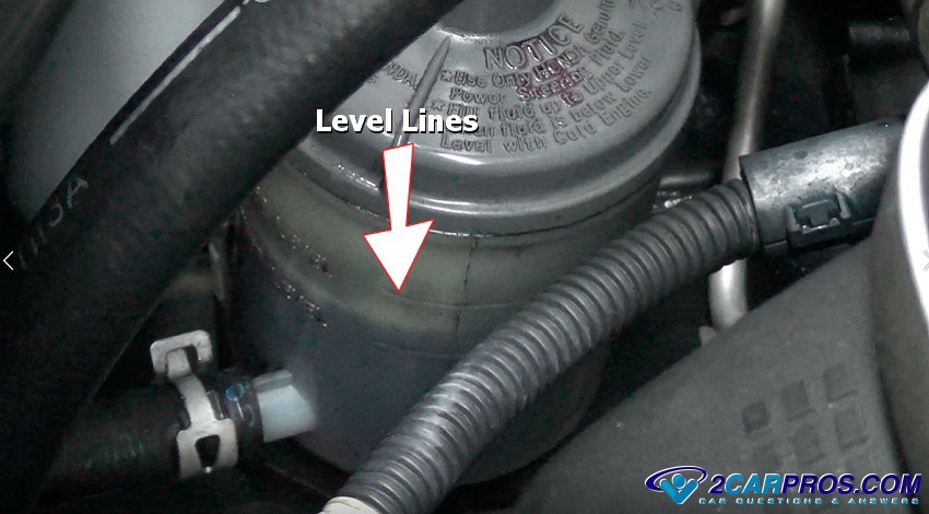

Checking the fluid level: Start the engine until warm, then shut the engine off. Some reservoirs have a see-through container that tells you where the fluid should be as in this example, these kinds of reservoirs do not have a fluid dipstick. You must add fluid until it's between the lines of the reservoir as in the image below.
power steering fluid level line

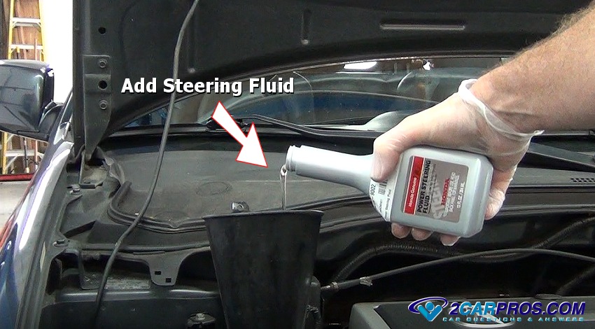

Remove the reservoir cap and insert a fluid funnel, add fluid while watching the level line on the reservoir.
add power steering fluid

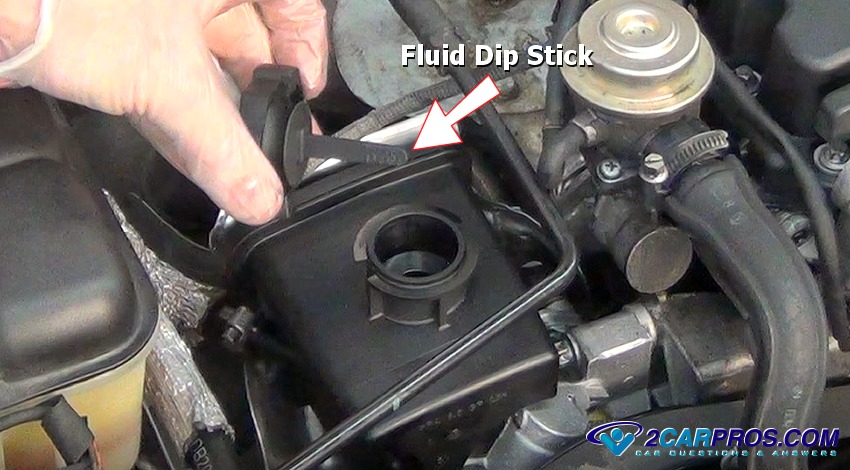

Here is a reservoir type that unitizes a dip stick which is under the cap. This type is added too just like the see-through reservoir except you will need to add in increments, checking the fluid level as you go and continue until full.
steering pump dip stick

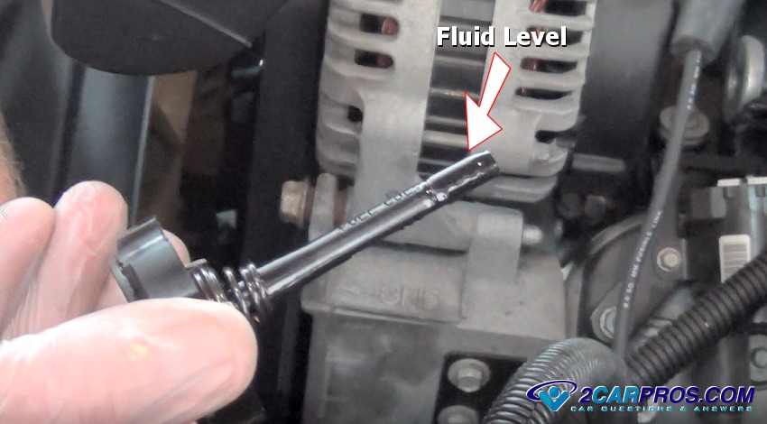

Here is what the fluid should look like when full on the dipstick.
steering fluid level dip stick
