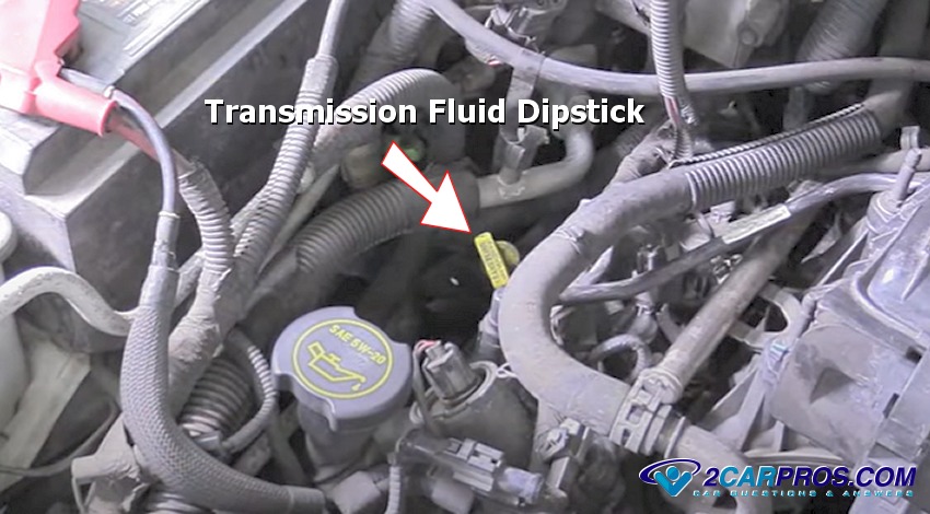

Park the vehicle on a level surface and start the engine allowing it to idle. With the parking brake applied, place the shift lever in park, some older cars will need to be checked in neutral which it will say so on the dipstick. With your foot on the brake pedal, move the shift lever through each gear, pausing for about three seconds, position the shift lever back into park. Located the fluid level dipstick which should be toward the rear of the engine, (rear wheel drive).

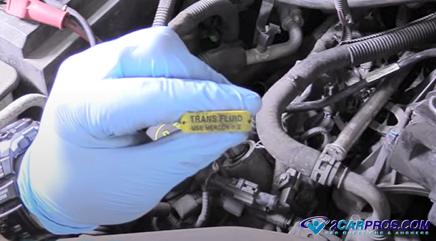

transmission fluid check auto Some dipsticks will be labeled with the type of fluid used or the updated equivalent, this one says Mercon 5 in small print.
transmission fluid dip stick

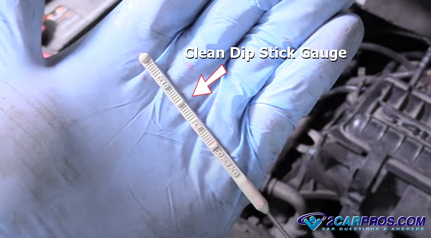

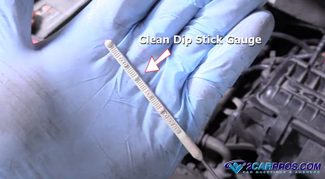

Remove the dipstick and wipe clean using a paper or shop towel, typically a dipstick will be fairly long.
clean dip stick gauge

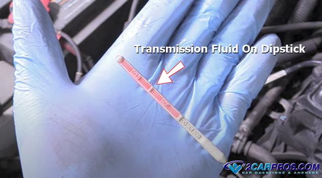

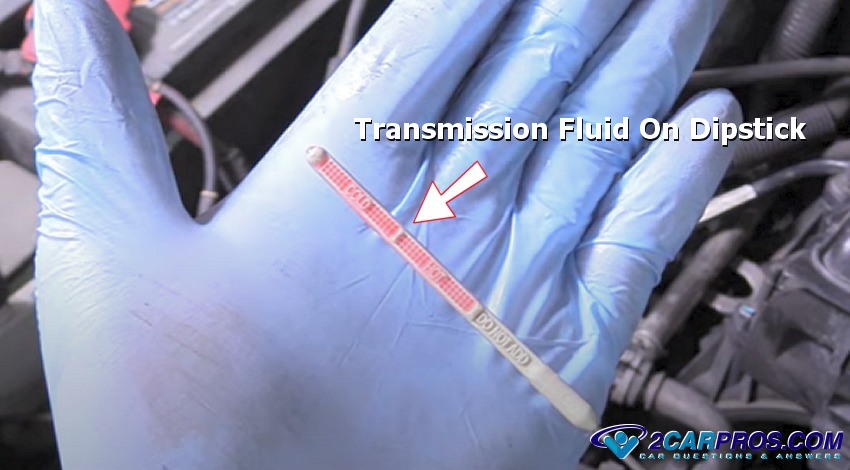

Return the dipstick so it is fully seated inside the tube, wait three seconds, and pull it back out again. This will show the level of the fluid inside the transmission. Check both sides of the dipstick to confirm the fluid level which must be in the crosshatched area above the minimum level indicator. If the fluid level is in the acceptable range, reinstall the dipstick and you are all set. If the fluid level is low, use a long-neck funnel to add only enough fluid to bring the level into the crosshatched area on the dipstick. Start by adding a 1/4 quart at a time, add enough fluid to bring it up to the proper level, do not overfill.
transmission fluid on dipstick

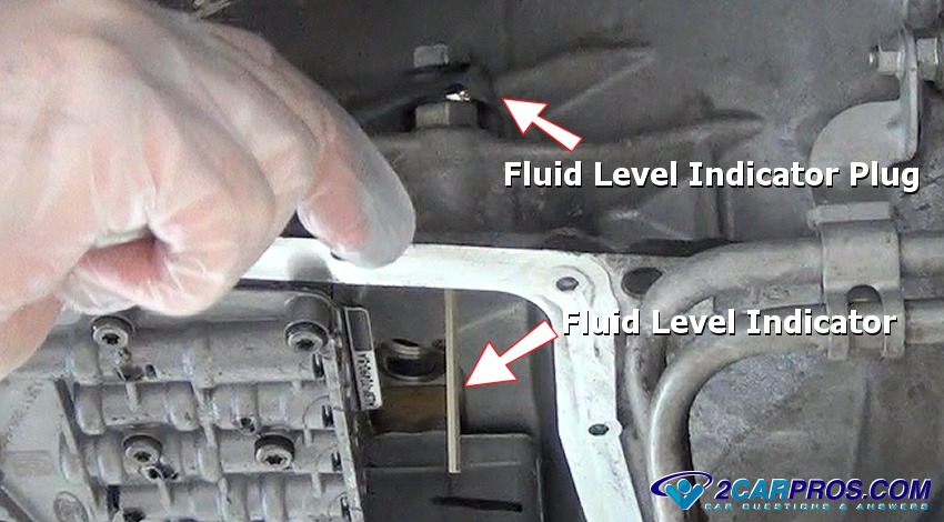

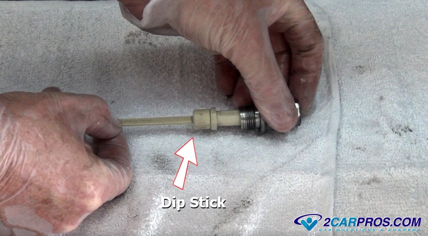

With the engine at idle, raise the vehicle on a hoist or lift using a jack supported by jack stands. The vehicle must be level with transmission in park. Remove the dipstick plug with the level indicator attached. The image below has the fluid pan removed so you can see the level indicator. Unscrew the plug and proceed to check the fluid level in a normal manner. If fluid is needed a small fluid pump can be used which is about $10.00 (US) on Amazon.
transmission fluid level indicator

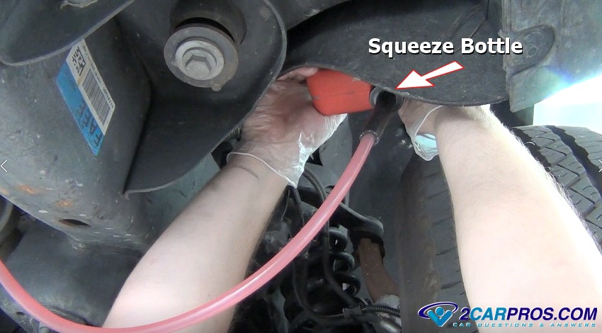

Here you see innovation as our mechanic is using a squeeze bottle style of arrangement with a plastic tube attached to add fluid.
transmission fluid squeeze bottle

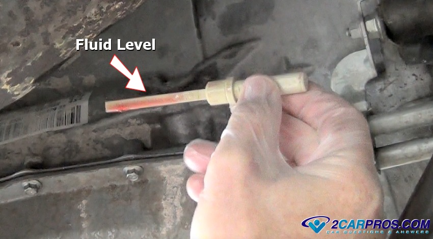

Remove the fluid level gauge from the fill plug, This will be used to measure the amount of fluid inside the transmission.
While the engine is still running insert the level gauge into the plug hole and remove, this will show the level of the fluid.

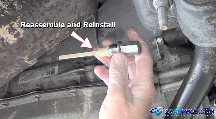

Reassemble the level gauge back into the plug and reinstall back into the transmission case and tighten, (5 foot pounds) and you are all set.
reassemble dip stick

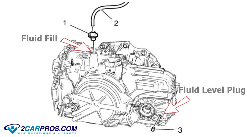

Here is an example of a side plug type which works in a similar manner. The side plug style is filled until it runs out then reinstall the plug, much like a differential or standard transmission fill plug, again the engine must be running. (Images courtesy of AllData)
fluid fill level plug

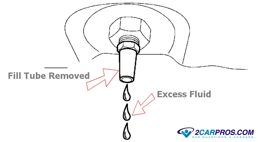

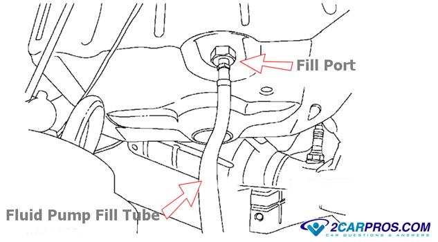

This is the drain tube type. The fill tube style acts much like the side plug style, pump fluid in, then remove the fill tube and the excess with run out creating the correct fluid level, (if the fluid is flowing as a steady stream, wait until the fluid begins to drip before replacing the fill plug, if no fluid flows out, add fluid until fluid drips out). The fluid level height is achieved by the tube inside the transmission pan. (Images courtesy of AllData)
fluid pump fill tube
excess transmsison fluid
