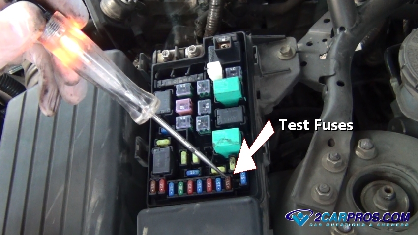

Before beginning your testing, use a test light and check all fuses and replace any that have failed.
testing fuses

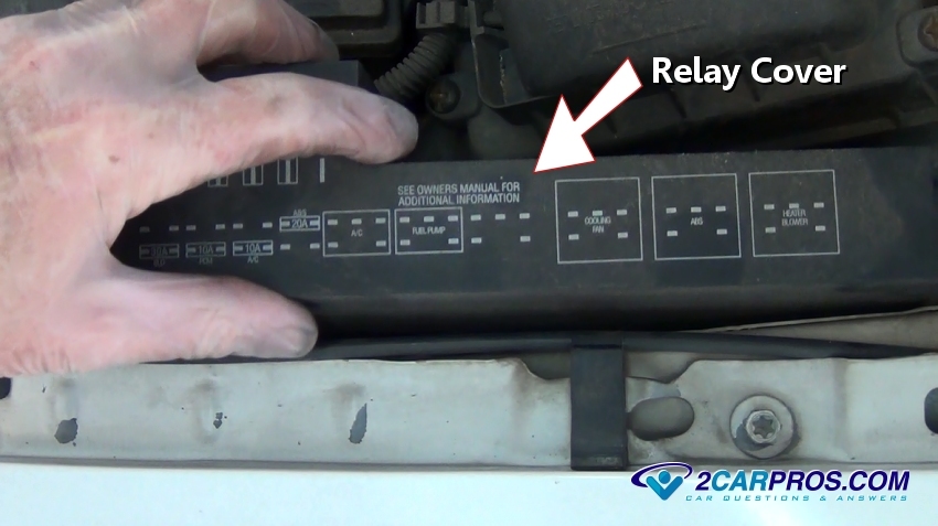

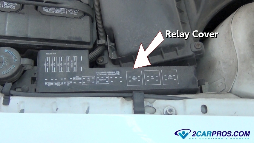

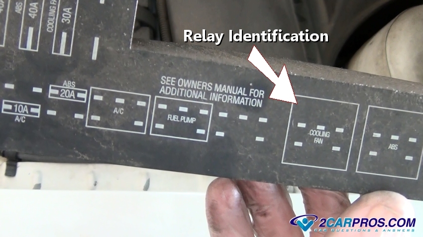

Many vehicles supply relay location and identification information on the lid of the PDC. If this information is not available, please ask one of our experts to help, its free or check the owners manual.
relay identification

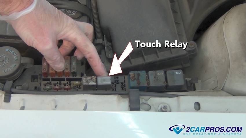

Once the relay has been identified, gently grasp or touch the relay in question, have a helper turn the ignition key to the on position, then crank the engine over, the relay should click in one of the ignition switch positions. If so the trigger circuit of the relay electrical system is working, if not continue to next step. If the relay clicks and the circuit is still not working there is a good chance the contacts inside the relay have shorted.
touch relay

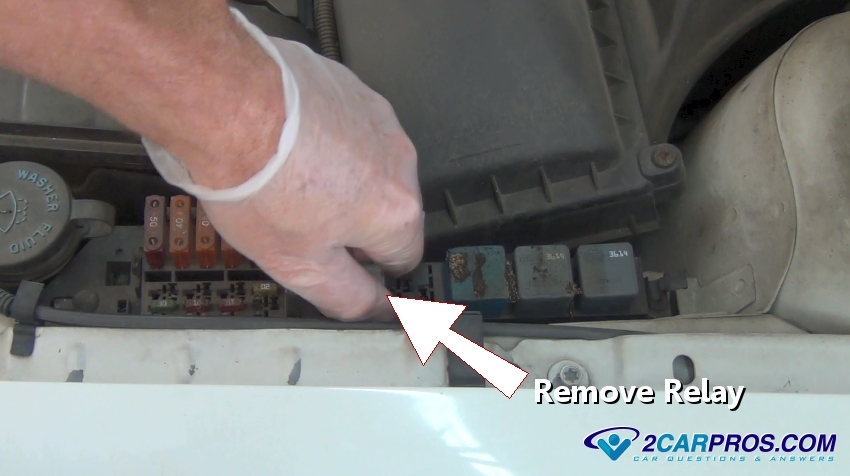

Next, remove the relay for inspection, grasp the relay and pull outward while slightly wiggling the relay housing, note the orientation of the relay, it must be installed the correct direction.
remove relay

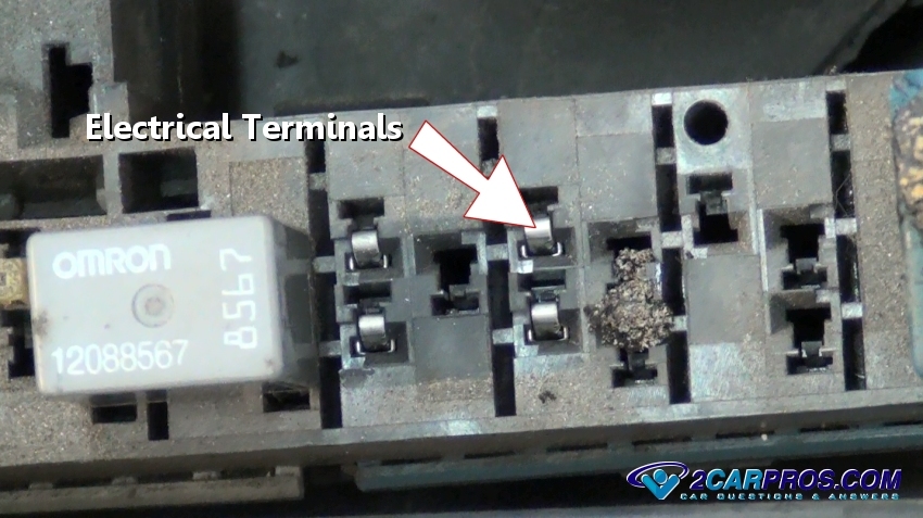

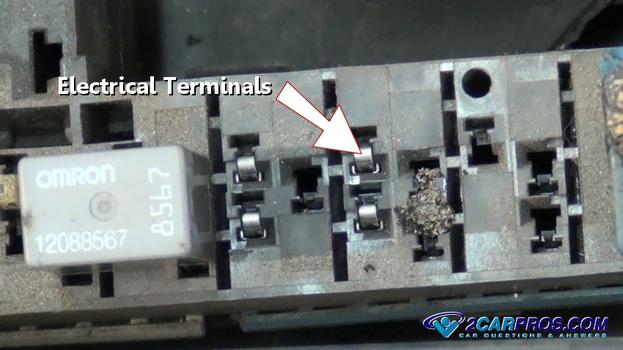

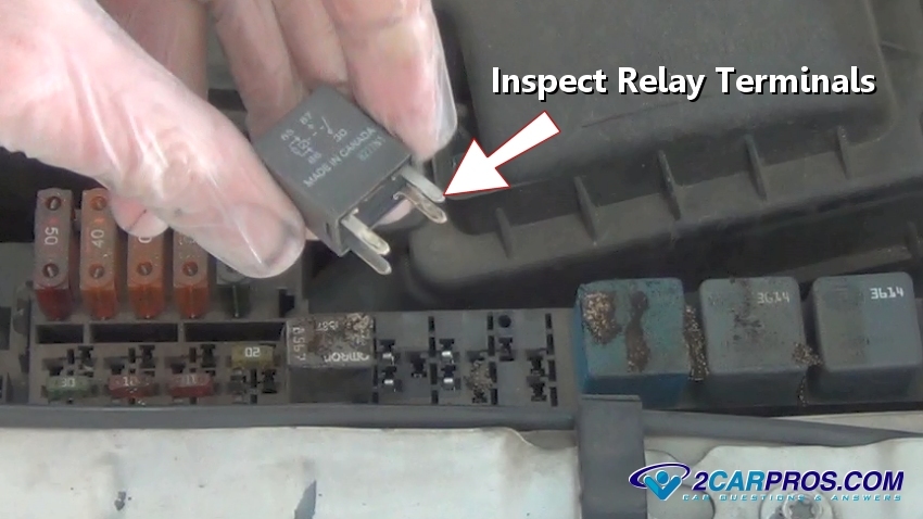

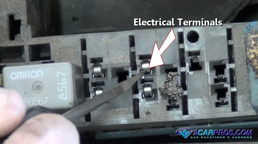

Once the relay has been removed, inspect the relay terminals for signs of extreme heat or corrosion.
inspecting relay terminals
The relay is mounted in four electrical terminals housed in plastic and when overheated (due to overload or resistance caused by a poor connection) can distort and melt.
inspecting terminals

Use as small metal scribe or tool to scrape clean any corrosion to ensure a good connection once the new relay is installed.
clean terminals

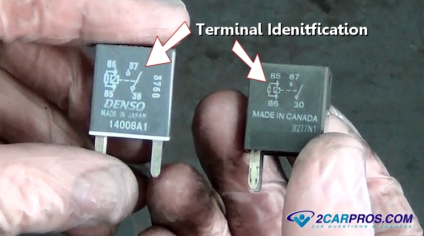

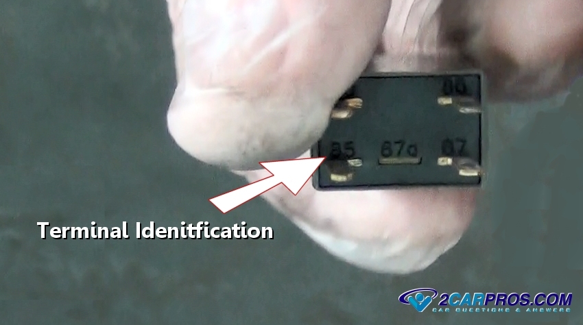

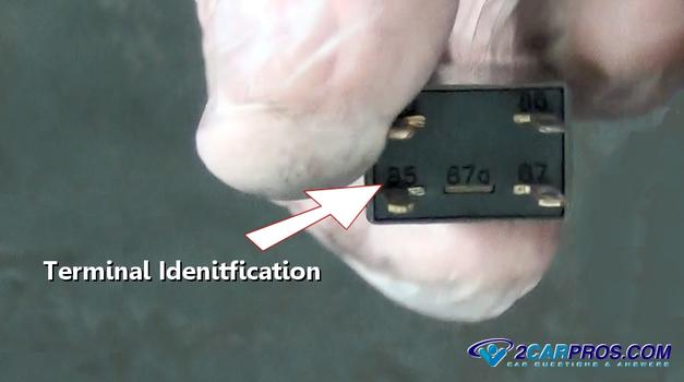

Most relay's describe the internal circuit by an illustration on the side of the relay.
Relay Terminal Identification

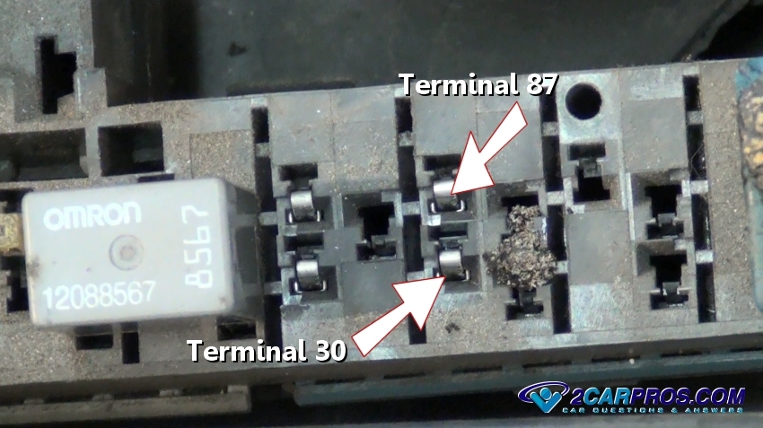

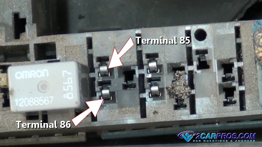

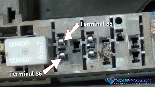

    Terminals 86 and 85 are the primary side of the relay, which utilizes an electromagnet to close (connect) the secondary electrical circuit inside the relay. This electromagnet is activated by a simple power (+) and ground (-) much like a light bulb circuit.
    Terminals 87 and 30 are the secondary side of the relay which acts as the "switch" that connects electrical current from one terminal to the other.
    Terminal 87a is not widely used and does not need to be connected for the relay to operate. 87a can be used for many different things such as relay activation monitoring or connecting a separate circuit that uses power when the relay is not in use.
relay terrminal identification
Each terminal is identified at the relay base.
relay identification bottom

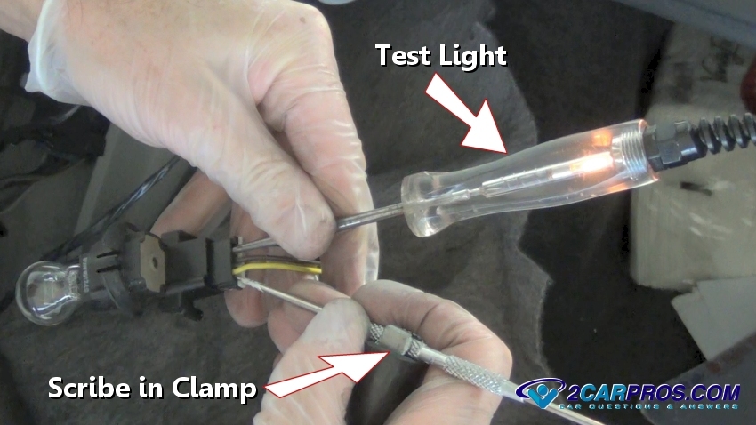

To test the trigger or primary side of the relay set up a test light by connecting a scribe to a test light clamp, being illustrated in the picture below while testing the tail light socket, just apply this method to the relay terminals.
test light
Once the test light is set up connect each end to terminals 86 and 85. Now start the vehicle and operate the accessory switch, the test light should illuminate, if not the switch or circuit ground has shorted. ( Note: if the circuit is computer controlled a delay could be programmed into the operation of the accessory, additionally if a cooling fan is being tested the engine must reach operating temperature before the computer will trigger the circuit.) Use the test light grounded to check for power, and then switch the test light lead to the power side of the battery to check for circuit ground.

Next, use a piece of wire automotive wire (20 to 16 gauge) and strip both ends exposing the copper wire. Turn the ignition to the "ON" position and jump terminals 87 and 30 the relay is now jumped and the accessory should activate, if so the relay has failed. If no power is observed at either 87 or 30, the fusible link or maxi fuse has shorted. Example: Testing the radiator cooling fan relay, the cooling fan should be operating.
testing terminals 87 30

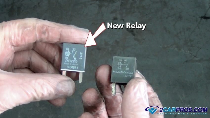

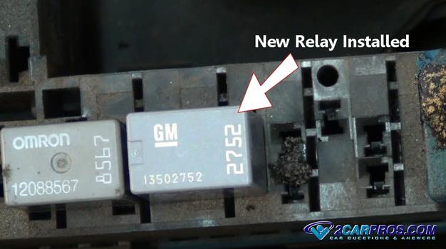

When replacing a relay be sure to match up the terminal location from the old relay to to the new unit.
new relay
When installing the new relay be sure the orientation is correct or the relay will not work.
new relay installed
Once proper relay operation has resumed, reinstall the relay (PDC) cover.
reinstall relay cover
