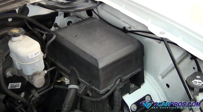

 Most cars are designed with multiple fuse panels which are usually located under the hood, in the interior of the car or in the trunk. These panels are commonly known as the PDC (power distribution center) or fuse and relay panel which can be identified by having a black plastic cover over the top or side of the panel. Each car is different, an owners manual will indicate the location and fuse designation. If you don't know where a particular fuse is located please ask one of our experts and they will help find it for you.

As with any electrical problem its best to inspect which ever accessory is not working such as a window motor, HVAC system or external lighting is to check all other accessory operations as well. This is because there are many shared power sources which can help trace down issues especially in newer vehicles designed with a BCM (body control module), TIPM (totally integrated power module) or IPDM (intelligent power distribution module) electrical elements. Turn the ignition key on without starting the engine to begin. Below is a typical fuse and relay panel under the hood. Usually you can see several wiring harnesses protruding from the unit.

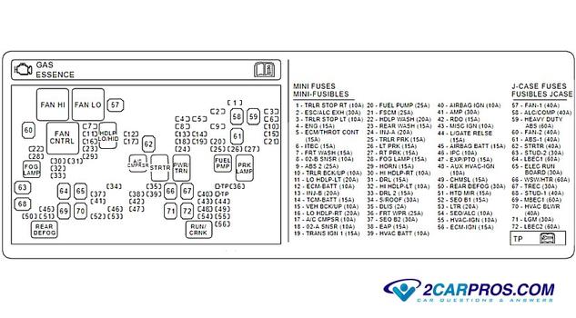

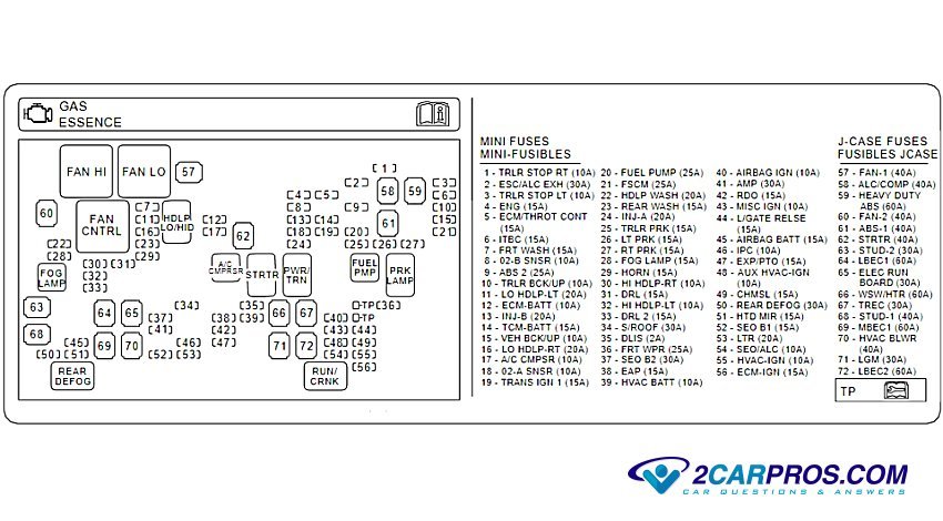

The lid or cover of the fuse panel will in most cases have the fuse and relay identification illustration depicting what the fuse controls and which amperage it should be replaced with if blown, or popped as some say. Here is what a typical fuse and relay legend looks like.

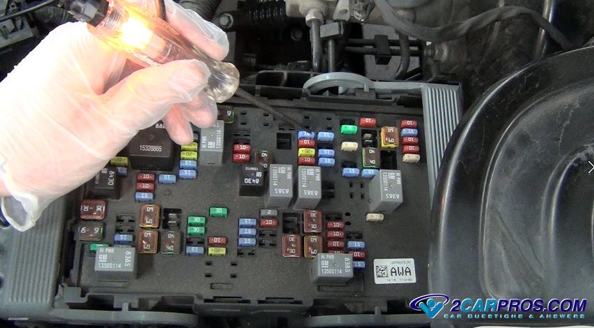

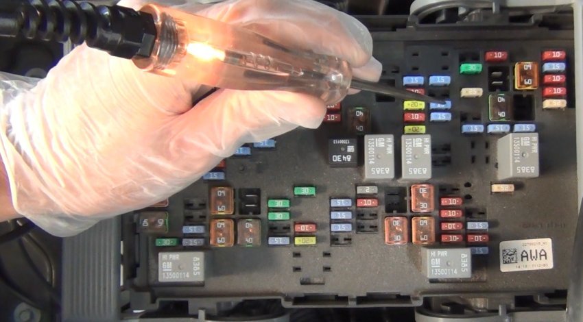

Again, with the key still in the on position start checking for power at all fuses, ground the test light and touch the point to the top metal tangs on both sides of the fuse. A fuse with power on just one side is blown and needs replacement. Note: Some fuses will not have power on either side due to nonuse of the fuse at the time. When testing lighting system fuses etc its best to have the system in question turned to the on position.

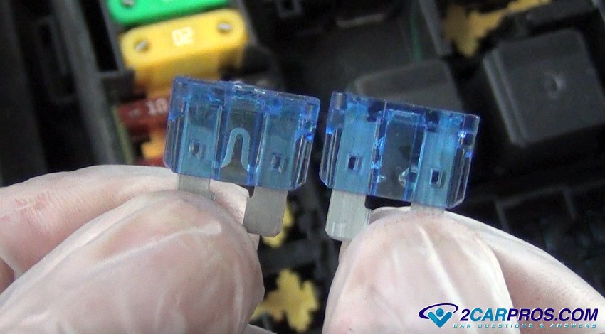

Once you have found the bad fuse remove the unit using your fingers or a small pair of pliers. Sometimes there will be a tool located inside the fuse panel to help with the removal. This is what a bad fuse looks like compared to a good one. Replace failed fuses with proper amp rating, not doing so can result in electrical system damage. Also, fuses can cause intermittent open circuits by becoming loose or corroded in the fuse holder, make sure fuse is held securely and free from dirt or corrosion.
