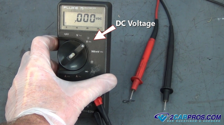

Switch your voltmeter onto the V position of DC current testing which is shown by a straight line with a broken line below it. Allow the meter to find it's reading of .000 volts. If the meter has been around for a while it's a good idea to open it up and change the battery. This will help the meter read more accurately and make the meter ready for testing.

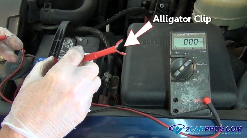

Locate the battery which is under the hood in most cases but some car's have them under the back seat or in the trunk. If you have a set of alligator clips that came with your meter you can change them out for the standard point probes which make testing easier but are not necessary. You can simply hold the test probes to each one of the battery terminals during the test. Wear gloves and protective eyewear.

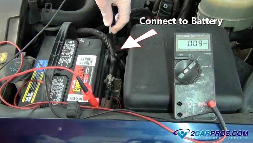

Identify both the negative (black) and positive (red) battery terminals. If both are either red or black reference the battery itself for markings depicting the polarity + or - . Next, attach the voltmeter leads or simply hold the leads onto the battery terminals.

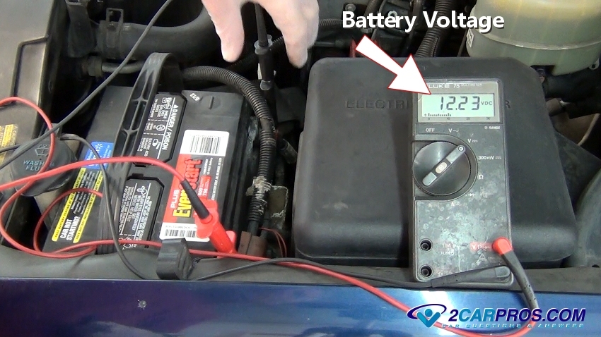

The voltmeter should read the battery voltage @ about 12.2 to 12.6 volts. If the battery is down on charge these readings will be lower and can be anywhere from 6.5 to 10.8 volts. If so the battery will need to be load tested, charged or replaced before testing can begin.

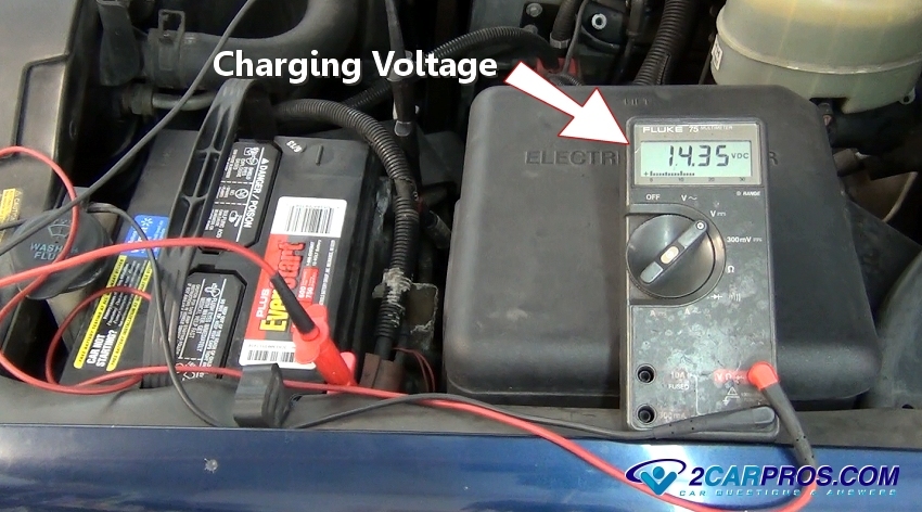

Have a helper start the engine and hold the RPM's just above idle at about 1500 and observe the meter. It should read between 13.6 and 15.2 volts depending on battery condition and state of charge. If the voltage on the meter stays the same or drops when the engine is started the alternator is not charging. You should then check the fuse panel for blown fuses and inspect the wires in the harness which lead to the alternator. If everything checks out the alternator is bad and needs replacing.
