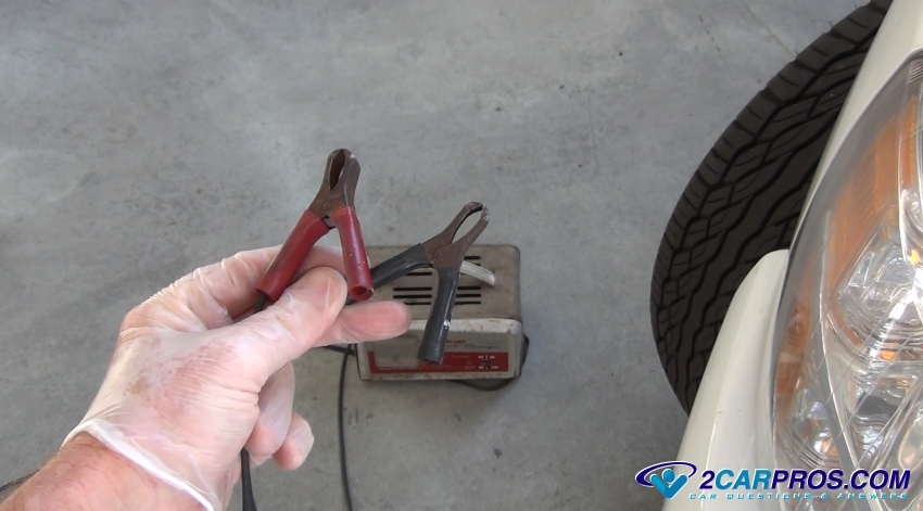

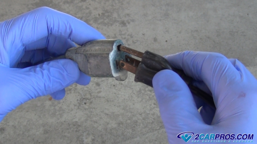

1. Inspect the Battery Charger: It's important to use a battery charger that is in good shape to avoid short circuits which may cause a spark over the battery. Look for broken leads or a damaged plug and replace or repair the charger if needed.

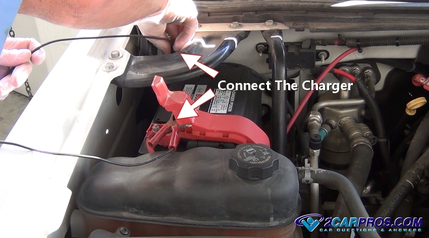

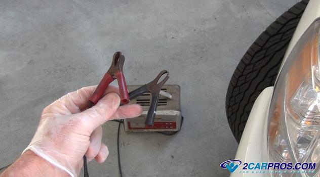

2. Connect the Battery Charger: Lift the hood of your car and locate the battery, in some cases it will be in the trunk. While wearing gloves uncover the positive terminal of the battery. These terminals will be identified by a (+) or (-) sign. Before connecting the charger make sure it is unplugged or turned off. Then connect the red spring loaded clamp to the positive side and the black clamp to the negative side (it does not matter which order). Once connected wiggle the clamps to make sure they are getting a good connection. Do not hook up the charger backwards, this can cause electrical damage to the car and the charger.

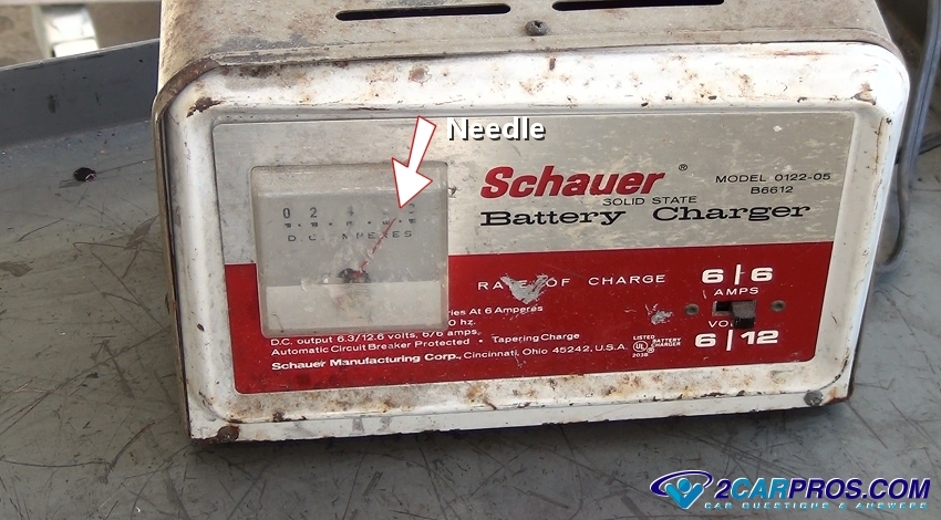

4. Watch the Charger Gauge: After turning the charger on the gauge at the front of the charger it will do one of three things;
  • Not move which means you have a bad connection at one of the terminals or the charger is not working. In this case switch the charger off or unplug it and then reposition the clamps or get a new charger.
  • The needle will jump to the top of the gauge and slowly move downward as the battery charges. This is a normal pattern of the dead battery.
  • The needle will move a little bit which means the battery is probably no good due to an internal short, or the battery is fully charged.

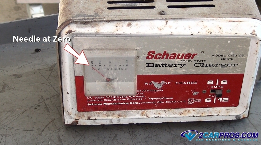

5. Charging the Battery: Depending on the state of charge and the condition of the battery charge times will vary. As the battery charges the needle will drop lower until it does not move anymore which is telling you the battery is completely charged. If you try and start the car with the charger connected it can trip the circuit breaker inside the charger which prevents charger overload. When the circuit breaker cools it will reset and the charger will be ready to go again. When this happens the gauge will drop to zero. A fully charged battery will typically show 12.6 volts or more when fully charged.

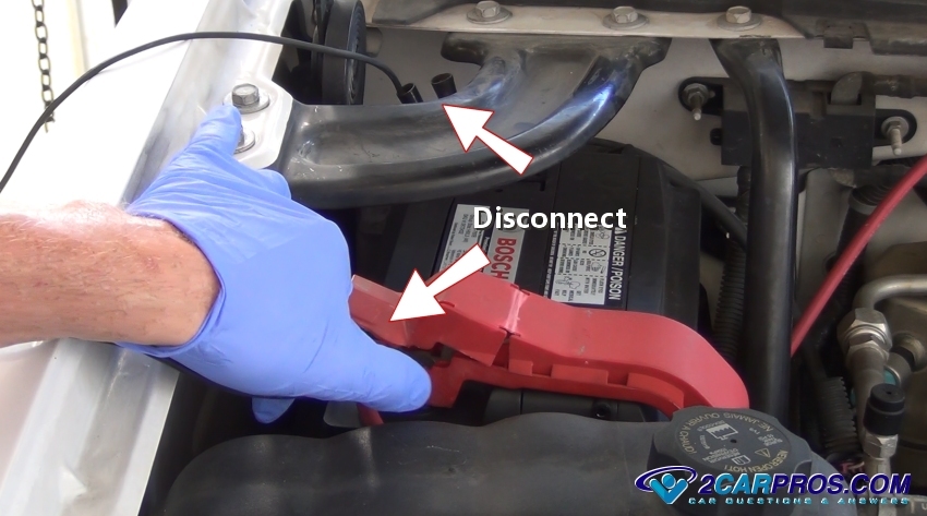

6. Disconnect the Charger: After the battery charging is complete turn the charger off or unplug it. This will stop the currant flow of electrically and will help you not to cause a spark near the battery which rarely can cause an explosion. A battery is most prone to an explosion after a recharge due to the hydrogen gasses produced while charging. To check the batteries condition after the charge it's a good idea to perform a load test, this will let you know if the battery is any good or not.
disconnect battery charger
