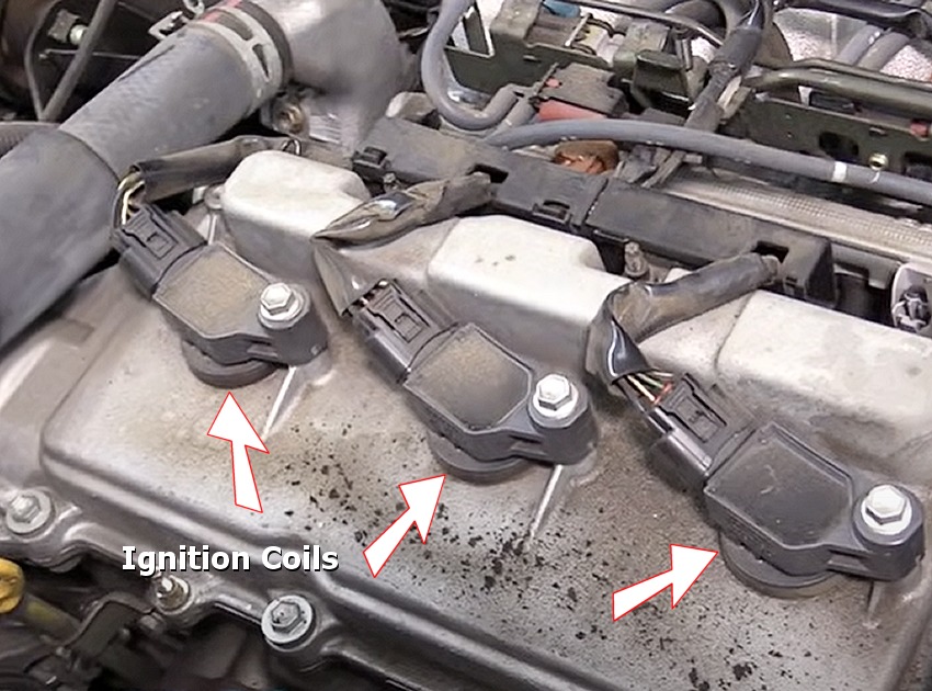

In the example below the engine is designed with a plastic cover for aesthetics,
this may pull straight off with clips or small screws or bolts which will facilitate
the removal. Here you can see the ignition coils exposed, in this example we are showing three
cylinders of a Toyota V6 engine designed with a COS system (coil over spark plug)
which uses no spark plug wires.

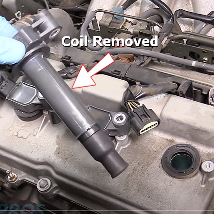

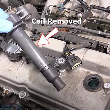

Although you may be able to remove the coils without disconnecting the wiring,
it makes for a cleaner job if you unclick the wiring connector safety and remove
the wiring connectors from each coil. Remove the coil mounting bolts which is usually
a 10mm as in this case, then remove the ignition coils and inspect for corrosion
or signs of arcing, replace as needed.

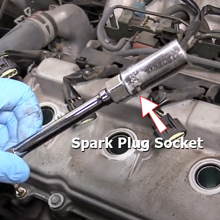

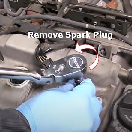

The spark plugs are now exposed and ready for replacement. Use a spark plug socket
which is lined with a rubber cushion to safely support the spark plug insulator,
a ratchet and extension is used to reach down inside the spark plug well.

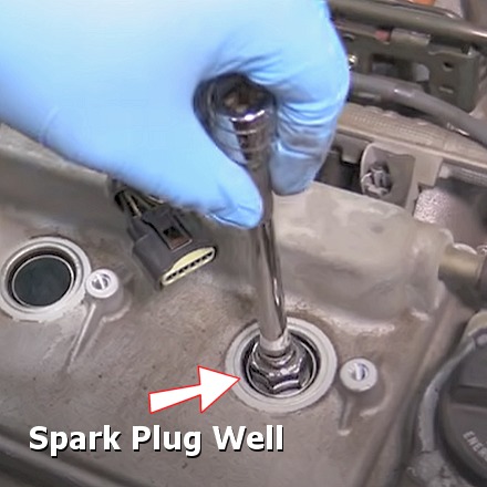

Insert the socket and extension down into the spark plug well. Ensure the socket
is completely on the spark plug before removal to avoid stripping the plug hex.
Grip the socket wrench firmly and turn the spark plug counterclockwise to remove
it from the cylinder head.

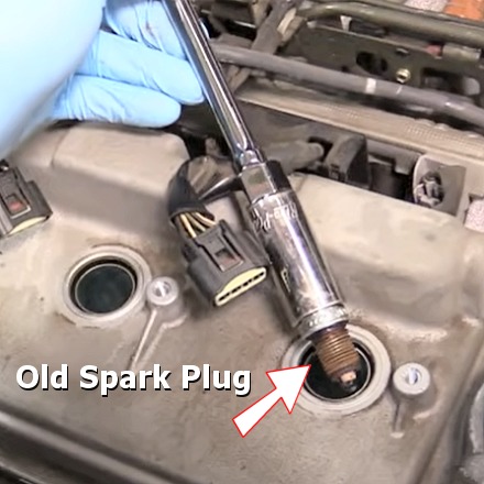

The old spark plug will be held in the socket via the rubber insulator, inspect
the plug for damage and wear. Be careful not to drop anything into the spark plug
well.

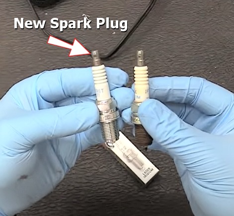

Compare the new spark plugs to the old ones to ensure the correct plug is being
installed.

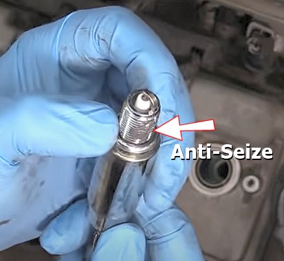

Before installing the new spark plugs, apply a thin layer of lubricant (anti-seize)
to avoid thread galling (stripping). Insert the spark plug into the socket while
ensuring a snug fit, the spark plug shouldn't fall out of the socket on its own.

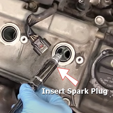

Gently lower the spark plug down into the plug well (do not drop), continue installing
the spark plug while threading it in by hand.

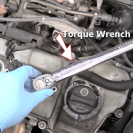

Attach a ratchet to the extension and tighten the plug until snug, then use a
torque wrench to tighten the plug to the correct specification, in this case it
was 19 foot pounds but it will vary, so obtain the correct manufacturers specifications
or ask one of our experts to help (free), do not over
tighten the spark plug.

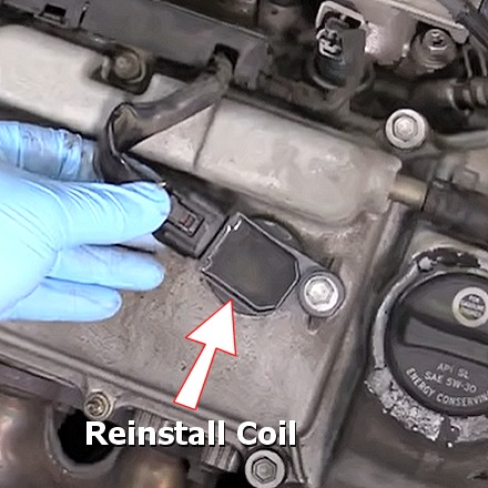

Reinstall the coil into the plug well, making sure the end of the coil is over
the spark plug. After installing the ignition coil, reinsert the mounting bolts
and tighten to spec, which in this case was 7 foot pounds. Reinstall the coil electrical
connector and repeat this process throughout the remaining engine cylinders and
reinstall the engine cover back into place. Start the engine and observe its performance,
