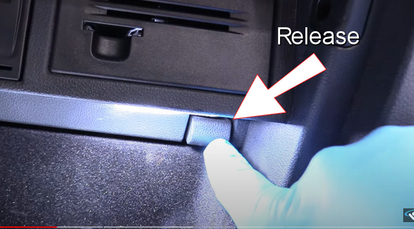

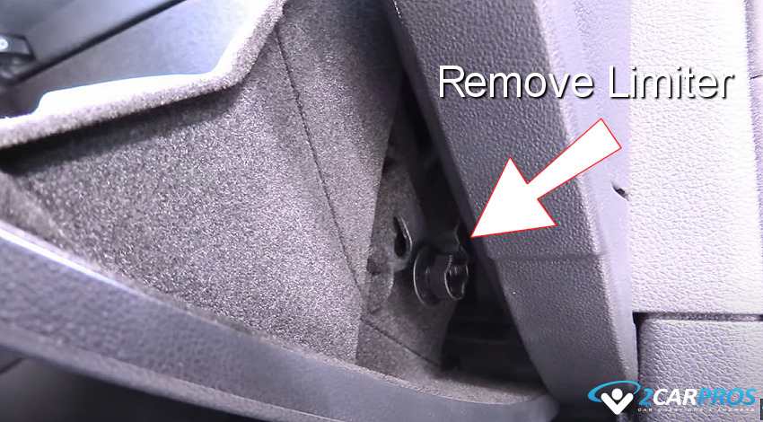

2. Open Glove Box: To access the cabin air filter start by opening the glove box and removing the contents, then locate the limiter strap which can be on either side of the door housing and disconnect, this will allow the door to fully swing open. Depending on your vehicle, it may drop down, or need to be removed entirely.
remove glove box limiter

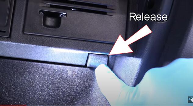

3. Release Glove Box Safety: There may be a glove box safety button that must be pushed inwards to allow the glove box lid to full extend downwards as well, simply push the button to release.

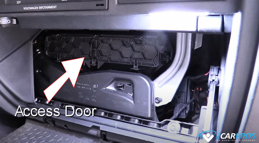

4. Access Door: With the glove compartment out of the way, you should see a rectangular cover which houses the cabin air filter.
cabin air filter access door

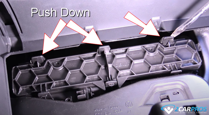

5. Open Access Door: Located the release tabs for the access door, or there might be small screws which will need to be removed. Push the tabs downward so the door swings open and exposes the filter element.

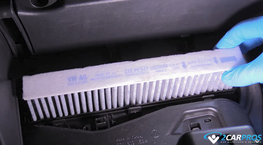

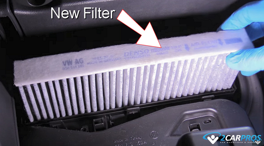

6. Replace Cabin Air Filter Element: Remove the old dirty filter, this will allow a vacuum cleaner to remove excess dust and leaves that may have made their way into the HVAC system. Note the orientation of the filter (usually indicated by arrows showing airflow direction). Install the new cabin filter and reassemble, you're all set, easy right?
install new automotive cabin air filter
