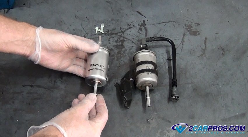

A fuel filter is designed to remove partials and contaminants from the fuel before they enter the fuel injection system. Most cars have one or two filters, the primary filter is located in the fuel tank attached to the inlet of the fuel pump and can sometimes be called a strainer. The secondary filter is located on the fuel pressure line headed from the tank to the engine and more specifically the fuel rail.
What goes wrong?
As with any filter when the capacity of the membrane is exceeded it diminishes flow capabilities. Restricted fuel pressure/flow equates to engine runnability problems such as low power, hesitation and hard starting.

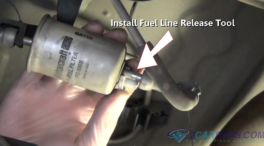

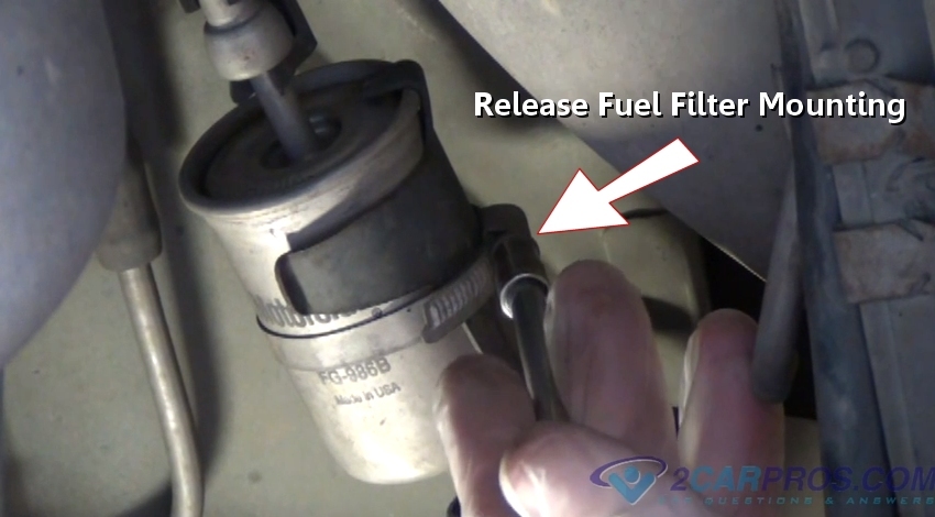

Use a line removal tool, line wrenches or hose clamp and loosen the fuel lines from the filter. Then remove the mounting clamp or bolts to free the filter from the vehicle.
Finishes removing the fuel lines keeping mind fuel will leak out.
Match the old fuel filter to the new filter and install. Most fuel filters will have a directional arrow which must point toward the engine.

Release or remove the fuel lines, fuel may drip out be ready with a small container or shop towel.
installing fuel line release tool
Remove the fuel filter mount.
release fuel filter

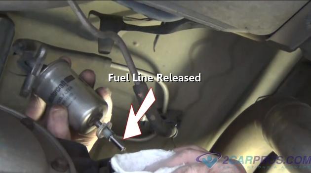

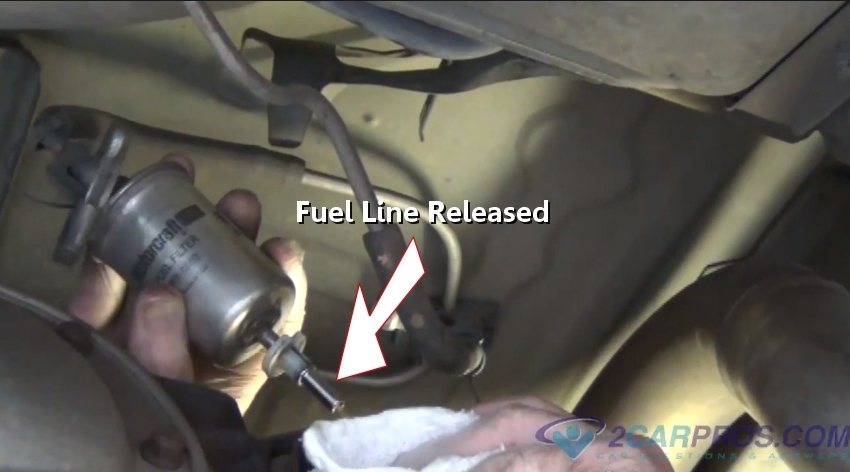

Once released pull the fuel line away from the filter, small amount of fuel will leak when line is removed, match and reinstall the new filter.
fuel line released
