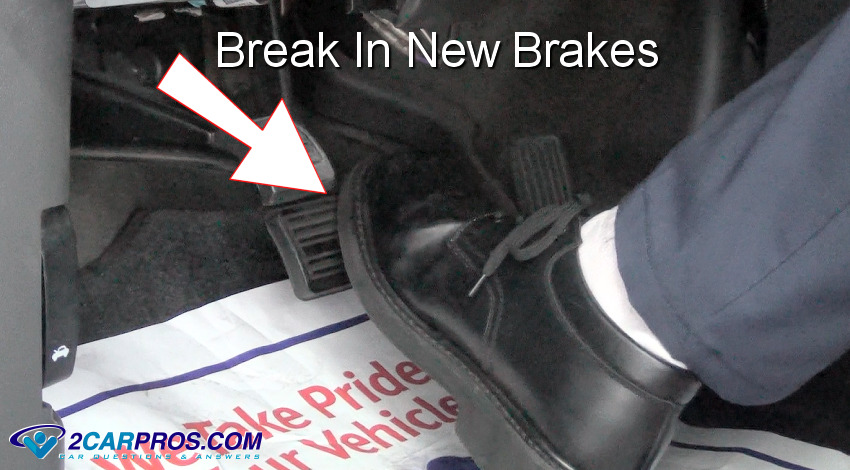

Gently push the brake pedal down (to the floor in most cases) to remove the air gap between the brake pads and rotors, repeat this process until normal brake pedal pressure has been achieved. If the brake pedal pressure is not present DO NOT DRIVE THE CAR, the brake job must be re-inspected to find problem or if a brake bleed is necessary.
After a brake service has been performed and the car is safety on level ground recheck the brake pedal operation. This should be done with the car running and in park to aid the power brake system. Perform the bedding-in procedure in a safe, controlled environment such as an empty parking lot or a quiet, low-traffic road.

Step 1: Once the you are ready to start driving the car move slowly while gently applying the brake pedal and releasing it. This will take the first layer of "peeks" off the pad and rotor surfaces while allowing the removed material to exit the area.
You must release the removed microscopic particles so they do not get imbedded back into the braking surfaces, this can cause future squeaking and uneven braking performance, (steering wheel shake).
Step 2: Gradually increase the speed of the car while making short slow downs and brake pedal releases as the peeks continue to wear flat. The more this process is done at slow speeds the better the brakes will work and improve brake life.
Step 3: Once you start to notice the brakes working better, increase the speed of the vehicle and repeat the steps of slowing and releasing to discard more of the break in material to further the mating of the pad to brake rotor union.
Step 4. Now, it is time to try a more aggressive stop, speed up to about 45 mph (70 km/h) and apply the brakes and repeat the slow down and release of the brake pedal, (do not come to a complete stop). This will heat up the brake components and prepare them for regular use.
After a few cycles it will help to create a smooth and even brake pad to rotor surface, and once the brakes have cooled they are ready for regular driving. (Note: Be careful not to brake too aggressively, this can cause the brakes to overheat resulting in uneven pad and rotor deposition.)
