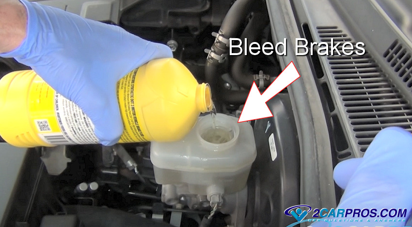

1. Fill Brake Fluid Reservoir: Make sure the brake master cylinder is filled completely with manufacturer recommended fluid, (Most brake systems use a DOT 3 or DOT 4 fluid). Before opening the master cylinder reservoir, use a shop towel to wipe it clean from dirt and debris, this will help keep the fluid free from contaminating which can cause brake component failure. (Note: void spillage, if you do accidentally spill, quickly use soap and water to wash the area clean). DO NOT allow the fluid to get low during this process.
brake fluid reservoir full master cylinder

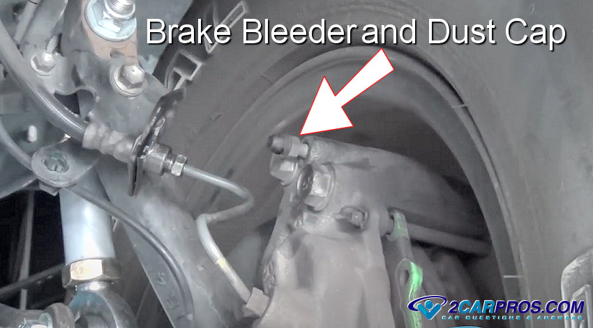

2. Brake Fluid Bleeders: Locate all four brake fluid bleeder fittings, which are near the top of each brake caliper or rear wheel cylinders and remove the dust caps, (if equipped). Here is an example of what a bleeder and cap will look like.
brake bleeder and dust cap

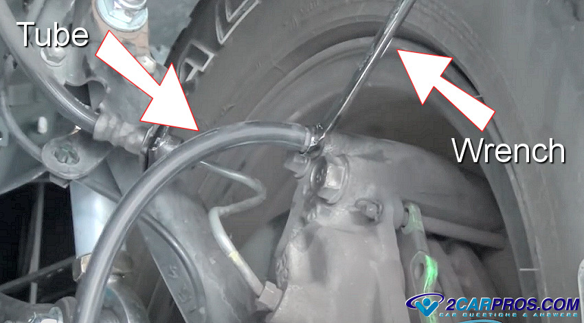

4. Crack Open Bleeders: Bleeder screws can be fairly tight, so apply WD40 or equivalent to aid in rust removal, (if needed) and use a 6 point socket (10mm) which is best to avoid stripping. Once broken loose, (not open) place a clear plastic tube or rubber hose onto the bleeder fitting and into a fluid catch basin. This hose is helpful to avoid brake fluid from getting onto the brake pads etc.
bleeder tube on brake caliper wrench

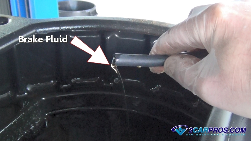

5. Start Bleeding Process: Starting one at a time, with the passenger rear, then driver rear, passenger front, and finally, the driver front, open the bleeder valve and call out to your helper to push the brake pedal slowly downward while holding even pressure, (Do not let up on the pedal). You will see fluid being forced out of the bleeder tube and into the fluid container, bubbles will stream out along with the fluid if air is present in the system.
brake fluid coming out of tube
6. Tighten Bleeder Screw: When the brake fluid flow stops, tighten the bleeder screw. Once tight, signal your helper to lift up on the brake pedal (slowly) until your foot comes off of the brake pedal pad. Repeat this process until air is no longer present in the fluid stream, this can take two or three times, complete the job by continuing onto the remaining three wheels.

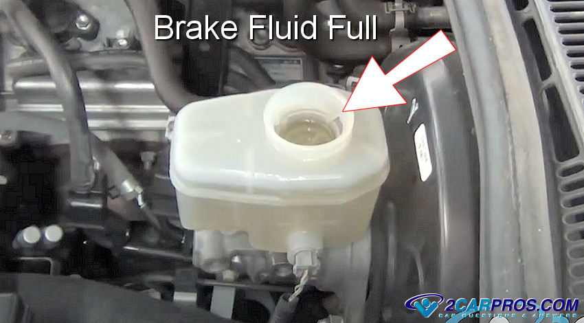

7. Re-Add Brake Fluid: While bleeding the system, observe brake fluid level in the reservoir and refill as needed to keep the master cylinder full. Do not allow the master to become empty or air will be pumped back into the system. Once the job is completed refill the brake fluid to the full line of the reservoir and reinstall the lid. Use a shop towel to wipe off any spilled fluid and rinse the area with water if needed.
