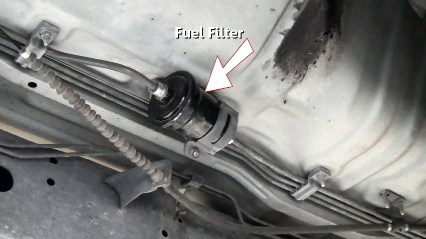

A secondary filter can be used to further clean the fuel. Some cars and most trucks have this filter (locations will very).
fuel filter

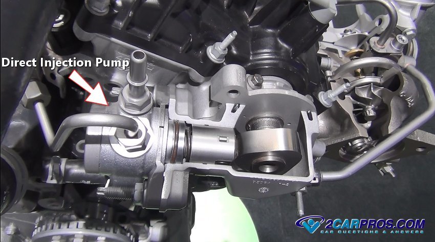

Direction injection fuel systems use a secondary mechanical pump to boost the pressure between 900 and 1200 PSI. This pump is driven from the engine camshaft and supplies high pressure fuel through steel lines to the injectors. This additional pressure is needed to push/spray fuel into the combustion chamber during the compression stroke.
direct injection pump

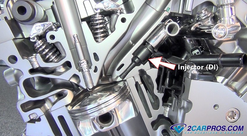

A direct injection fuel injector is mounted to the cylinder head opposed to a traditional system where the fuel injector is mounted to the intake manifold.
direct injection injector
The fuel injector nozzle is located inside the combustions chamber on DI systems.

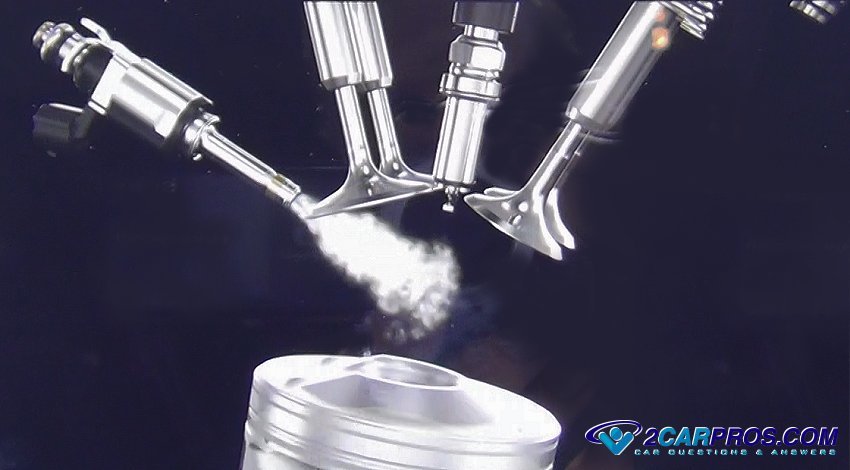

This is an example of what the fuel spray pattern looks like when in operation.
direct injection

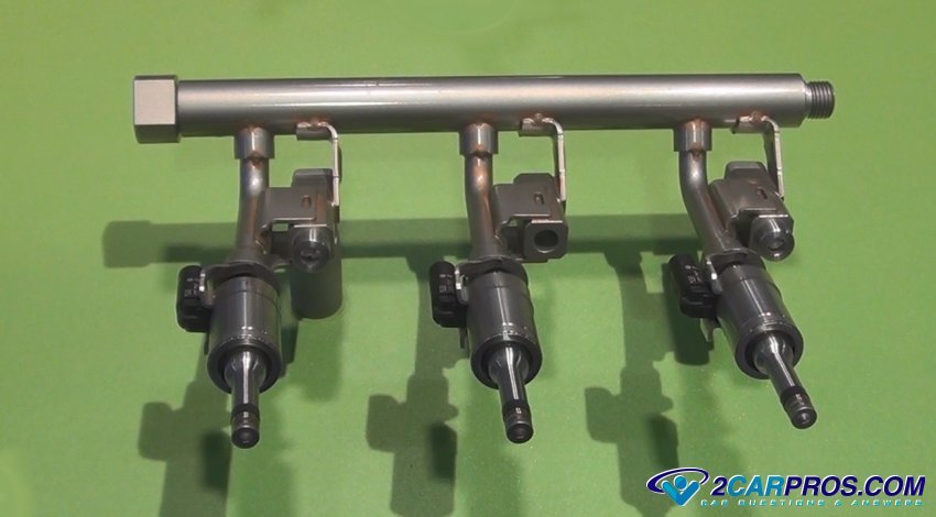

Fuel rails are used to distribute the fuel evenly to each injector in the system and are made of metal which contain O rings to seal the injector to the rail and cylinder head.
fuel injection rail

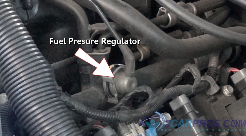

Older systems include a fuel pressure regulator which is located somewhere on the fuel rail and is controlled by engine vacuum via a small vacuum hose connected to the intake manifold.
