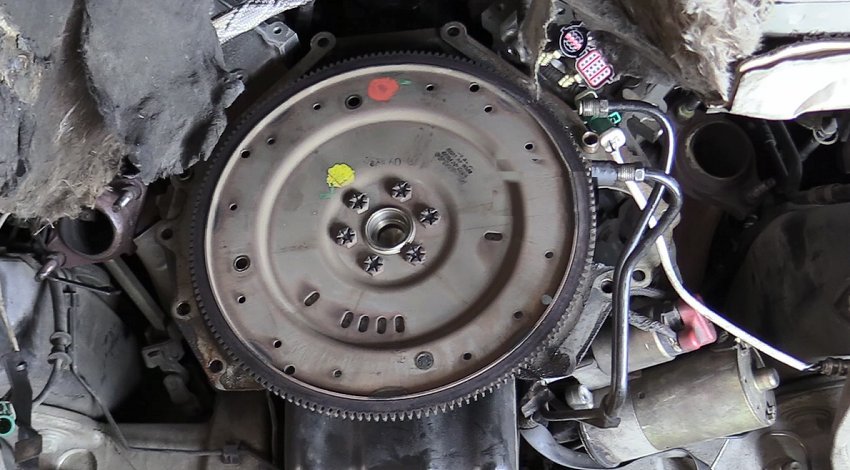

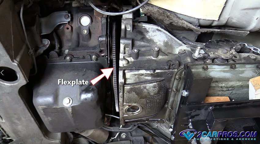

Here is the job of the flexplate sitting between the engine and automatic transmission. In this image you see the transmission being removed exposing the flexplate which is normally covered by the bell housing.
flexplate transmission

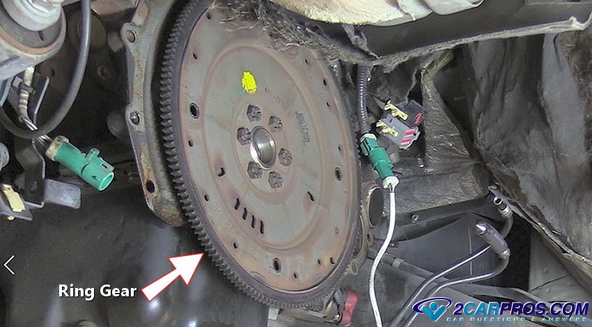

The starter motor uses a ring gear mounted to the flexplate designed to turn the engine over for starting.
ring gear
