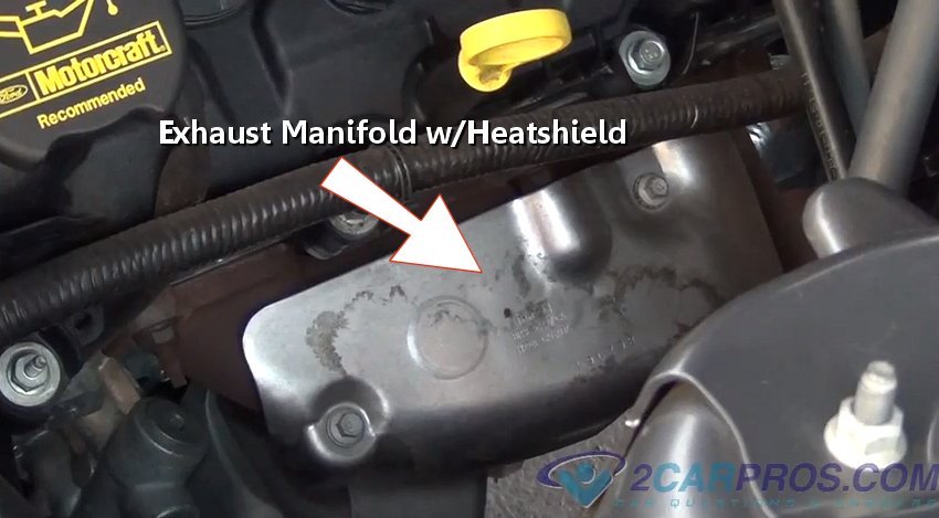

 Exhaust manifold and heat shield: Bolted to the cylinder head this part is first to receive the engine's exhaust. The heat shield is to protect against burns and damaging other components inside the engine bay.
exhaust manifold

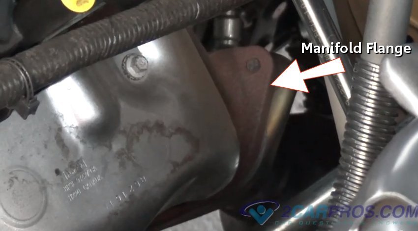

After collecting the gases the manifold funnels them into the manifold flange.
manifold flange

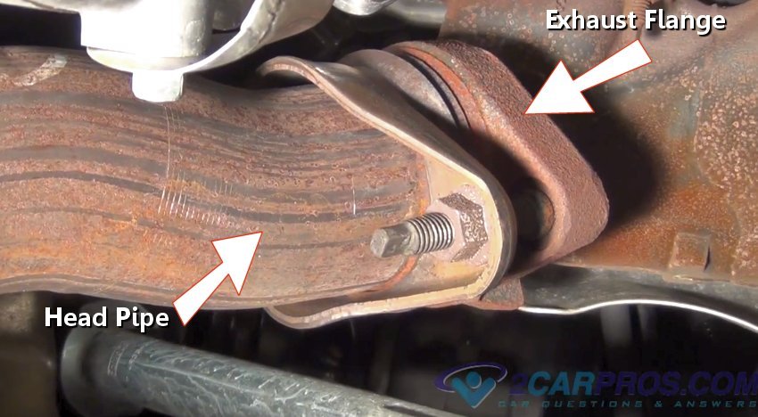

The head pipe bolts to the exhaust manifold flange.
head pipe flange

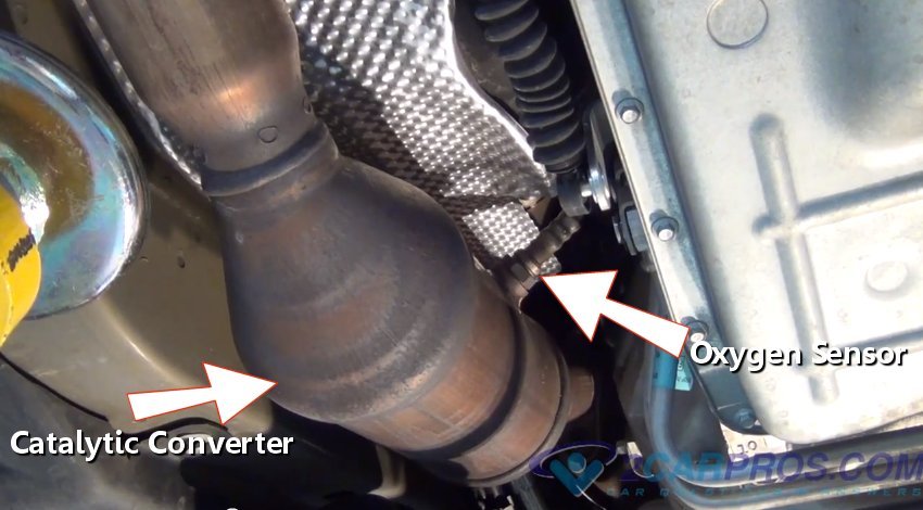

Exhaust gases travel to the catalytic converter which may house an oxygen sensor. The converter is also protected from the body using a heat shield.
catalytic converter oxygen sensor

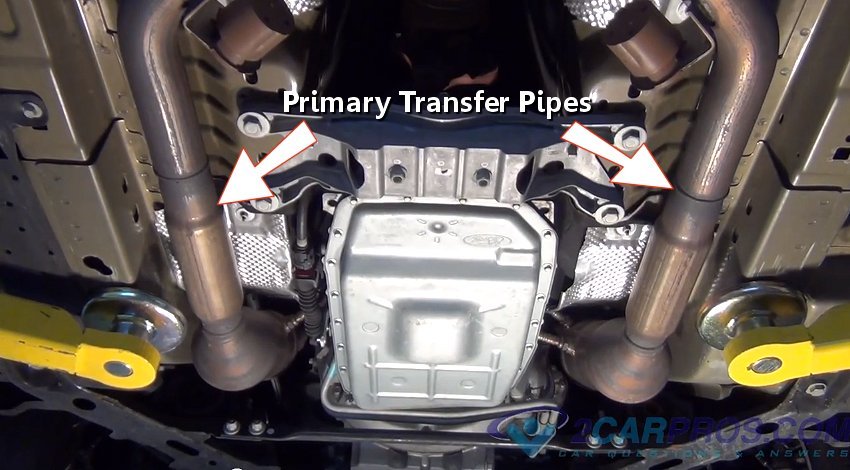

Once the gases are treated by the catalytic converter and read by the oxygen sensor they are released into the primary transfer pipes.

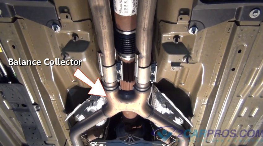

A backpressure balance collector is used to help equalize pressure which improves performance while restricting engine noise. (Note: Four cylinder engines are excluded from this device.)
balance collector

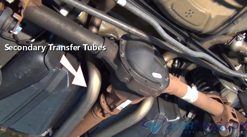

Once exhaust gases have been processed through the balance collector they travel down the secondary transfer tubes which route over the differential or axle.

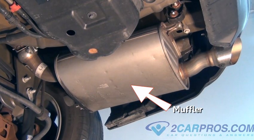

A muffler is used to help quite the engine noise. A secondary muffler is sometimes used and referred to as a resonator which increases the muffle affect.
muffler

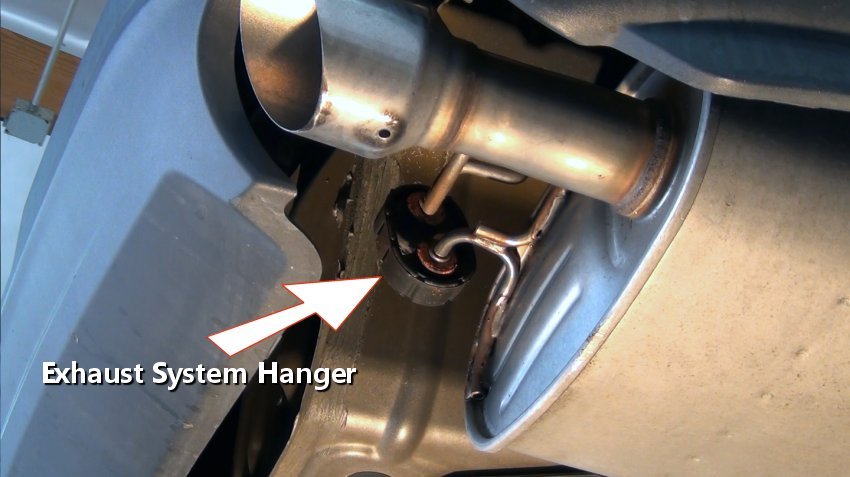

Rubber hangers are used to suspend the system while insolating engine vibration from the vehicle.
exhaust hanger
