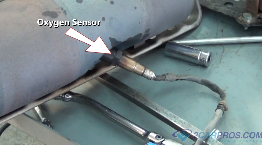

2. Oxygen Sensor
An oxygen sensor is designed to monitor engine exhaust gases and send this information to the main computer PCM so adjustments can be made to the fuel mixture controlling un-burnt fuel. Because these sensors are emerged in hot exhaust gases they have a high failure rate and must be replaced to keep the system working correctly.
oxygen sensor

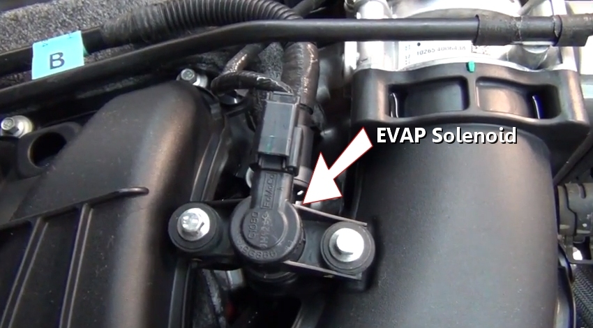

3. EVAP Control Solenoid
An EVAP solenoid is controlled by the main engine computer and located near the intake manifold. This solenoid is connected to the charcoal canister using a vacuum hose to draw raw gas vapor from the fuel tank and into the charcoal canister.
evap solenoid

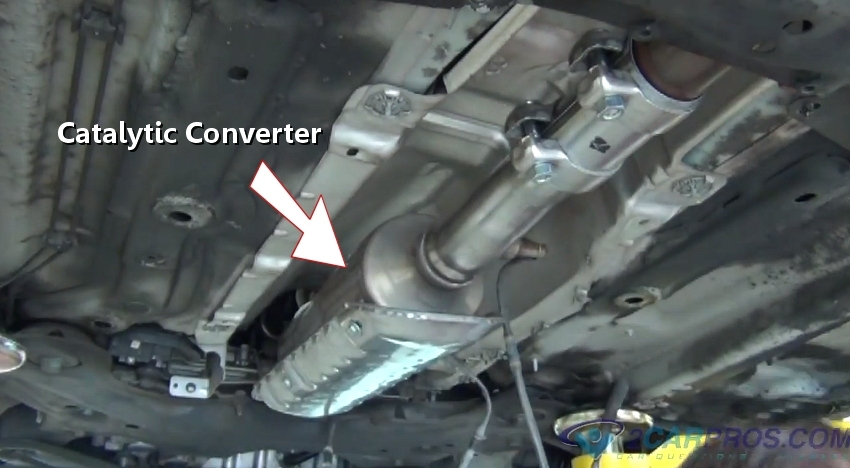

4. Catalytic Converter
A catalytic converter is designed to convert partially burned gases to completely burned gases. This is done when the converter becomes hot unitizing a thermo reaction due to the catalyst material inside the unit. Some cars use an electric air pump which injects air into the exhaust system just after the exhaust ports of the cylinder head to help heat up the catalyst and optimize efficiency.
cataytic converter

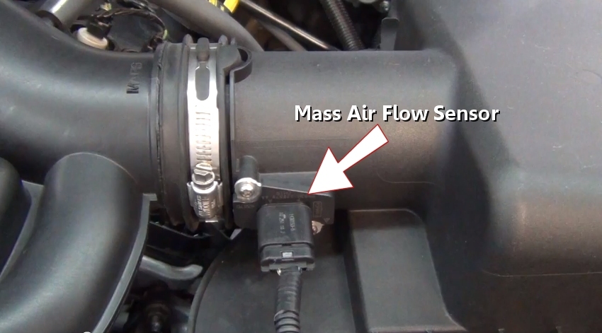

5. Mass Air Flow Sensor
A mass air flow sensor monitors airflow that enters the engine by measuring resistance across a hot wire that is cooled when different amounts of air pass over it. This feedback data trim adjustments to further help clean emission outputs by not allowing excess fuel to enter the engine during excessive throttle input.

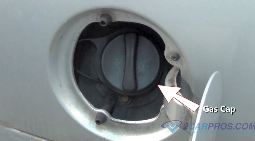

6. Gas Cap
A gas cap seals liquid fuel and fumed gases from escaping the fuel tank. This cap is designed with an automatic tightening mechanism to support the minimum tension the cap must be installed at while sealing against the tank filler neck using an O ring seal.
gas cap
