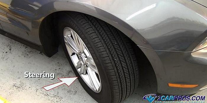

The steering wheel is used by the driver to control the vehicle which can either be connected directly to a steering box or rack and pinion. On some EV's the steering wheel is simply connected to a position sensor which, in turn, tells a computer which way to direct the front wheels and how far to move them via the electronic steering rack.
car steering wheel

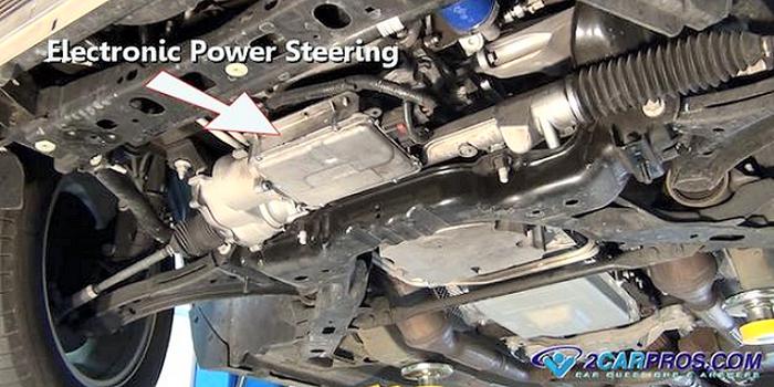

Designs include electronic steering controls which enable the computer to manage the control of the vehicle to help avoid accidents by using proximity sensors. This advanced steering system can also limit sudden movements by the driver at high speeds with the help of an YAW sensor to further avoid crashes.
electronic power steering

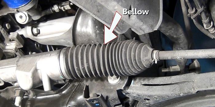

Rubber bellows are used to keep dust and dirt from affecting the steering operation, these items are typically for rack and pinion style of steering units.
steering rack bellow

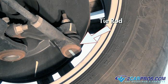

Tie rods are used to connect the spindles (where the tires are mounted) to the steering assembly, this rod end is filled with lubricant which helps the pivot points stay in good working order. A tie rod end is also fitted with a dust cap to keep dirt from getting into the joint.
tie rod end

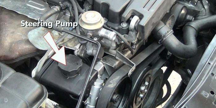

Power steering systems assist the driver's effort by using a hydraulic pressure pump mounted to the engine which is driven by a serpentine belt. The image below shows what a typical power steering pump looks like. The fluid in the system is held under pressure until the wheel is turned which releases the pressure assisting in the steering action. This pump only provides steering assistance when the engine is running.
steering pump

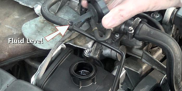

These hydraulic systems must maintain proper fluid levels to operate correctly, if fluid levels fall below minimum requirements the system will howl and moan while air mixes with the fluid, this condition can also lead to hard steering and pump failure. Levels should be checked at each service interval, fluid leaks are common in these systems such as a pressure hose rupture.
steering fluid level
