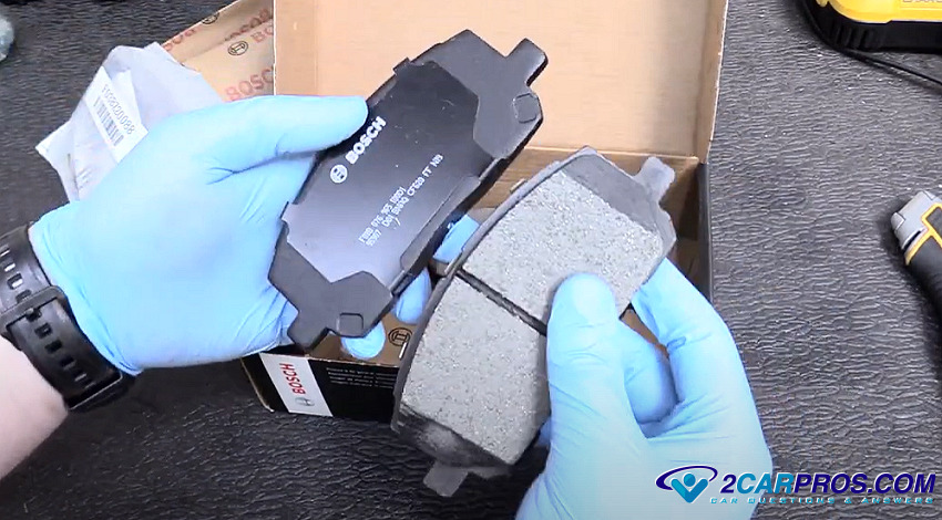

Construction
Brake pad backing plates are made of metal, there are several different classifications of the brake pad composites for example; organic, semi metallic and ceramic to name a few, the organic pad is used mainly for stock applications. The semi metallic is used for trucks and SUV's while the ceramic pad is used for extended life applications. Each of these pads possess individual wear and usage characteristics for example; organic pads are the most forgiving pad when it comes to brake rotor wear and tend to make less brake noise such as squeaking and grumbling.
Semi metallic pads tend to be more abusive to the rotors but can take more heat then organic pads before brake fade occurs. Ceramic pads are the hardest pad of the group and can wear out the rotors over the life of the brake pad. The advantage of the ceramic pads is the lifespan of the brake pad set is about 20% longer than a regular brake pad. Every brake pad manufacturer has their own mixture of composite material that can vary in cost and quality. This material is bonded or riveted to the pad's metal backing plate.
