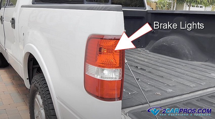

  • Brake Lights: The bulbs or LEDs located at the rear of the vehicle that illuminate to signal braking.

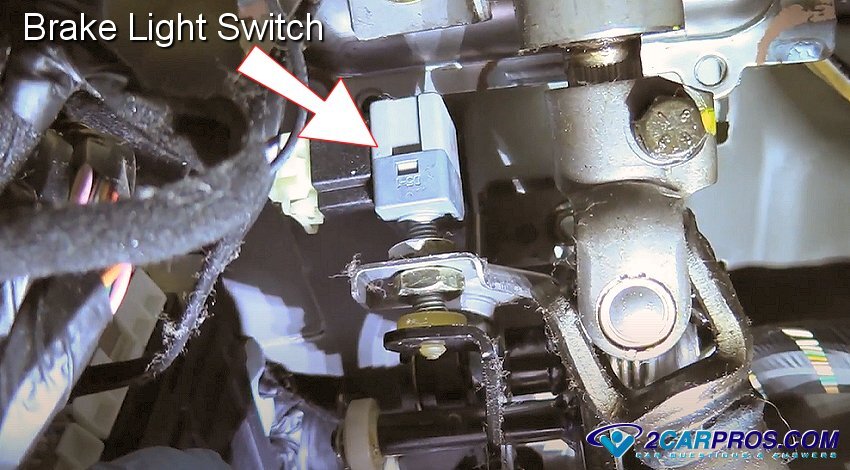

1. Everything begins with the brake light switch, when the driver of the car decides to slow down or stop the brake pedal is pushed which activates the brake light switch that connects the circuit that activates the brake lights. This control switch is located under the dash at the upper end of the brake pedal arm and is a low amperage "trigger" switch that simply connects the signal to tell the BCM (body control module) or LCM (lighting control module) to turn the brake lights on, older cars do not use a BCM or a LCM. Note: This brake light signal is used for ABS and traction control systems as well.

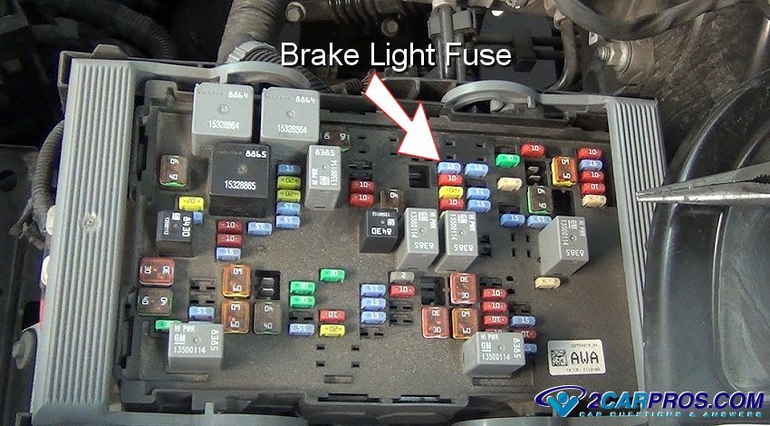

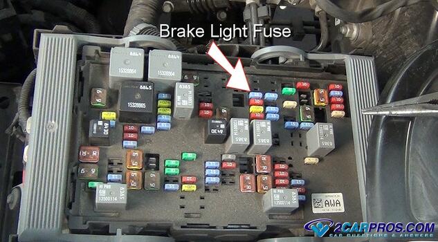

3. A fuse or series of fuses are used to protect the wiring and computer circuits in the event of the short in the wiring or lighting socket. These fuses can be located in the PDC under the hood or in the interior fuse panel which is usually under the dash on the drivers side.

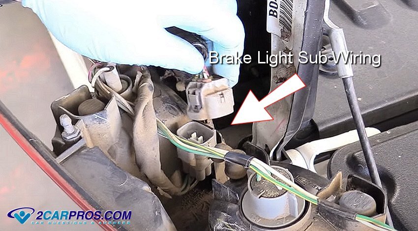

4. A brake light wiring harness is used to transfer the voltage from the firewall of the vehicle to the rear lighting systems, this harness is routed along the frame in a safe manner as to not come in contact with moving or rotating parts such as a driveshaft. There can also be a sub harness form the brake light lens which is plugged into the main wiring harness.

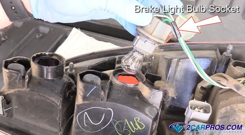

5. Light bulb sockets are spring loaded and are used to hold the brake lamp in place while providing a good power and ground connections. Some vehicles use a multi bulb plate which holds the running light, reverse light and brake light bulbs together.

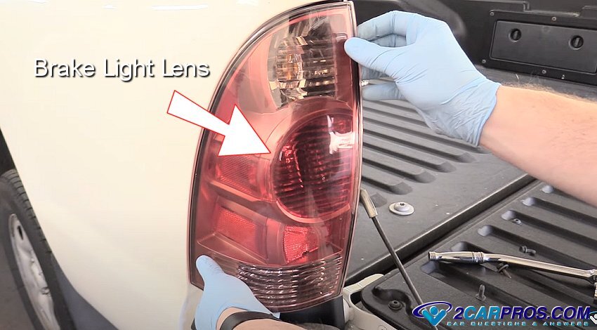

6. This bulb is fitted inside the brake light lens which is then mounted the vehicle via mounting screws. The lens is used to amplify the light source form the bulb when illuminated for better visibility.
automotive brake light lens
