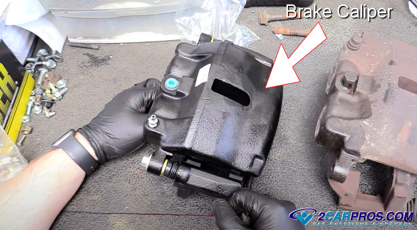

This guide provides a highly detailed and technical step-by-step explanation of the operation of an automotive brake caliper. A brake caliper is designed to utilize brake fluid under pressure to transfer hydraulic force from the brake master cylinder to the brake pads. The brake pads then contact the rotating brake rotor to slow the car down through friction. A brake caliper is typically mounted into the caliper mount which embodies two caliper slides allowing the caliper to "float".
There are two basic designs of brake caliper mounting, fixed and floating. A fixed position brake caliper is bolted to the mount and is not allowed to move. This kind of design is constructed with one or more pistons on either side of the caliper. The floating style of caliper, which is more common is mounted to the caliper mounting bracket using slide bolts which allow the caliper to "float" as the brake pads wear, this design uses a piston on the inboard side of the caliper. Brake calipers can have from 1 to 6 pistons depending on the manufacturer's design.
All brake calipers are fitted with a brake fluid bleeder near the top which allows air to escape from the brake system. If air is allowed in the system it can cause a spongy brake pedal or low brake pedal. A brake caliper piston is sealed to the brake caliper housing using a main piston seal. This seal allows the piston to move back and forth without allowing brake fluid to leak and is protected by a dust seal that helps keep debris from contaminating the integrity of the main seal.

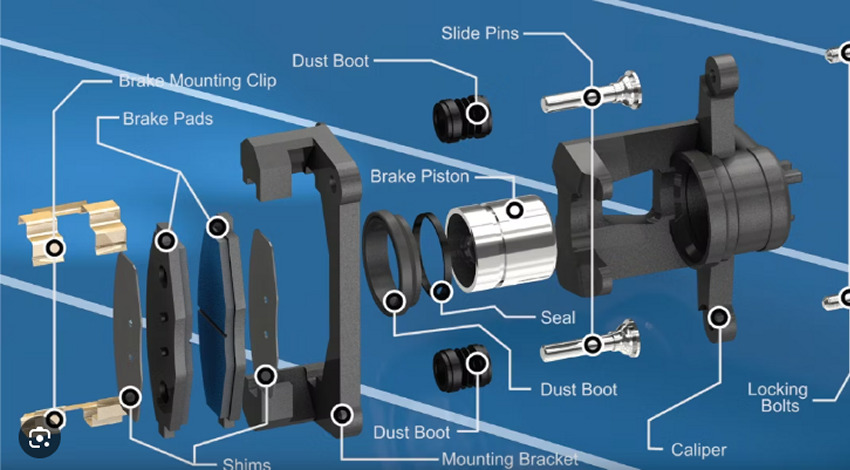

A typical brake caliper consists of the following components:
  • Caliper Housing: The main body that holds the other components. It is typically made of cast iron or aluminum.
  • Pistons: Cylindrical components that push the brake pads against the rotor. They are usually made of steel or aluminum.
  • Brake Pads: Friction materials that contact the rotor to create braking force.
  • Brake Fluid Channels: Pathways through which brake fluid flows to and from the pistons.
  • Bleeder Valve: A valve used to remove air from the brake fluid system.
  • Seals and Dust Boots: Components that keep contaminants out and brake fluid in.
Here is an exploded view of a typical automotive brake caliper.
automotive brake caliper exploded view
