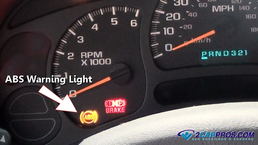

An ABS (antilock brake system) and traction control systems are closely related, this is why when one system has a problem, so does the other while illuminating both warning lights at the same time. If the ABS or traction control warning lights are on the system is disabled compromising the safety of the vehicle. While all car manufactures seem to agree on the brake portion of the safety system, ABS, each of them have a different name for the traction control portion:

abs and traction control warning lights

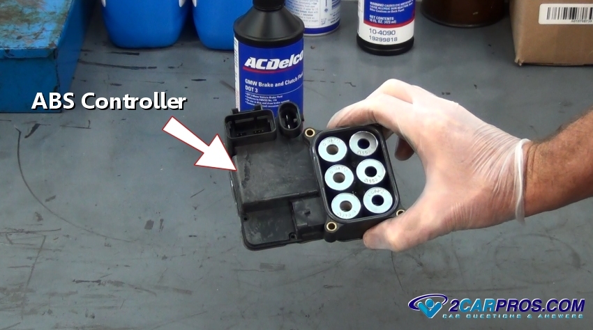

The ABS and traction control system utilizes an electronic control unit, which is comprised of solenoids which together with the valve module can modulate or increase brake line pressure to a particular wheel. This will allow tire rotation when skidding, or add pressure to stop the tire from slipping (excessive acceleration).
abs control module

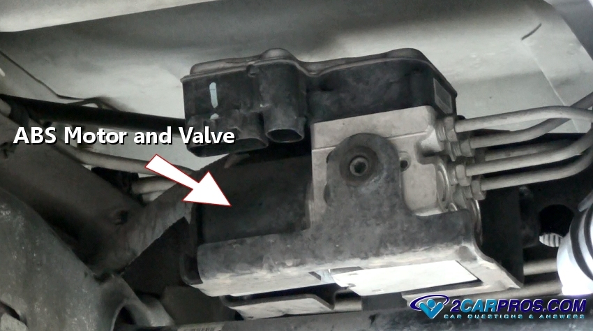

Usually the ABS and traction control unit will be mounted to the motor and valve assembly, either under the hood or on the frame rail depending on the manufacturer. The valve block is where the brake fluid enters from the brake master cylinder and then exits to each wheel individually.
abs pump motor and valve block

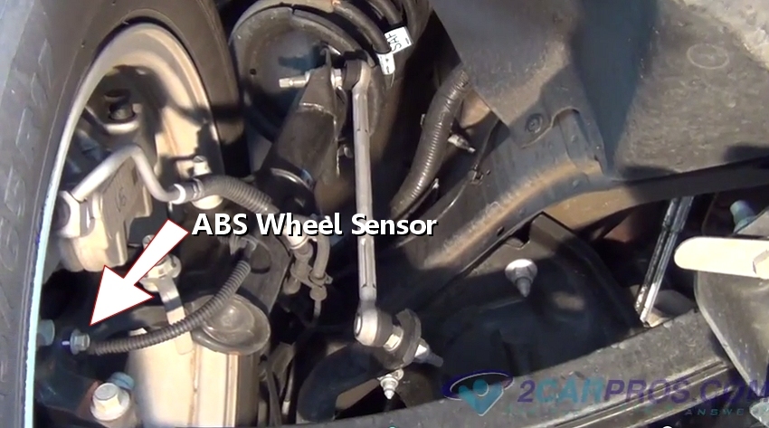

Wheel rotational speed sensors are used at each wheel, though some systems only use one rear wheel sensor that is mounted to the center of the rear differential. These sensors are located near the center of the rotating mass to give feedback data to the ABS/Traction Control module. Also, these sensors can be integrated into the wheel bearing hubs, when these bearing go out it can cause an ABS/Traction Control warning light.
abs wheel speed sensor
