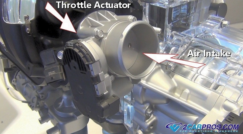

Here is a what a throttle actuator looks like on a 2019 vehicle which shows the air intake path, you can see the butterfly is closed, normally you cannot see this part when the air intake tube is installed.
throttle actuator

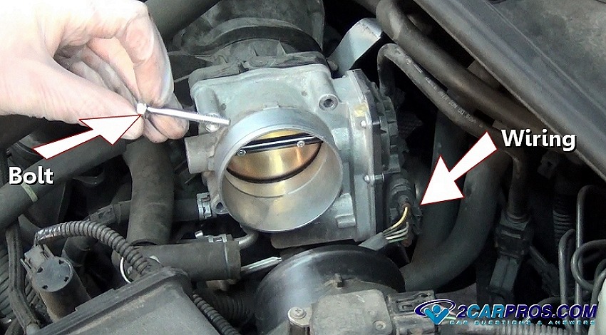

A throttle actuator is held to the intake manifold using three or four bolts sealed with a gasket. A computer wiring harness connector is plugged directly into the throttle actuator motor. A throttle position sensor (TPS) provides the throttle butterfly position data for the computer.
throttle actuator bolt wiring

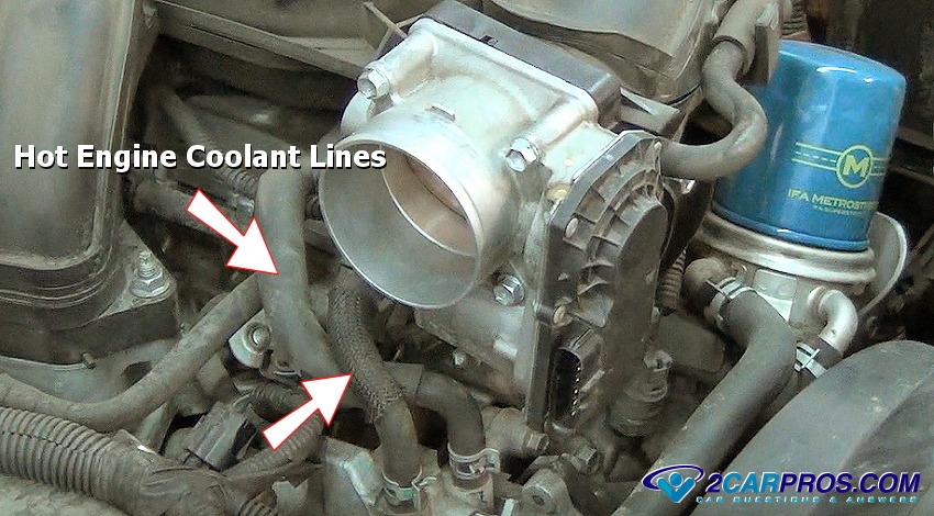

Manufacturers will sometimes run hot engine coolant through the throttle bore to help heat up the intake air to improve fuel economy.
hot coolant lines

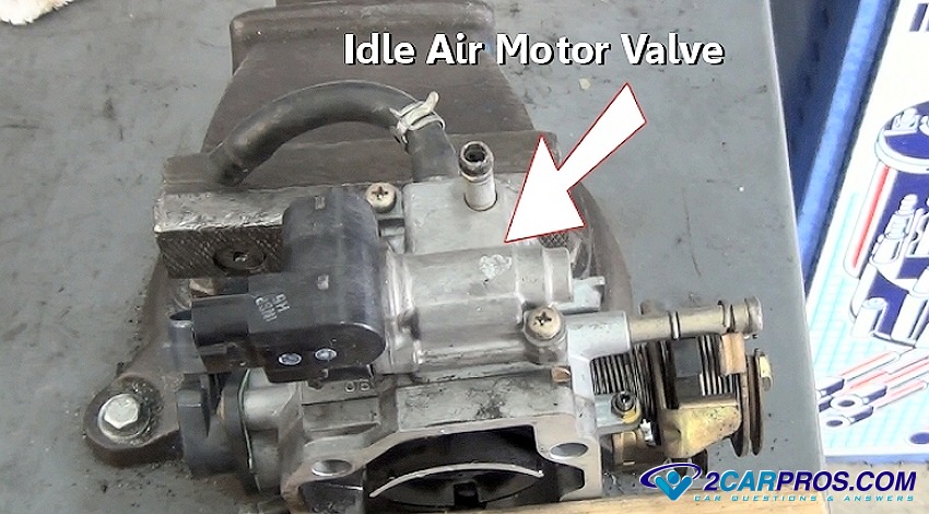

A throttle body is used on vehicles older than 2001-2005 (in general) and have a throttle cable connected to the gas pedal to open and close the actuator. This configuration uses an idle speed motor to control engine speed at idle via the computer program, there are no manual adjustments on a throttle bore, it is completely controlled by the engine computer. In the image below it shows what an idle air control valve looks like on a Toyota.

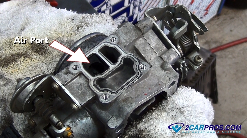

Air bypass ports are designed onto the throttle bore (idle air valve removed) which facilitate engine idle speed adjustments from the computer.
throttle bore air ports
