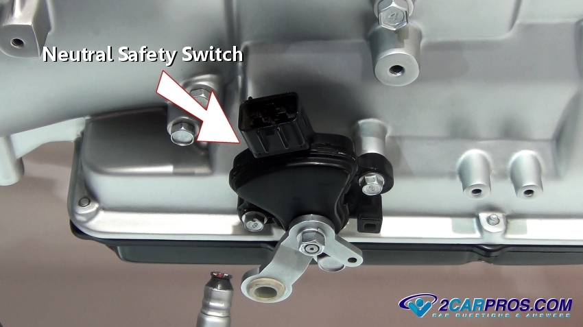

Identify the neutral safety switch which is located on the left side of the transmission and controls engine starter operation along with reverse lights and gear selection feedback data used by the computer.

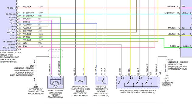

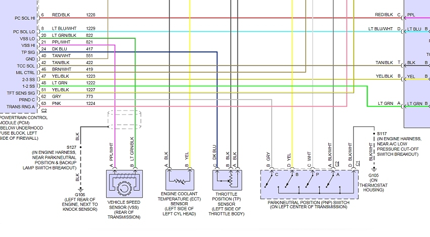

Obtain a wiring diagram used to trace wires which enables continuity testing. This switch uses a simple grounding procedure to individual circuits when the switch is activated. Search Google images or an online service manual such as Mitchell1 to obtain such diagram.
wiring diagram neutral safety switch

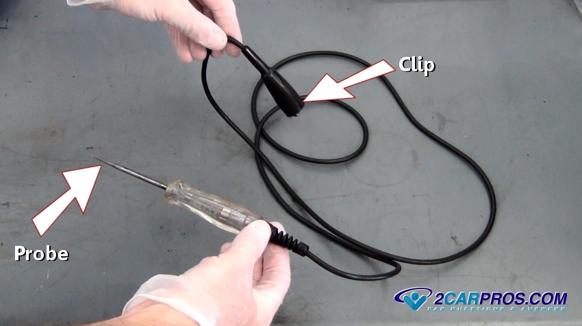

Using a test light will enable the circuit testing by piercing the wires to confirm a connection through the switch.
test light
