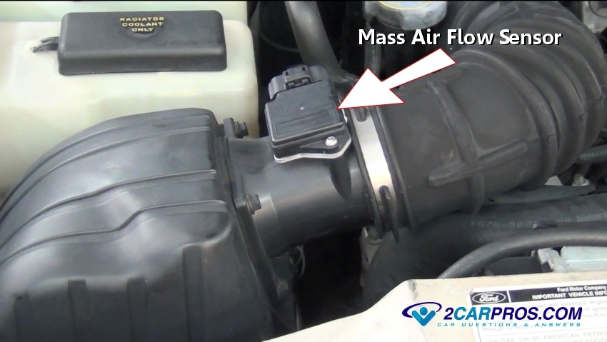

Step 1 - The mass air flow sensor is designed to monitor the volume of air passing into the engine at any giving time (located in the intake tube connected to the throttle body) this information is then transmitted to the computer for calculations while helping adjust fuel injector input and ignition timing settings.

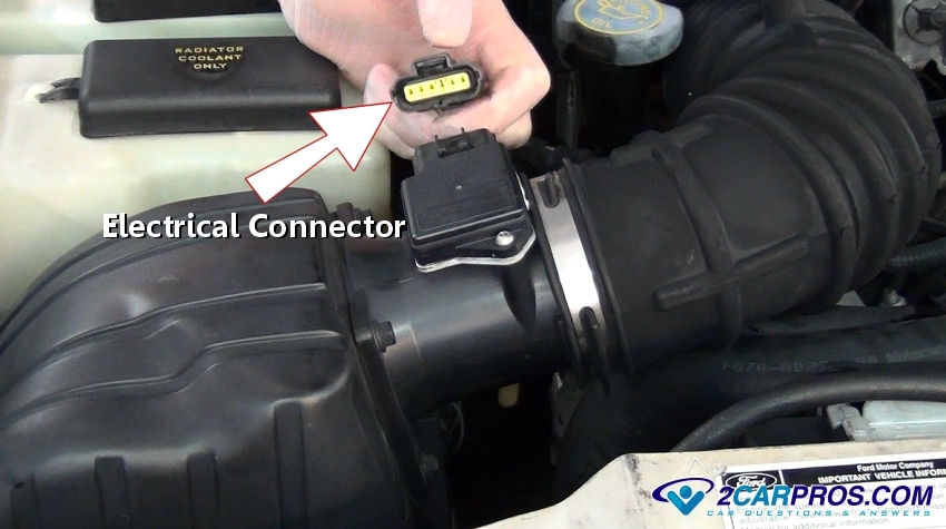

Step 2 - All maf sensors include an electrical connector which is used to transfer data to the computer.
mass air flow sensor connector

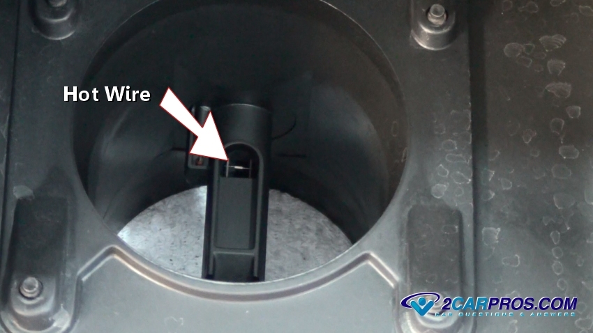

Step 3 - A hot wire is used to detect air flow by measuring the resistance change as varying amounts of air are passed over it.
maf hot wire

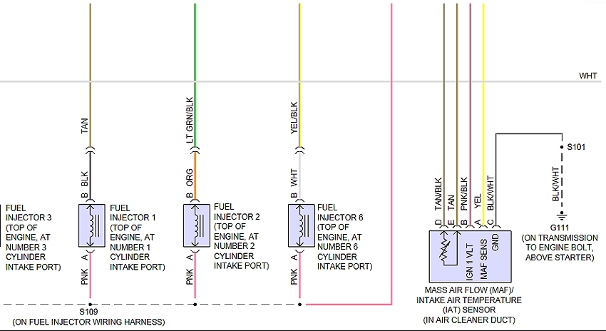

Step 4 - Sensor wiring diagrams are used to help troubleshoot electrical problems.
mass air flow wiring diagram
