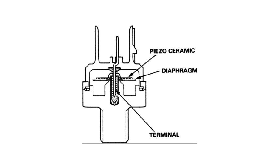

Step 1 - A knock sensor, which is located somewhere on the engine block is designed to detect engine combustion knock. This sensor performs this duty by utilizing a temperature sensitive diaphragm which is surrounded by piezo ceramic. Once the sensor has been activated it sends feedback data to the PCM (computer) which in turn uses this information to make adjustment to ignition timing and fuel consumption properties. This sensor helps the engine run at maximum performance and economy while safeguarding it from detonation or pre-ignition (ping) which develops when combustion temperatures reach maximum levels.
knock sensor cutaway
