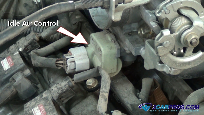

Step 1 - The idle air control valve is located on the throttle bore (in most cases) and is designed to adjust engine air intake at idle which controls the engine idle speed. The PCM receives feedback data from various sensors to send output signals designed to adjust the air passage open or closed which adjusts the engine idle speed. At engine speeds above idle, the valve is not used and does not effect the engine. Engine idle speeds are not adjustable.

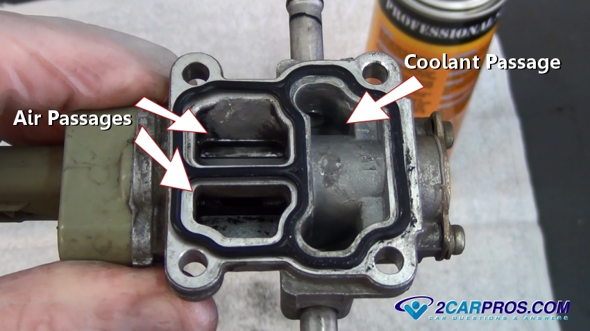

Step 2 - Internal air ports are used to regulate the volume of air allowed to pass through the valve. Some valves feature a coolant passage used to heat the valve for improved economy. These ports are sealed using a gasket which prevents the valve from leaking.
air passages

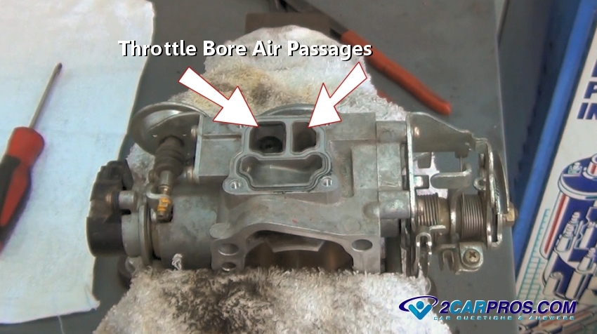

Step 3 - Air passage bypass ports are used to route air past the butterfly and through the idle air control valve.
throttle bore air passages

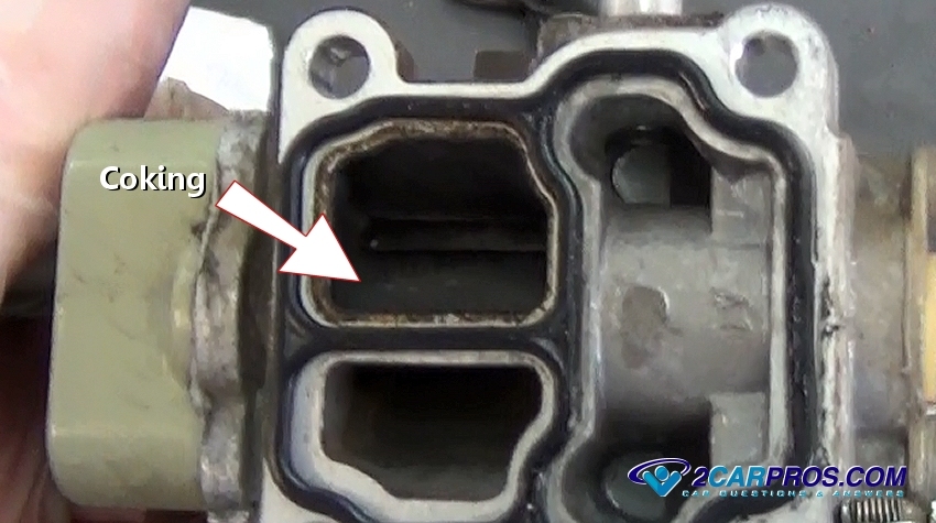

Step 4 - Because of the massive amounts of air processed through the valve a condition called "coking" develops which can inhibit proper operation of the valve. This valve should be cleaned (serviced) whenever a tune up is performed.
coking
