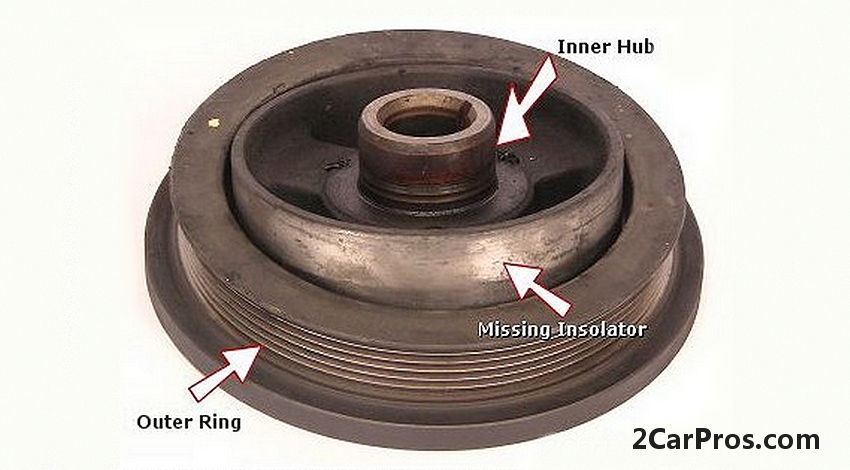

 A harmonic balancer consists of two separate pieces, the first is the mass which is bolted to the crankshaft shout and the second is the energy dissipating element which is separated by a rubber insulator.  Due to the stress and strain that is placed upon the harmonic balancer the unit can sometimes crack or separate. If the front main seal fails it will cause an oil leak which can only be replaced by removing the balancer. In the image below a balancer has completely come apart and is missing the rubber insulator.
failed harmonic balancer
Failed Harmonic Balancer

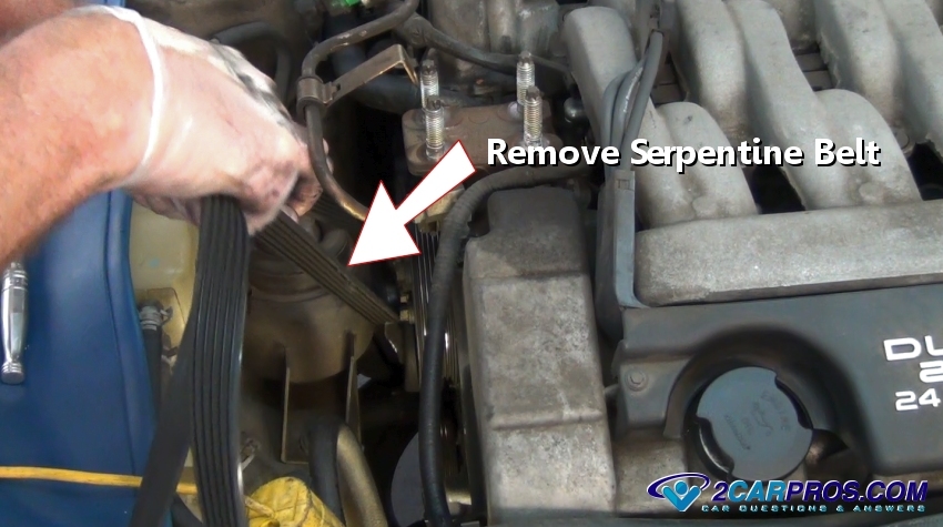

First remove all plastic shields that block access to the balancer if any and then release to belt tensioner to remove the serpentine belt. At this time check the belt condition in case replacement is required during the job.
remove serpentine belt

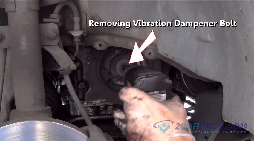

Some cars have a pulley which bolts to the front of the balancer which must be removed before the crankshaft bolt can be removed and the puller installed. Here we use an air impact gun to help make the job easier. It can also be removed conventionally but the engine must be held from turning over via the flywheel starter access port.
remove vibration dampener bolt

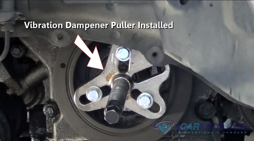

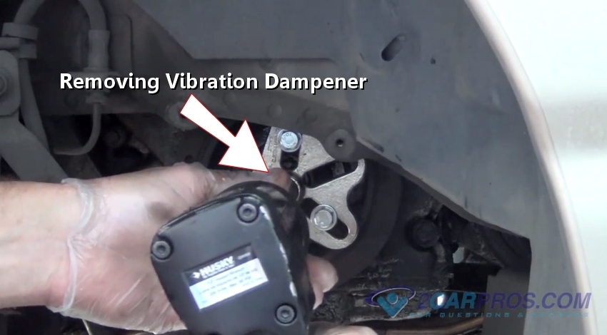

Below is a balancer pulley mounted using three bolts (evenly) and washers. You want to install the bolts in far enough to hold properly when the puller is being used. It's a good idea to install a small amount of grease onto the threads of the puller to aid its operation. (Note: Some dampeners are not a press fit and can be removed without a puller.)
vibration dampener puller installed

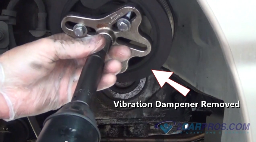

With an air impact wrench tighten the puller, you may hear a small pop as the dampener starts to move off of the crankshaft, this tells you the puller is working.
removing vibration dampener
The puller push bolt will become easier as the balancer comes off the end of the crankshaft. When the balancer becomes free keep your hands on it because it can be heavy.
vibration dampener removed

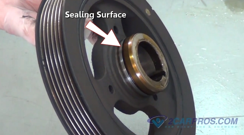

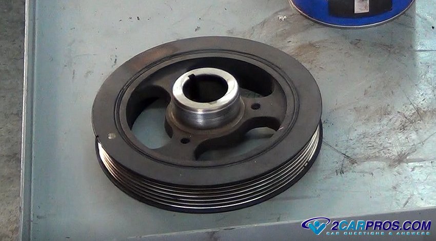

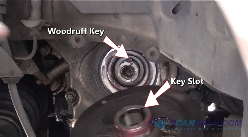

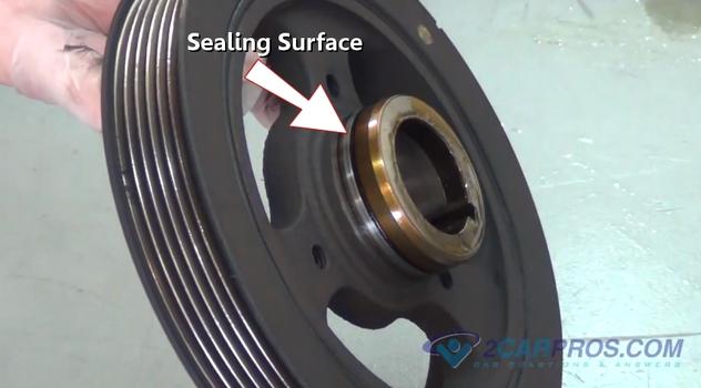

Once the dampener is removed, there may be a oil varnish deposit on the front sealing surface which will need to be removed with carburetor cleaner or fine sandpaper before re-installation. Always check the condition of the woodruff key slot, if the balancer was loose this will be damaged.
dampener sealing surface

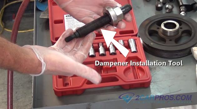

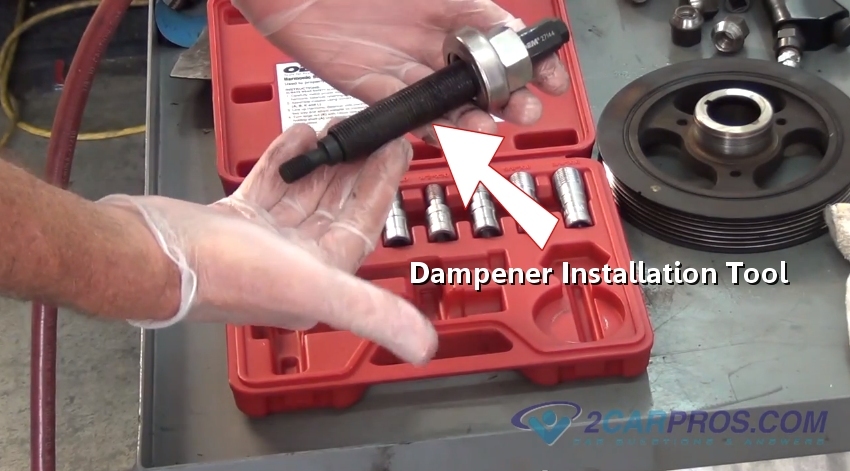

Below is a harmonic balancer installation tool is used to reinstall the balancer. Never hammer the balancer back onto the engine, crankshaft thrust bearing damage will result.
dampener installation tool

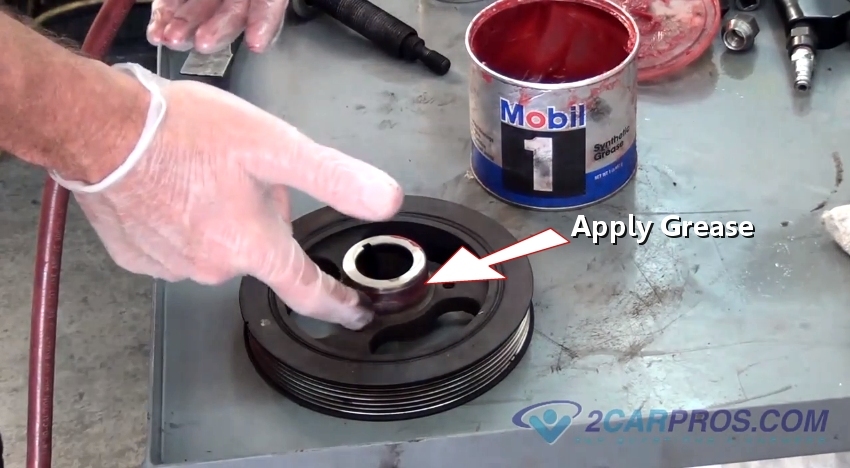

After any repair work has been completed such as a front main seal warm the balancer in an oven to 190° F to help expand the dampener to ease installation. Then install a small amount of grease to the sealing surface of the balancer.
apply grease
Align the balancer woodruff key slot with the keyway on the crankshaft and set into place. The balancer hub will slide on a small amount and hold onto the crankshaft snout.
woodrough key

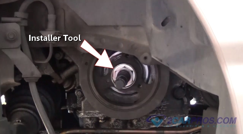

Install the balancer installation tool, again a small amount of grease on the tool threads will help the process, wind the installation tool into place.
installer tool
Use two wrenches to tighten the balancer installation tool by holding the screw and tighten the large jam nut, continue this process until you no longer feel the balancer moving inward.

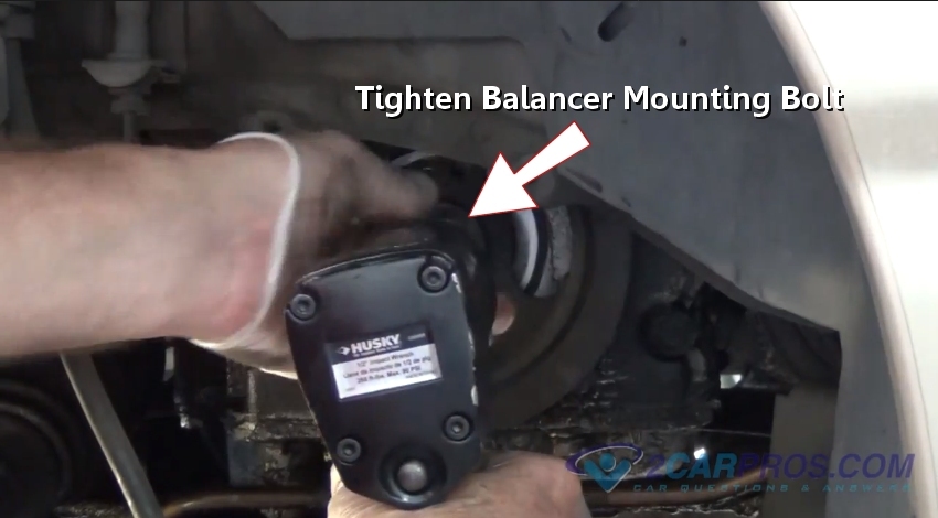

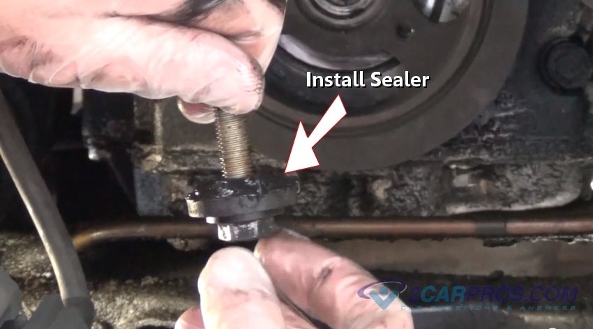

Once the installation tool has been removed, apply sealer to the center bolt and install, this is to help stop oil leaks.
install sealer bolt
Tighten bolt to manufacturer's recommended torque specification, (130 to 150 pounds usually)

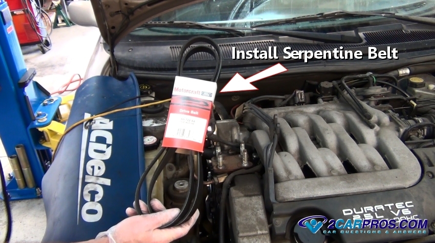

Finish the job by installing a new serpentine belt (if needed) and then start the engine to check for any fun noises or oil leaks.
reinstall belt
