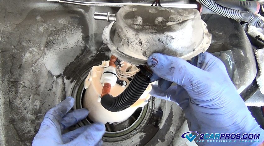

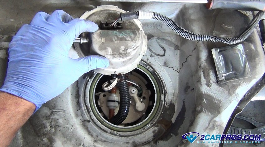

Here is a fuel pump inside the fuel tank after the tank and the service cover have been removed.
fuel pump in tank

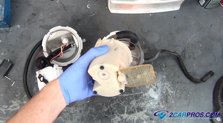

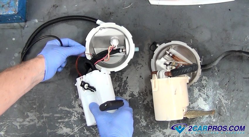

Here is the fuel pump being removed for inspection, notice the fuel line and electrical wiring connecting the pump and level sensor.
fuel pump removed
This shows you the primary fuel filter attached to the inlet of the fuel pump.

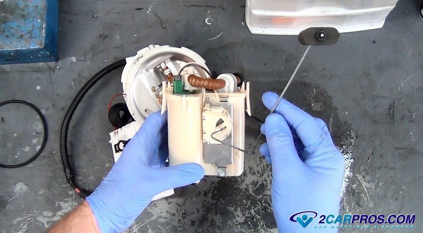

The fuel level sensor it mounted to the body of the fuel pump which features a resistor that adjusts as the fuel level rises and falls.
fuel gauge float

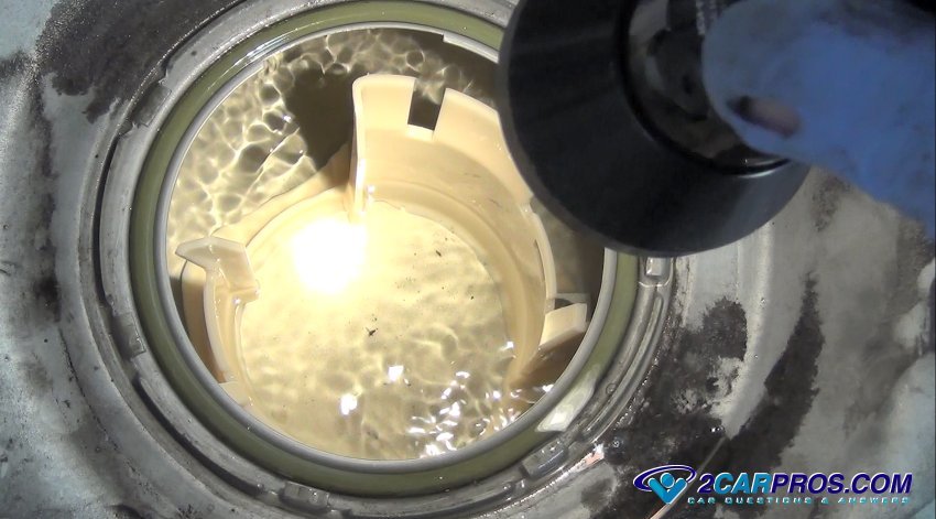

A fuel sump is used to keep the pump in place while helping to corral fuel toward the pump when levels are at a minimum.
fuel pump sump
