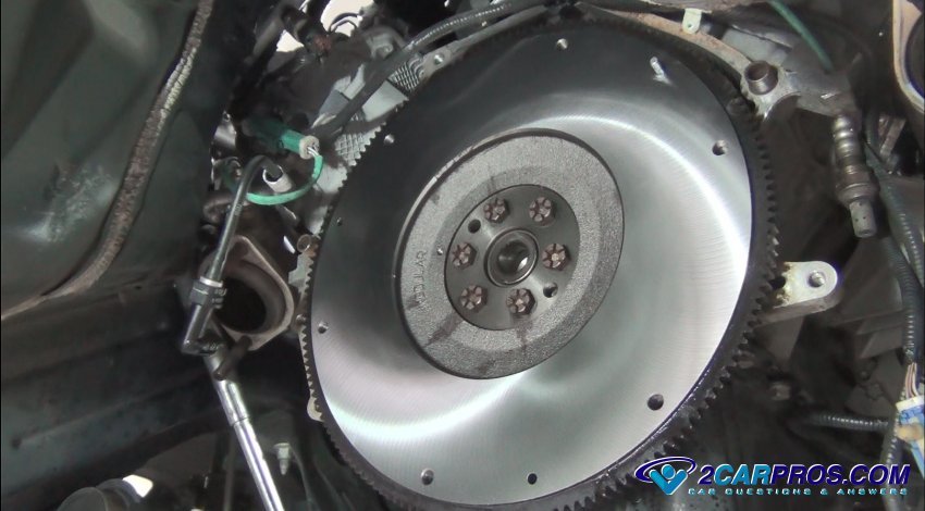

engine flywheel
Engine are designed with a flywheel or flexplate depending which will be determined by the transmission type i.e. Automatic transmissions use a flexplate while the standard transmission uses a flywheel. Both do essentially the same thing the only different being the flywheel will have a clutch assembly mounted to it while the flexplate will have a torque converter bolted to it. Both are attached to the engine crankshaft and help balance the engine for smooth operation and also both feature a ring gear for the starter motor to operate. Dual mass flywheels have an extra layer that sits between the surface of the clutch disc and the body of the flywheel which can move slightly which helps for smoother shifting, the input shaft of the transmission is fitted into this layer.

Flywheel
  • Helps balance the engine
  • Features a ring gear for the starter
  • Holds the clutch assembly
  • Bolts to the engine crankshaft
How does it work?
The flywheel is bolted and turns directly with the crankshaft acting as a solid coupler to join the power output of the engine and transfer it to the transmission input shaft. The flywheel also acts as an agent to help start the engine via the starter motor. A flywheel is "timed" to the crankshaft and can only be bolted up one way. This is achieved by offsetting the bolt pattern helping preserve the engine balance when running. When replacing a flywheel mounting bolts should to be tightened to manufacturer's specifications to preserve the flywheel integrity.

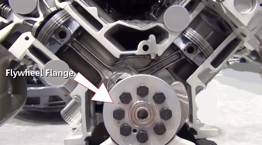

Here is the flywheel mounting flange featured on a cutaway block. In the center of the crankshaft is a pilot bearing used to support the input shaft of the transmission.

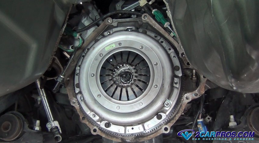

This is what a clutch looks like when mounted to the flywheel
clutch mounted flywheel

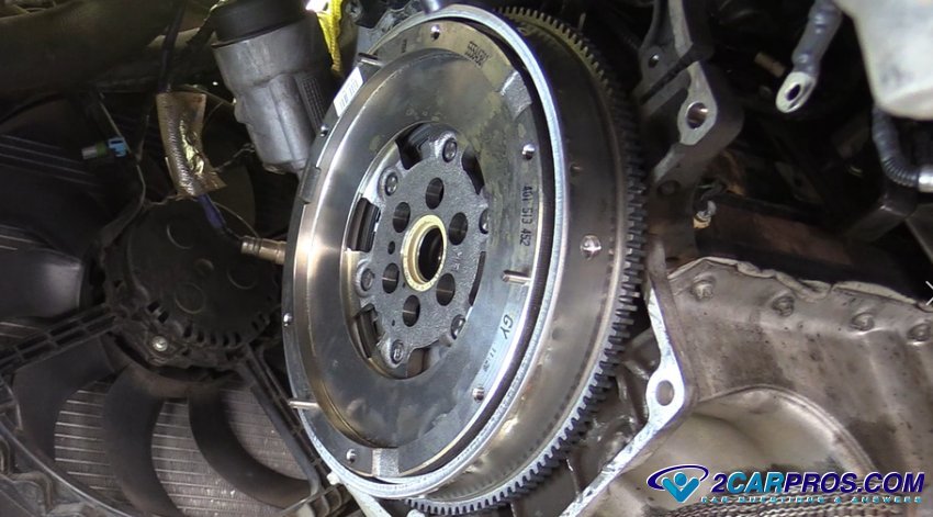

The dual mass flywheel has made shifting transitions more comfortable.
dual mass flywheel
