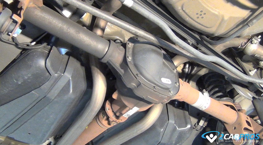

An automotive differential or sometimes called a "rear driver" was designed to allow the drive wheels of a car to work independently of each other and to reduce stress on the drivetrain. A front wheel drive car has a differential as well, as it is incorporated into the transaxle, (a transaxle is a version of FWD transmission). Because a corner is an arch of different lengths, the distances each wheel travels is not the same, without this device one wheel would skid which would cause handling problems.

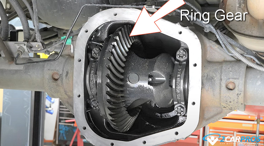

Gears and Raito
Inside the differential is a main set of gears called a "ring and pinion" which are helical cut for smooth operation, and together are responsible for creating the final drive gear ratio which is usually about 3 to 1 (3 three turns of the driveshaft to one rotation of the wheels) and is used to multiply engine torque.

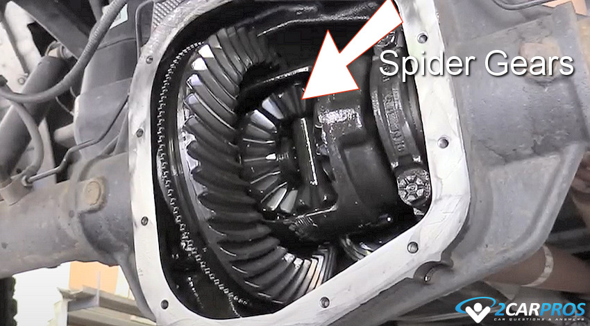

Spider Gears
Spider gears is where the "magic" happens, both the right and left side axles are plugged into a spider gear on each side, and is held in place by a pinion shaft within the differential carrier.

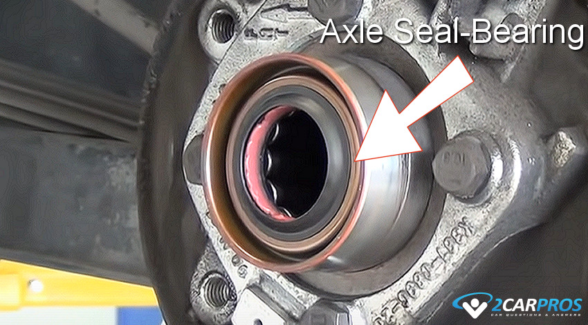

Axle Bearing and Seals
At each end of the differential housing, a axle bearing and seal is used to help support the axle which supports the weight of the car, and a seal to control gear oil from leaking outward and onto the rear brakes.

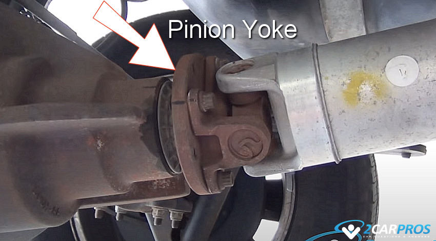

Drive Input
The pinion gear sits at the front of the differential, and is where the driveshaft or final drive of the transmission is connected using a pinion yoke. A crush sleeve is uses to set the bearing pre-load of the pinion gear which is determined by tightening the pinion yoke nut. The pinion yoke can be designed to hold a U joint or CV style of driveshaft end joint.
