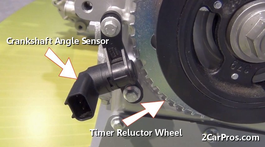

The crankshaft position sensor (CPS) is a critical component in modern automotive engines and is used to reference crankshaft rotation as the engine is running while supplying feedback data to the main engine computer. This sensor is mounted near the crankshaft, flywheel or in the engine block depending on the manufacturers design. As the crankshaft spins it creates an electrical pulse pattern that changes with engine speed. This wavelength controls computer output circuits such as fuel injector pulse width, camshaft and ignition timing adjustments. The reluctor or stator wheel is fastened to the crankshaft which is used by the sensor.

How a Crankshaft Sensor Works
A crankshaft position sensor uses a magnetic coil mounted inside a plastic housing while supplying an electrical connector to transfer data to the computer. The computer also uses this sensor to gather misfire data due to the temporary slowdown of the crankshaft while the misfire occurs. When the starter is engaged the computer uses the crankshaft position sensor to confirm the engine is actually cranking over. Once this confirmation is received the computer will signal various relays such as the fuel pump relay and ignition systems that the engine ready to start. When replacing a crankshaft position sensor you may need to recalibrate or relearn the sensor function using a automotive computer scanner.
