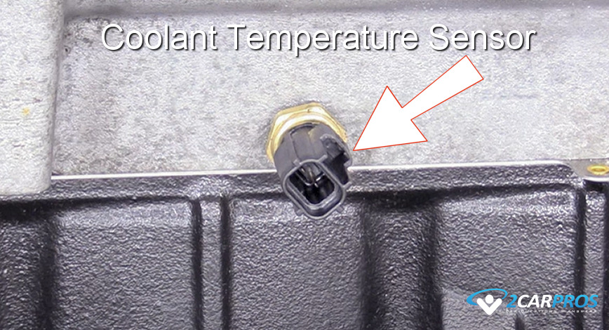

The ECT sensor is a thermistor-based device that changes resistance in response to temperature fluctuations inside the engine. The sensor uses a Negative Temperature Coefficient (NTC) thermistor, meaning its resistance decreases as the temperature increases. Coolant temp senders have two wires, one wire is fed 5 volts voltage from the computer, while the second wire is read by the computer and the engine temperature is determined. A coolant sensor wiring connector is held in place using a safety clip, there is also a weather pack seal that is designed to keep moister from the sensors electrical connectors which will cause corrosion which will alter the sensor's readings.

The coolant sensor's location is designed to monitor the engines coolant temperature where the coolant is the hottest, which is usually at the upper coolant hose outlet, (thermostat housing) or in the cylinder head near the combustion chambers.
