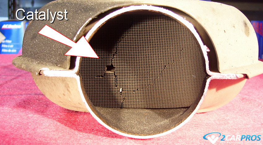

This is what the catalyst material looks like inside the converter, this one is broken which is why it was replaced.
catalyst inside an automotive exhaust system catalytic converter

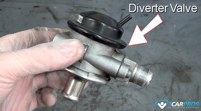

You may have noticed that some vehicles have an air injector system which provides fresh air into the exhaust system, either before or at the catalytic converter. This AIS system is designed with an air pump, control relay, air diverter valve, air check valve and tubing, super heating the catalyst to aid in it's chemical reaction, here is what a diverter valve looks like:
air injection diverter valve

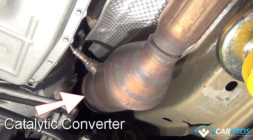

Locations
In the exhaust system the catalytic converter locations will vary depending on manufacturer, some vehicles require multiple converters to help clean the exhaust gases more thoroughly. The general, the idea is the closer the catalytic converter is the engine the better it will work, utilizing the heat from the exhaust gases which is highest at the cylinder head exhaust ports. This is why some cars will have the cat integrated into the exhaust manifold.
