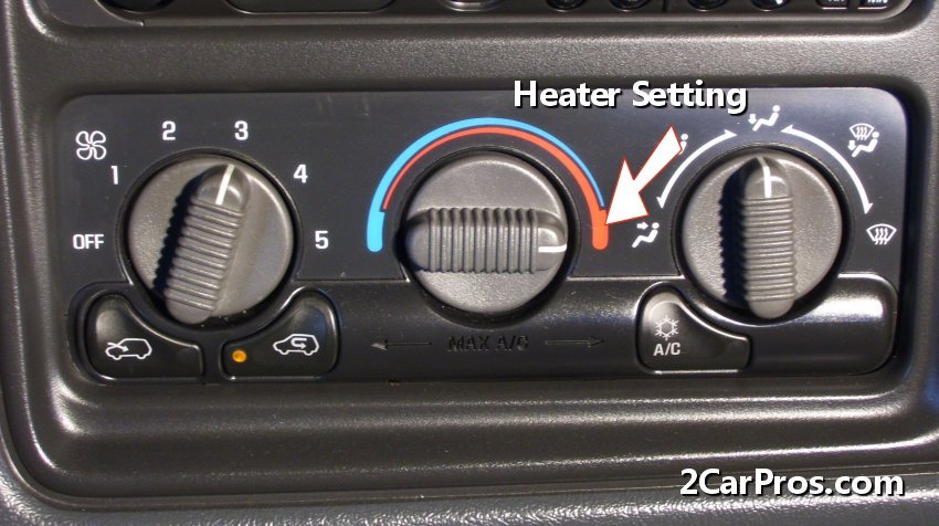

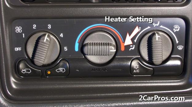

heater setting
 An automotive heater is used to supply warmth to the passengers of the vehicle. Conventionally this has been done using the coolant heated from the engine and then run through the heater core via the heater hoses. For electric motor vehicles this is achieved by heating a set of resistance wires (much like a bread toaster) using the main battery and then allowing a blower fan to push the heated air through the vents. Heater system controls are adjusted by one of two ways, either a manual system is used which is adjusted by the driver or a climate control computer responds to a setting which is then automatically adjusted. Some manufactures have separated the heater system into passenger and drivers side controls which offer independent temperature adjustments. Many aspects of the heater system can malfunction such as an engine coolant leak can develop which hinders the performance of the heater system, these leaks must be repaired before proper heater operation will return.

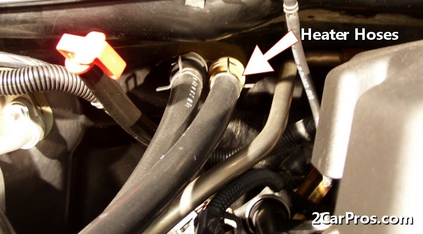

Once the engine has been started and has run long enough to warm up the hot coolant is transferred into the heater core which is located inside the passenger compartment via the heater hoses. Most heater core inlet and outlet hoses can be identified by the diameter sizes of 1/2", 5/8" and 3/4".
heater hoses

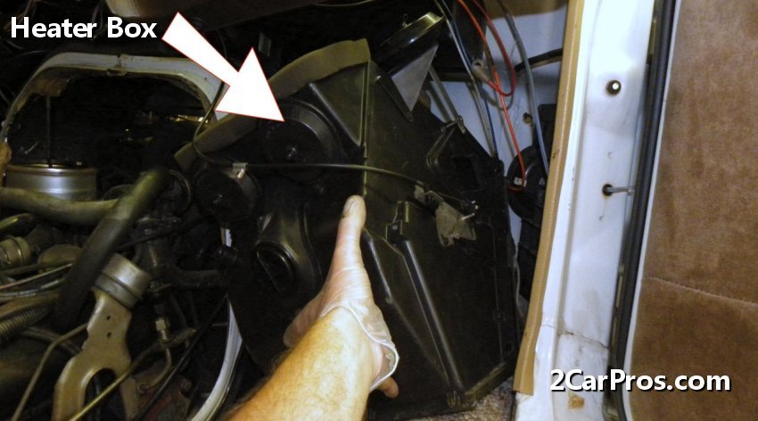

The heater core and air conditioner evaporator are housed in the same unit called a heater box or plenum. This unit is where several air blend doors and ducts are located which divert air to various vents, floor, midway and upper (defrost).
removing heater box plenum

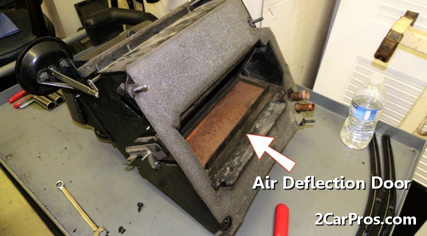

In this illustration the heater box has been removed to show the air flow blend door which swings from one opening to the next mixing or stopping the air flow from one vent system to another.
air deflection door

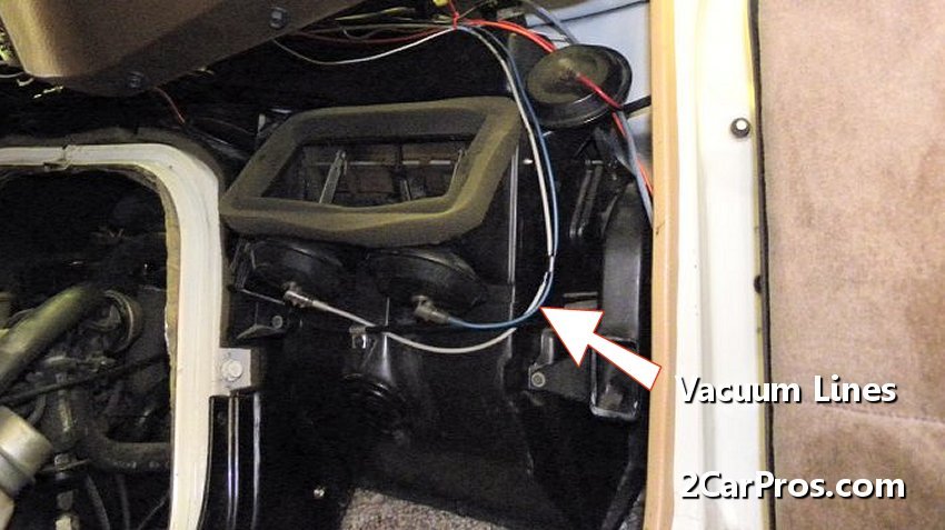

Air control doors are actuated by cable, vacuum or electrical servo motors which can be maneuvered using a manual lever or automatically from the HVAC system controls.
vacuum lines

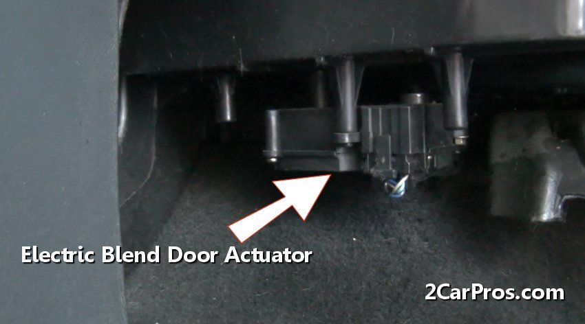

Blend door actuator motors are used to move a specific door which controls air vent outputs such as defrost, mid and floor vents.
electric blend door actuator

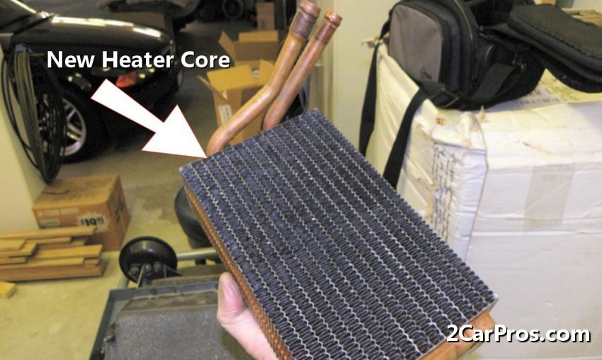

The heater core itself looks much like a small radiator and acts much in the same way by running hot engine coolant into the core and forcing air through it which delivers the heated air. When a heater core fails a coolant residue may be observed upon the passenger side floorboard this will typically be accompanied by a sweet, pungent odor which can come from the vents. Some vehicles utilize a heater control valve which is used to stop the coolant from flowing into the heater core when the heater system is not being used. If an audible bubbling noise is heard from the heater core area (like a fish tank) it's is due to air being trapped inside the heater core, in time the air should dissipate to silence the noise.
heater core

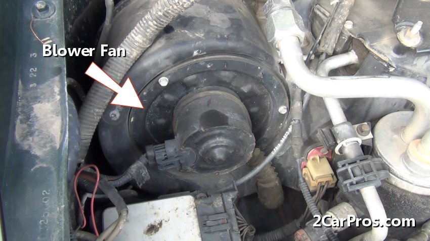

A blower fan motor is used to push air throughout the ventilation system which is controlled by the driver via the temperature control knob or climate control computer.
blower fan motor

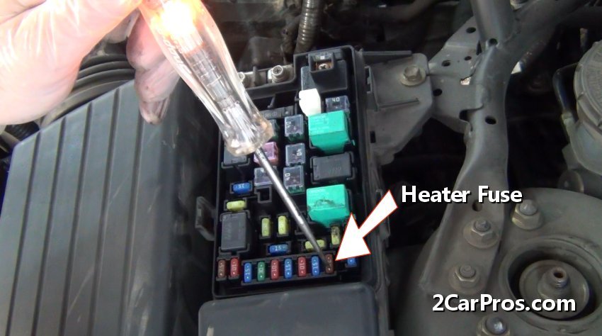

A fuse is used to protect the heater system which is located in the power distribution center and can be checked by using a test light.
heater fuse

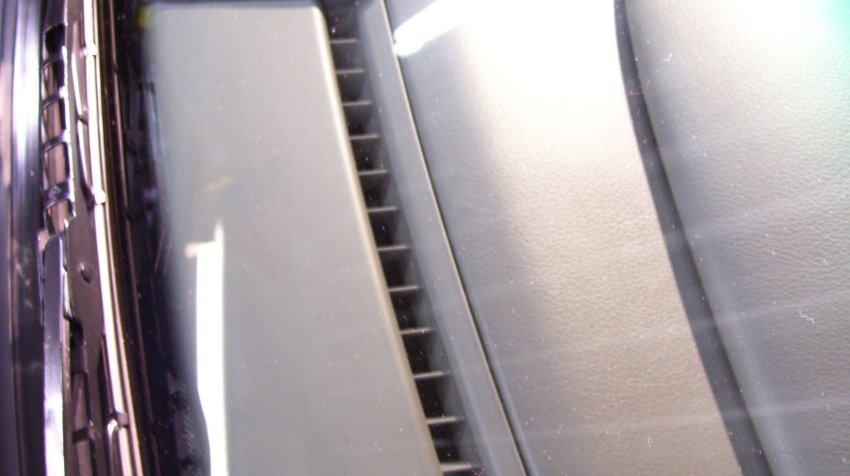

Warm air is pushed through the upper vents which are located at the front of the dashboard near the windshield. These vents are used to remove moisture from the inside of the windshield which helps improve visibility.
defroster vent

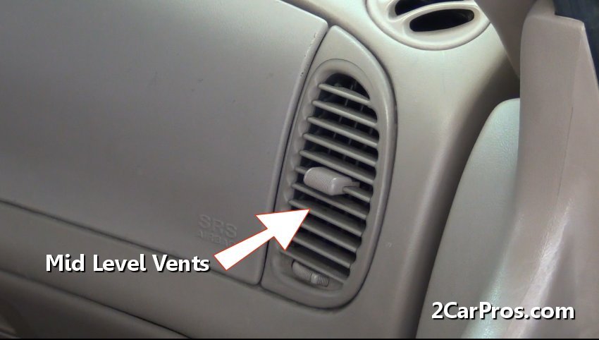

The mid level vents are primarily used for direct passenger comfort and have the ability to control and direct the airflow.
mid level vents

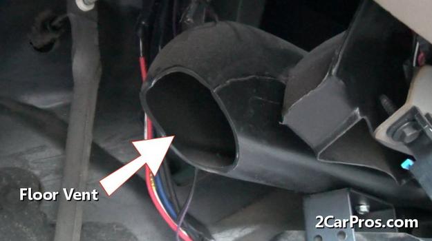

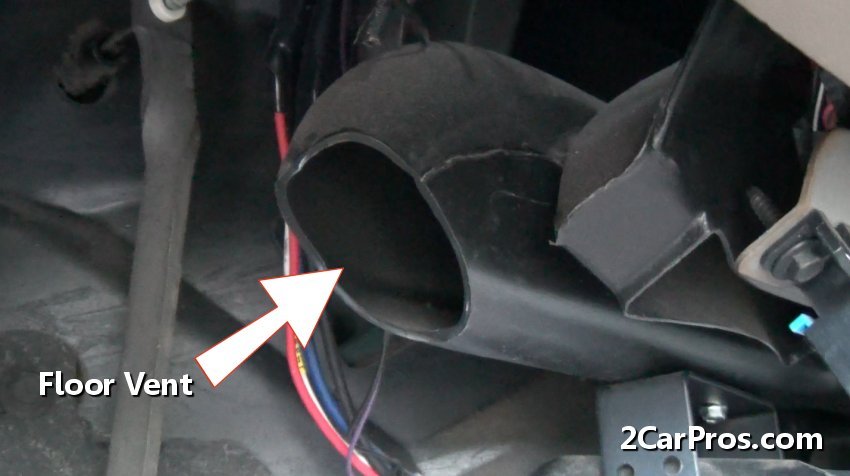

Heater floor vents are located below the dashboard and are used to provide warm air to the lower portion of the passenger compartment.
floor vent
