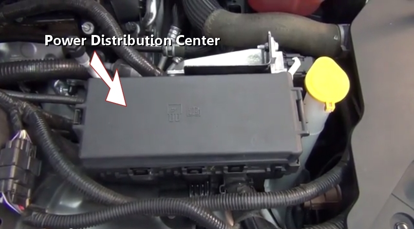

Here is a typical fuse panel located under the hood designed with a cover to help keep moisture out, on newer cars it is called PDC or (power distribution center)

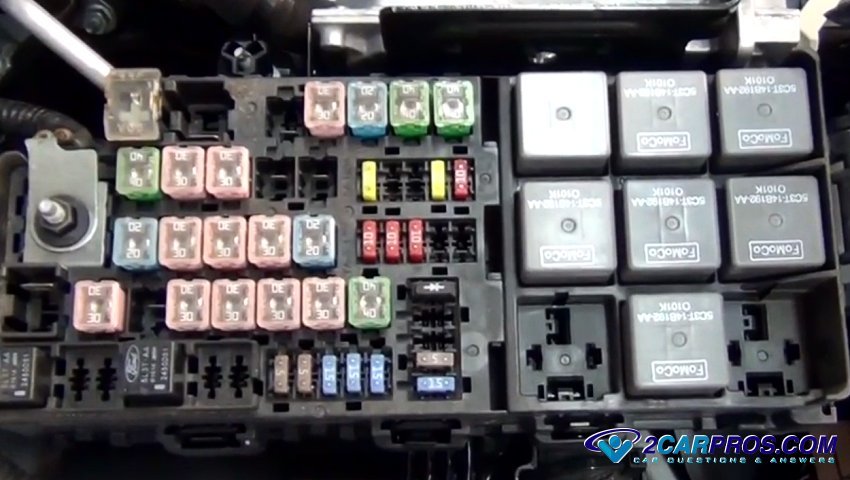

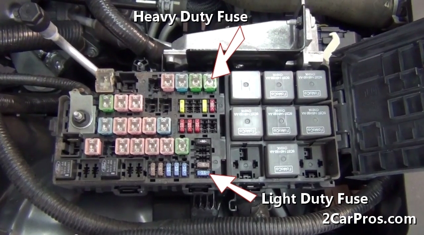

Inside the PDC are many heavy and light duty fuses which protect various circuits which demand a specific amperage.
fuses

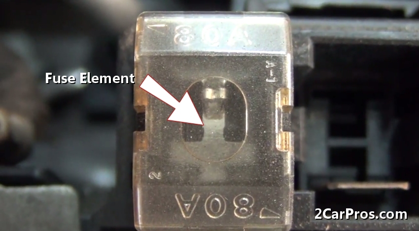

All fuses are designed with an element that will melt if the circuit amperage exceeds the fuse rating which breaks the connection  and protects the circuit.
fuse element

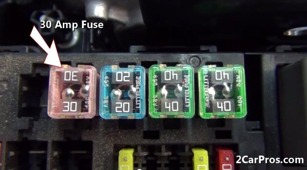

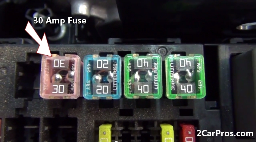

A fuse is typically defined by the amperage rating it's designed to protect, such as this 30 amp fuse.
30 amp fuse

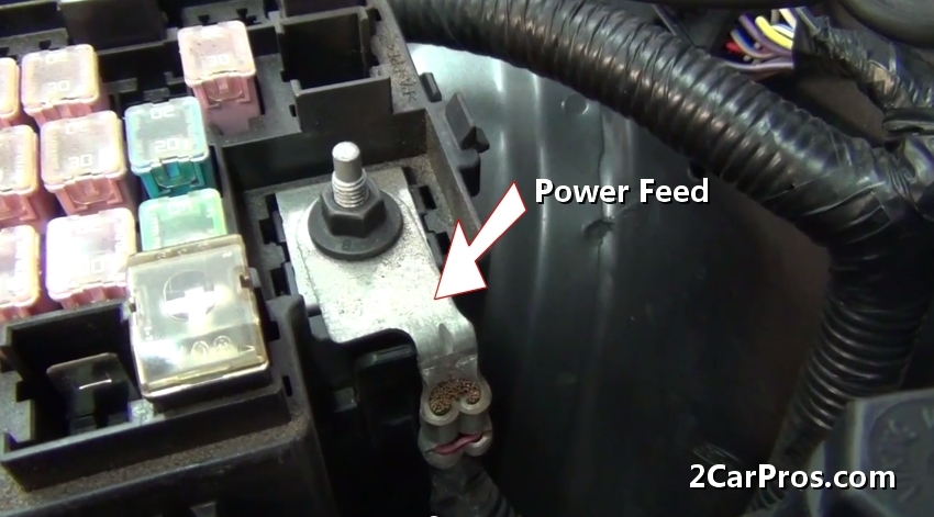

Fuse panel power is supplied by the positive battery cable which is attached to the positive side of the battery.
fuse power feed

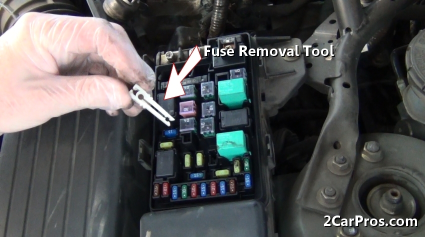

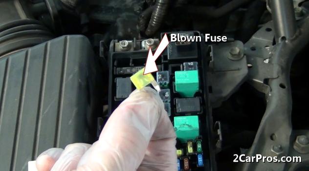

To remove a fuse for inspection a tool is used which is usually supplied inside the PDC. A fuse can tested using a test light as well.
fuse removal tool

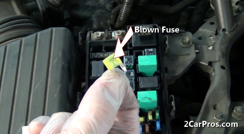

Below is a fuse that has failed which is indicated by the burned element inside the fuse
blown fuse
