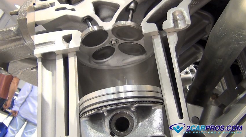

1. Combustion Chamber
In the image below is a combustion chamber (cutaway) and is where the fuel air mixture is compressed and ignited. In the lower center you can see the piston and piston rings as they travel upward and downward inside the cylinder bore. The intake and exhaust valves are in the upper section along with the spark plug electrode which is where the spark is generated for ignition of the flammable air/gas mixture. This is also a good look at the intake and exhaust valves and ports. Many engines have two intake and two exhaust valves to help the engine's performance.
combustion chamber

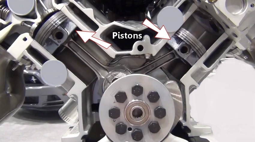

2. Pistons and Cylinder Bore
Here is a cutaway image of a V8 engine that shows how the pistons are attached to the crankshaft which rotates inside of the engine block along with the cylinder heads bolted to the top of the block deck. A straight six, five or four cylinder has just one cylinder head.

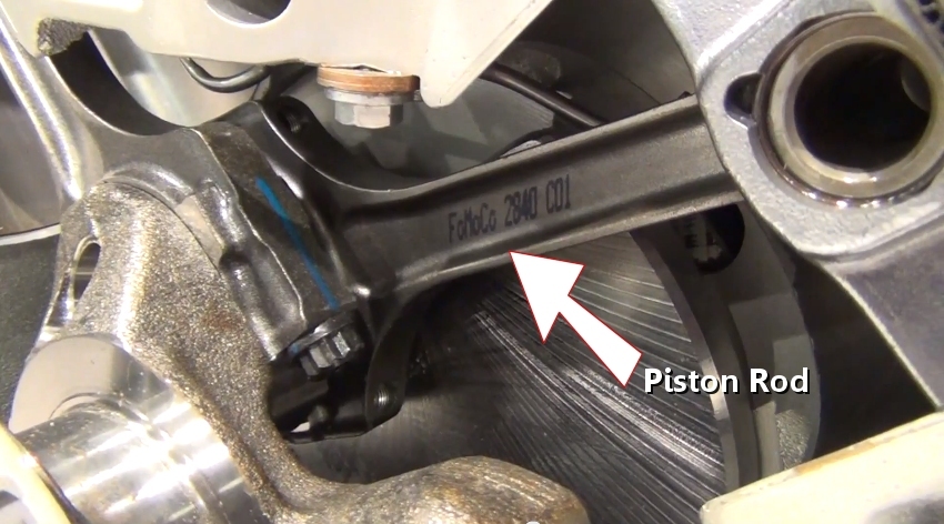

3. Piston Connecting Rods
In this image we show how the piston is attached to the crankshaft using a piston or connecting rod. This rod has a cap located at the bottom of the rod which splits into two pieces so it can be bolted to the crankshaft using two rod bolts. (It is difficult to see the line where the rod cap separates.) This is were the rod bearing is located which allows the crankshaft to turn while being oiled by the oil pump and oiling system.  At the top of the rod there is a wrist pin that is located through the piston and can pivot near the bottom of the piston body.

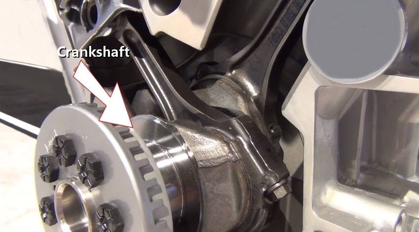

4. Crankshaft
The crankshaft is where all of the pistons and rods are connected too and is the part that is bolted to the flywheel and transmission. All of the power the engine creates is transmitted though the crankshaft which sits in the lower middle of the engine block. It is held in place by the use of main bearing caps that are bolted to the block which house the main crankshaft bearings. These bearings are also lubricated by the engine oil and the oiling system. The front of the crankshaft protrudes outward from the engine to provide power to turn the cars accessories such as the alternator, water pump and air conditioner. The rear of the crankshaft exits the back of the engine to connect to the flywheel and then the transmission to provide power for the car. Oil leaks are controlled by a front main seal and a rear main seal.
crankshaft

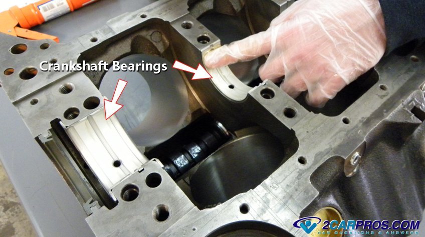

5. Main Bearings and Engine Block
Here are what the engine main crankshaft bearings look like when the crankshaft is removed. In the image below is an example of one half or the bearing. The remaining half is located in the bearing cap which bolts to the engine block. The piston rod bearings look the same except they are a little smaller in size. You can see a hole in the middle of the bearing which is where motor oil is provided for lubrication.

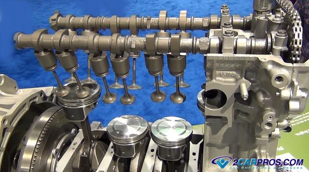

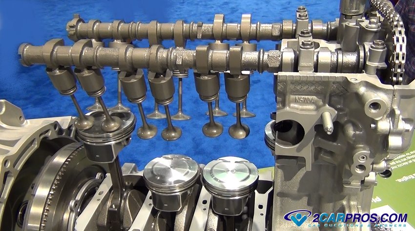

6. Camshaft and Cylinder Head
A camshaft is a long cylindrical metal shaft that is made with very specific lobes that are designed to open and close the intake and exhaust valves which are in time with the piston position. This shaft is located in the cylinder head or engine block depending on the engine's design. This important part of the engine is what controls the intake and exhaust gasses from entering and leaving the combustion chamber during the combustion processes. In this image the cylinder head has been partially removed so you can see how the camshafts work with the valves.
camshaft

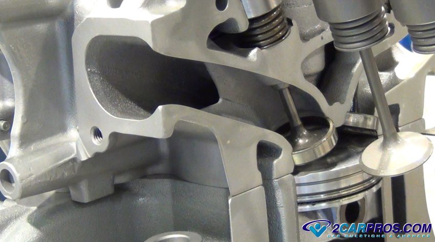

Here is a cutaway of a cylinder head which shows the intake and exhaust ports which are controlled by the valve in each port. These valves seal the combustion chamber so when the piston is travelling upward it can create compression for the combustion process.
cylinder head exhasut port intake valve

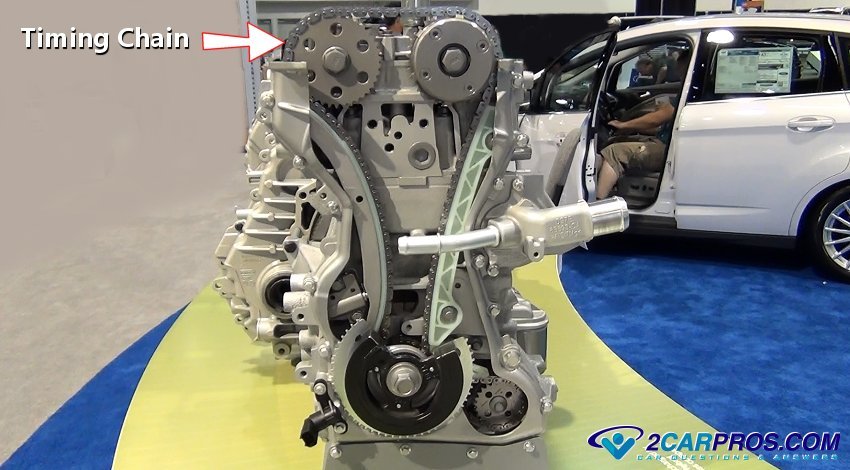

7. Timing Chain or Belt
A timing chain or belt is used to turn the camshafts which open and close the valves. This chain or belt is designed to keep the camshaft in perfect correlation with the crankshaft and turns the camshaft one time for every two times the crankshaft turns. This chain or belt runs from the crankshaft to the camshafts.
engine timing chain

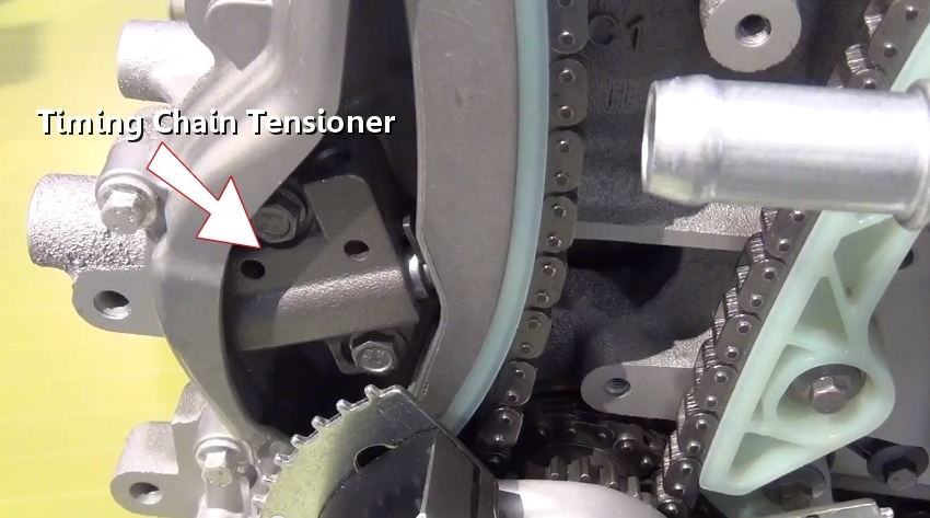

A tensioner is used to keep the slack out of the timing chain or belt which is necessary to hold the chain or belt from jumping time while the engine is running. The timing chain or belt is driven at the crankshaft using a drive gear near the front main seal and harmonic balancer.
timing chain tensioner

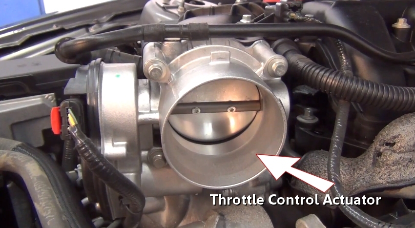

8. Throttle Bore
The engine is basically a large air pump that burns fuel. The process begins at the throttle bore which is connected to the intake manifold. This is where the engine air is regulated. The engine speed and power is controlled by this device which opens to allow more air inside creating additional power and then closes to shut the power down. This air flow is monitored by the mass air flow sensor and cleaned by the air filter.
throttle control actuator

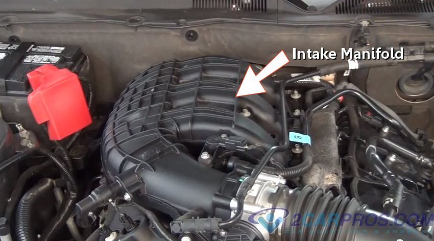

9. Intake Manifold
Once air has passed through the throttle actuator it enters the intake manifold where it is divided and separated among individual cylinder intake ports within the cylinder head. The air is then controlled by the intake valve. This manifold bolts directly onto the cylinder heads and can be made of plastic or aluminum.
intake manifold

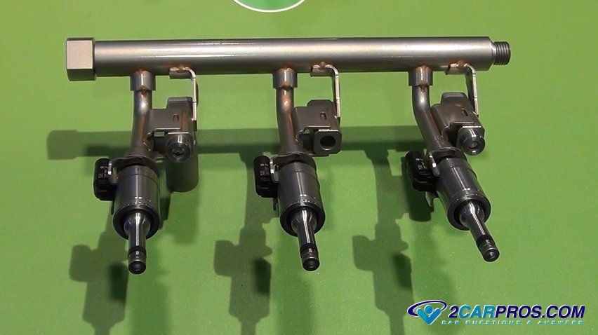

10. Fuel Injector
A fuel injector is used to control and meter the amount of fuel that enters the engine at any given time. While the engine is under load and more power is needed a command for more fuel is given by the car's computer (PCM). The fuel injector is part of the fuel injection system. In the image below there is a set of direct injection fuel injectors which spray fuel directly into the combustion chamber near the time of ignition unlike the traditional fuel injectors which spray into the intake port just behind the intake valve.
fuel injectors

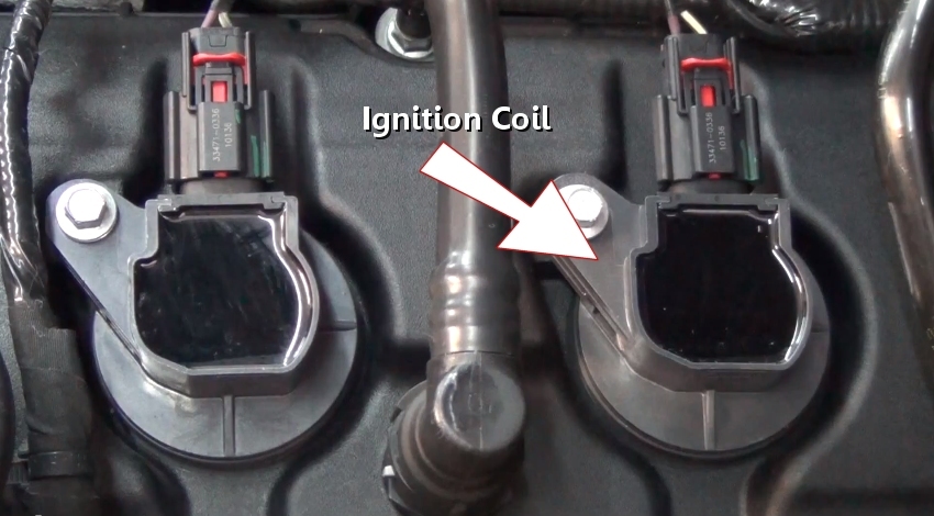

11. Ignition Coil
After the fuel air mixture is compressed an ignition coil supplies a high voltage, low amperage charge to the spark plug. This process is also controlled by the cars computer which gains reference to each pistons position using a crankshaft angle sensor.

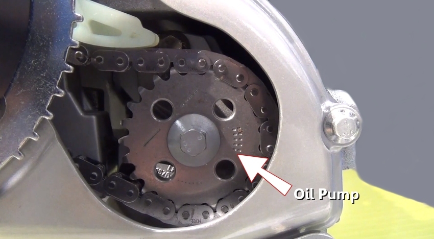

12. Oil Pump
An oil pump is used to pick up oil from the oil pan and pump it throughout the engines internal moving parts. This pump can be driven by a variety of ways, this particular pump is driven by a chain at the front of the crankshaft. The oil pump determines the amount of oil pressure the engine will have using a pressure spring fitted into a relief valve of the pump.
oil pump

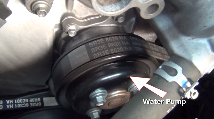

Engine coolant is used to help keep the engine cool while running by using the cooling system. This coolant is circulated inside the engine block and cylinder heads to keep the engine's heat from causing internal damage. A water pump is used to move the coolant into the radiator to be cooled and then transferred back into the engine so the process can start over again.
water pump
