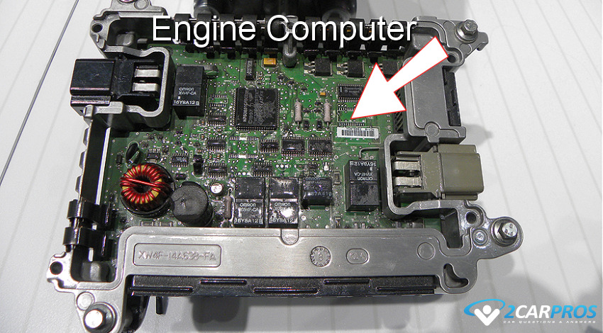

The automotive engine computer, also known as the ECU, PCM or ECM (Engine control unit, Powertrain control module, Engine control module), is central to a vehicle’s performance, efficiency, and emissions control. This guide will provide an in-depth, step-by-step explanation of how an engine computer works, covering sensors, processing, outputs, and control strategies.
Overview of the Engine Computer
An automotive engine computer is programmed to process feedback data from various sensors and deliver electrical commands to various engine and transmission systems, think of this computer as a dedicated platform much like a Play Station or X box, designed for controlling key functions.
