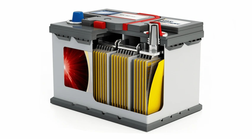

  • Case: Made from polypropylene plastic, this case contains the internal components and provides protection.
  • Plates: Composed of lead and lead oxide, these create electricity within the battery.
  • Electrolyte: A mixture of sulfuric acid and water, this solution facilitates the flow of electrons by conducting ions.
  • Separators: Insulating material between plates, preventing internal short circuits.
  • Terminals: Connects the battery plates and to the vehicle’s positive and negative battery cables.
A car battery is a rechargeable unit in the SLI (starting-lighting-ignition) variety which is lead acid based and is the oldest style of rechargeable electrical supplies. 12 Volt batteries are divided into 6 separate cells, each cell producing about 2.1 volts and when combined create up to 12.6 volts. When a battery powers a device, a chemical reaction occurs between the sulfuric acid in the electrolyte and the lead plates. This reaction forms lead sulfate and releases electrons, generating an electric current. As the state of charge decreases the voltage and amperage it produces also decreases.
automotive 12 volt battery cross section

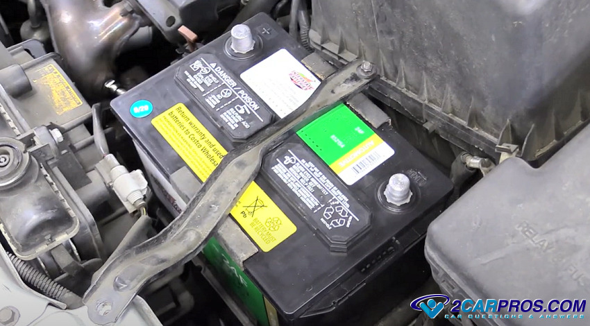

Never allow to a battery to "be loose" and not to be mounted securely (battery hold down), because it can be jostled around while breaking internal plates and connections causing a battery failure. Car's have been know to "cut out" and lose all electrical power while driving.
