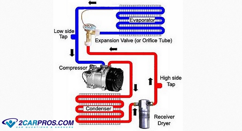

Here is an image of the closed system for visual clarification:
air conditioner system diagram

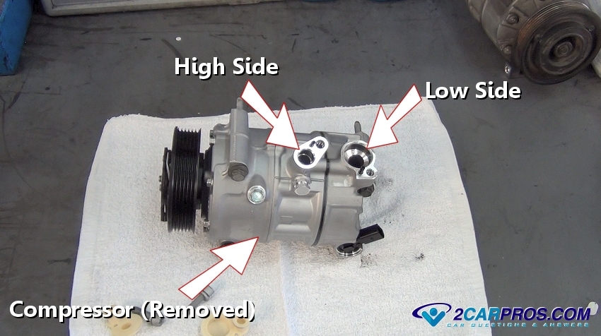

1. Compressor: This is what a typical compressor looks like, it features the high and low side ports, a clutch, which is activates the compressor when 12 volts is sent turning the system on, and a belt pulley which freewheels when the system is not in use. The compressor is the main mechanical part of the system with internal workings that must be lubricated by PAG oil (synthetic).
air conditioner compressor removed

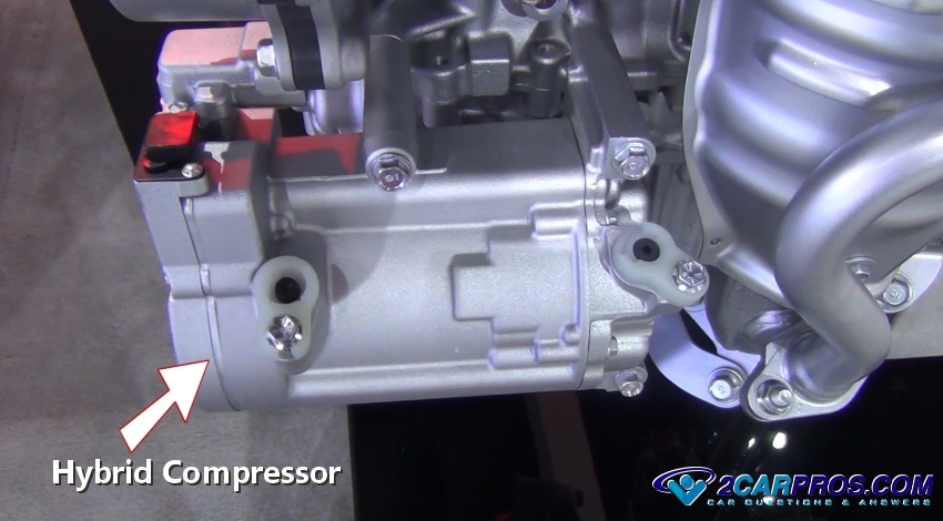

On hybrid engines or electric vehicles the compressor is electrically powered by the vehicle's battery pack. A small electric motor is fitted inside of the compressor which pressurizes the refrigerant. These compressors have a pair of large gauge wires from the compressor controller.
hybrid electric car air conditioner compressor

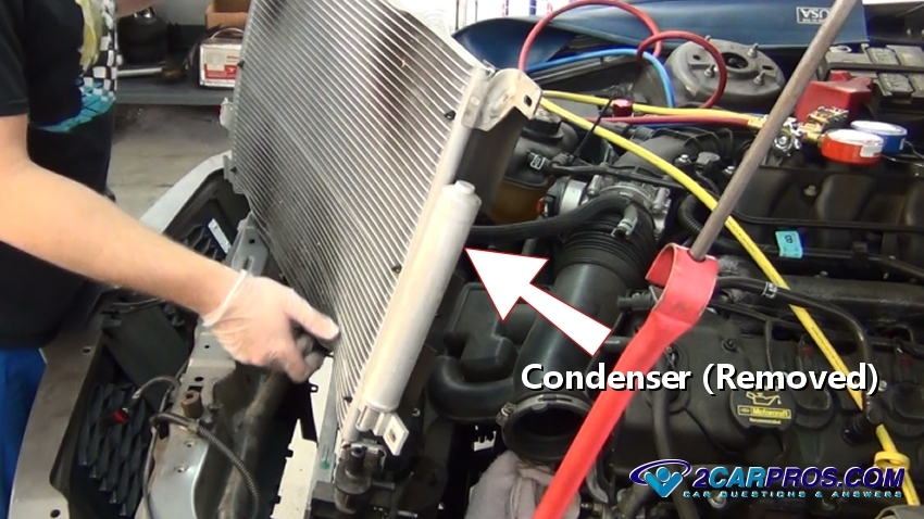

2. Condenser: Located in front of the engine radiator, it cools the refrigerant from the compressor by using engine cooling fan before it heads into the evaporator. Some condensers are designed with a receiver dryer attached which acts as a refrigerant cleaner and moisture remover, this helps the system last longer. Some systems will have an accumulator that does the same job but is located closer to the evaporator.
ac condenser removed

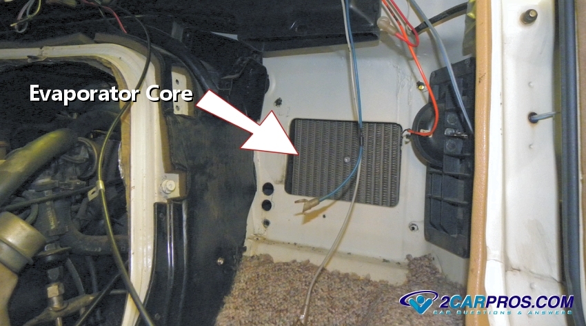

3. Evaporator: Located inside the HVAC plenum and is where the high pressure refrigerant is released to create the cold air. The blower motor forces air through the core and out through the air vents.
evaporator core

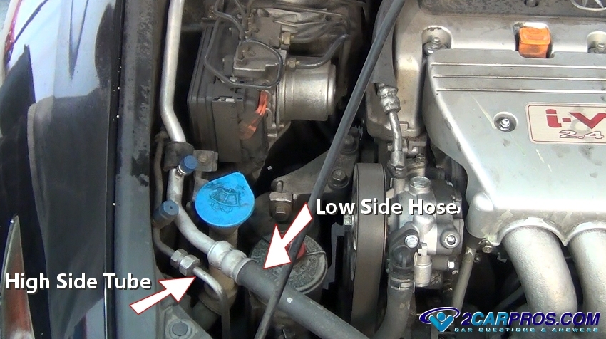

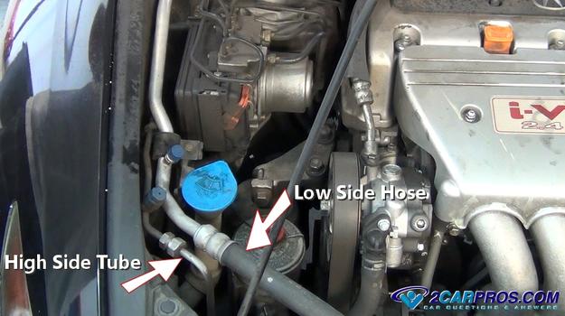

4. Hose or Tubes: Used to transfer the refrigerant from and to various components.
high side and low sideair conditioner hose and tube

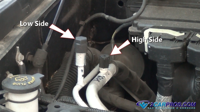

5. Service Ports: High and low side service ports are used to add Freon and vacuum down and recharge and the system. These ports are usually located on each hose but can be on the compressor or accumulator as well.
high side low side ac charge ports
